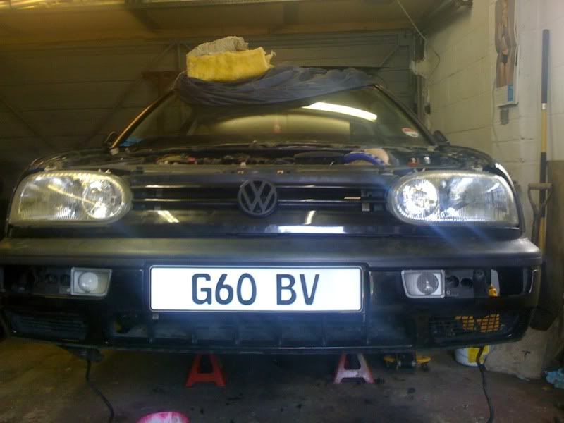

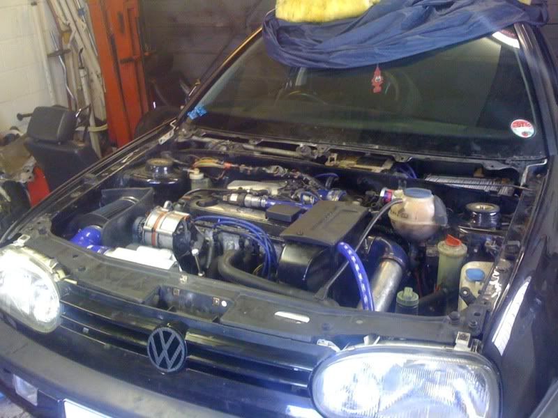

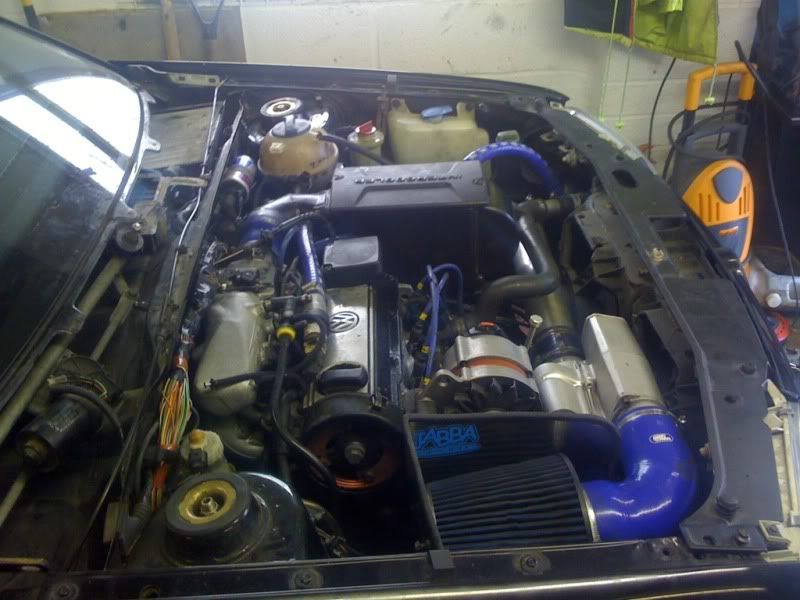

another quick update, test fitted everything today to make sure the bumpers, all thats left to do is litttle bit of wirning moun the oil cooler and sort the clutch out, heres a few shots

No not a easy job mate, even more so with robs charge cooler setup, we had to put the battery in the boot to make room for the cooler
Also had to make a custom wiring loom half G60 have golf
Change from rod to cable gear change
Change from cable clutch to hydro clutch
Mix and match engine mounts from both
Flip the rad upside down as the water pipes are on the wrong side
Plus loads of little bits of custom stuff

as said finding a good G60 engine is not easy,  as for the conversion i have lost alot of hair, in no way is it easy, loom were a b!tch, going from a hydraulic clutch from cable took abit of playing with and making the cable gear linkage fit of the corrado fit the golf and getting the chargecooler rad to fit was hard, same with the oil cooler and last was my boost pipe wont fit with the battery in so thats now in the boot
