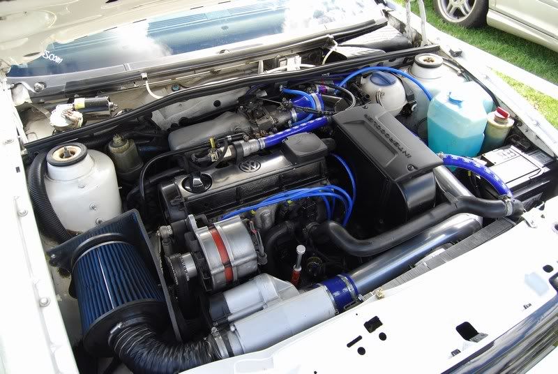

it was last RR at 262
 G-WERKS engine. 1.9 ( 83mm pistons) fully balance bottom end, vr6 clutch, lightened g60 flywheel. Cnc ported head. G-werks spec Newman cam, piper adjustable cam pulley. Grey motor sport injectors. G-werks 4 branch manifold and custom exhaust 2.5” bore. 2 boxes. Ported inlet manifold, custom focus rs charge cooler 3” boost pipes. Gt4 pre rad, Erl Aquamist water injection and a gallon tank in boot. G-werks front engine mount. Diesel gear box mount, vibratech rear engine mount. Custom road mapped chip, 65mm tooth belt pulley, St4 charger

Now that is sweet  :cool: Is it still running on mk2 management and wiring or is it a stand alone setup?

stand alone mate
