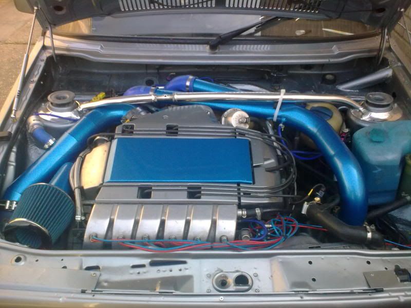

Lowering compression is a must, the install will be very tight but very do-able. The inlet manifold can stay, the air box will need moving to the otherside of the bay for the provisions of the FMIC pipework,
summat like this  :cool:

I will be moving my expansion tank to the airbox side and vice versa, and I wont be using blue pipework ha ha

:undecided: looking at that picture, the things on the front of the inlet manifold what are they, guessing extra injectors?

Not too sure myself tbh  :undecided:
