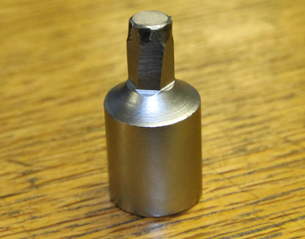

Hellfrauds retards had lost the key to the tool cabinet... had to buy the bog standard tool... Thought I felt the bolt loosening, but... evidently not  :grin:
Fail.
