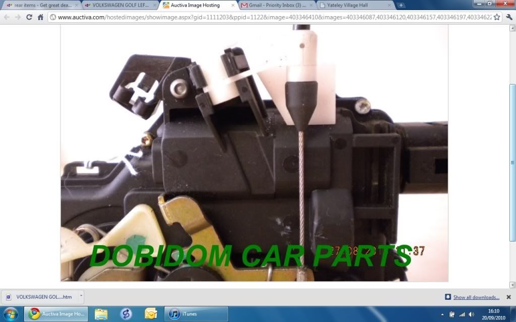

These were a couple of pictures that I found on ebay yesterday. I thought they might help me identify the problem:-
Offline richandhazel
  • Posts: 4,462
Re: Unable to open N/S rear door
« Reply #8 on: 21 September 2010, 13:22 »
I reckon that white plastic piece is bulking it and preventing it from unlocking but there is no way to get at it in situ :cry:
« Reply #9 on: 21 September 2010, 13:23 »
in the first picture, the lever on the left (the one with the white plastic attached which usually has the locking pin connected) needs to rotate clockwise to unlock
