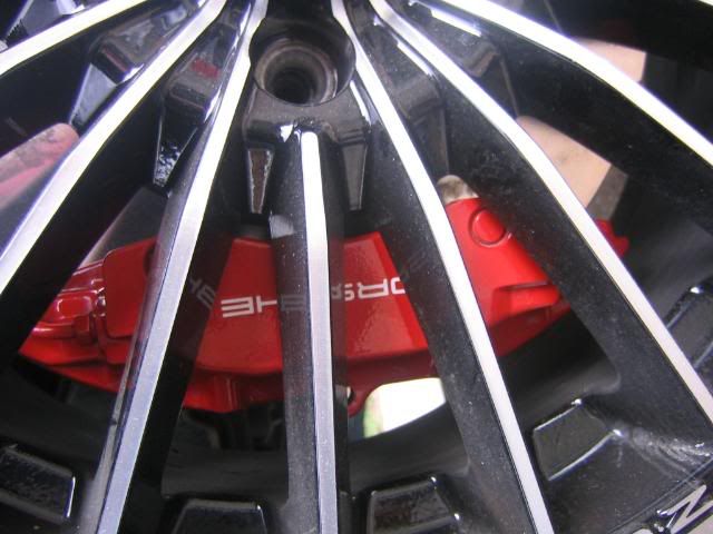

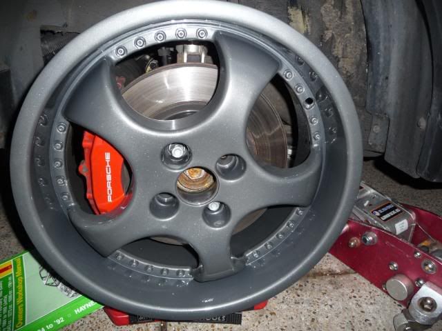

i think the boss has realised the cost of new rear calipers for his pansy boxster S, so there goes my brake upgrade  :angry:
clipperjay what diameter discs are those? over 300mm? apparently you can use these calipers on a 280mm setup (which i have). point being i might get away with a smaller wheel...?  :huh:

Seat cupra turbo 304mm
I would be careful about smaller calipers from a standard boxster the mounting holes might be smaller for the RS2 carriers as long as they are match for your mount holes (Carrier bolt center holes end to end 13cm) they would be fine, but like I said I had a set of black ones and they didn't fit had to be Boxster S's rears
Seat, that’s a 12" or 28mm thickness-304 mm diameter 4 X 100 Seat Ibiza Cupra R 1,8 turbo on old platform ('00-'02  )  Seat Ibiza Cupra R
Discs 6KL 615 301 £52.48 ea
Pads 6KL 698 151 £60.17
These are Boxster’s rear part numbers for Callipers’.
996 352 421
996 352 422 are good
