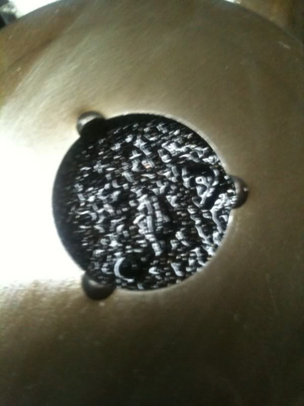

2.0TFSI Oil Pick up pipe blocked = Low oil pressure warning
I thought I broke a 78k 2.0TFSI.... :embarassed:  I was happy custom mapping it from stock to stage2 power when the engine decided to cut out and give me a low oil pressure warning. :angry:  Panic set on for a few mins, only until I called the customer to ask him if it happend before, I was shocked  :shocked: when he said yes, just turn the ignotion on and off and it will be fine.. :lipsrsealed:
So if you have a 2.0TFSI get your oil pick up pipes checked out, it looks like they are going to be worse than the 1.8Ts in the long run.  IMO if you have 80k+ and for what it costs get it replaced.

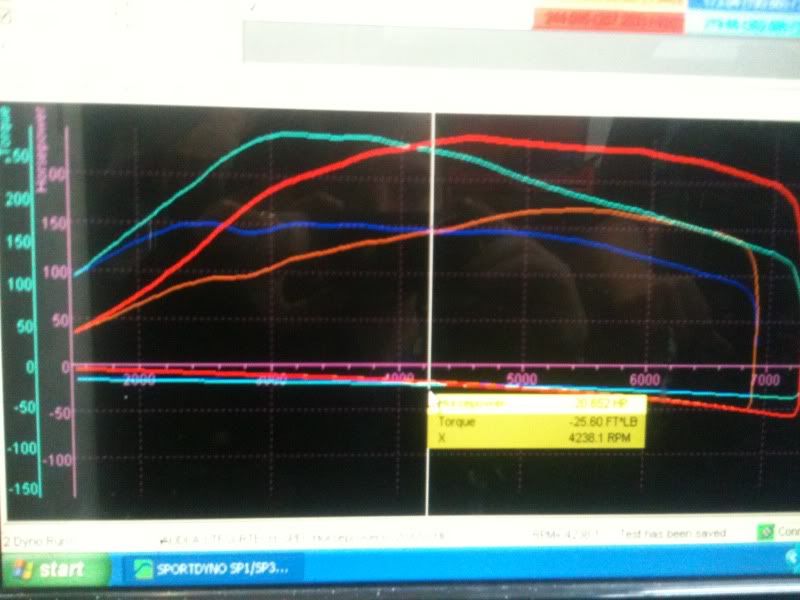

Power run 350bhp with blocked cats, Its booked in for full turbo back exhaust system. :wink:
Audi A3 2.0TFSI Q turbo back exhaust system and R-Tech custom stage 2 remap.

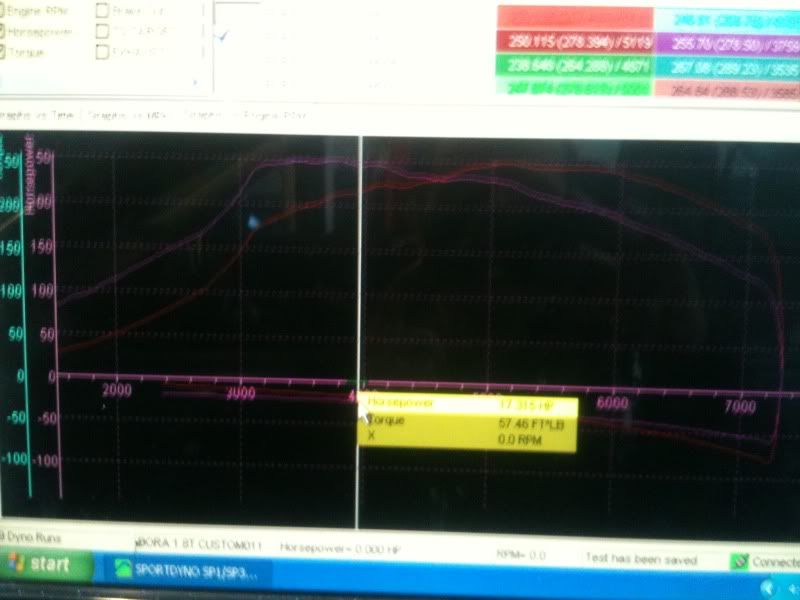

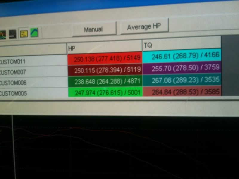

Now we have Yohans car meeting the requested lambda at the top end and the injection on times are much lower which stopped the -12cf ignition pull, we started to do the bulk of the map tuning this after noon.... how bloody easy it was with all the hardware running as it should. :laugh:
There is a little more left to have on the top end power as the boost contol is only around 89-90%, but I am happy with the output we managed this afternoon, I am 110% sure if we put the car on the dyno from cold tomorrrow morning it will easy be 280+ as it was making 277bhp with heat soak after 11 runs.. :smug:

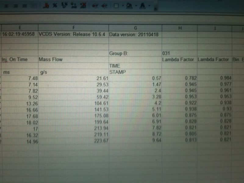

and before the  the comments come again saying its BS, here are the actaul logs, one of around 108 logs we have carried out on this Bora.
On a brand new maf the  / .8 rule works 100%   :wink:  We did another log after this and descreened the maf and made 233gs, but Jim forgot to start the dyno logger..lol

Awesome, awesome, awesome! 233g/s!! Fook me..I make that to be 291bhp..that would be awesome! Is that with the Badger5 TIP or the prototype? Will be interesting to compare.
What are your thoughts on the eBay FMIC core Nick, is heat soak after 11 runs fairly typical? Something that water injection would help I'm sure  :wink:

Doing the tip now on Yohans Bora, results on the same mapping back to back are the sfs hose spools the turbo faster and managed to make 4bhp & 16lbft more power with the peak torque and power around 200rpm sooner. :wink:
