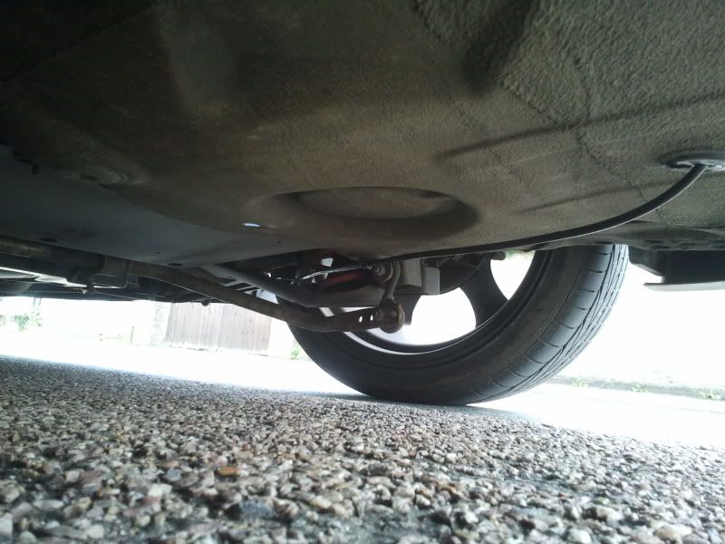

Had a bit of time to play about today so I decided to sort my pipe route at the back end for the WMI as I wasn't 100% happy with it
Result is I managed to lose about a foot of pipe and it's a bit more direct now
Underneath
