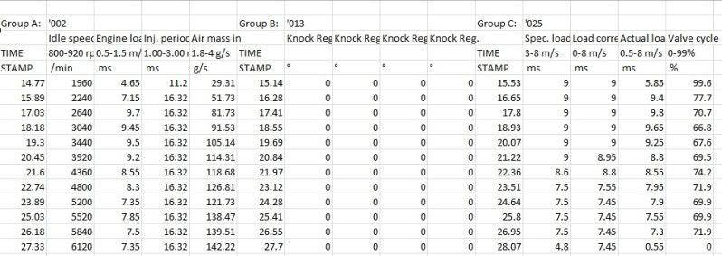

Leon Cupra R pump, and yeah 3bar FPR. Just done a run without meth, surprising how it affects the N75 duty...
Will pop it up in a sec
Offline Wazzzer
  • Moderator
  • Posts: 11,170
  • Golf GTI 1.8T AGU
Re: Wazzzer's 1.8T... post dyno day blues...
« Reply #468 on: 03 February 2013, 19:25 »
With WMI
without WMI
