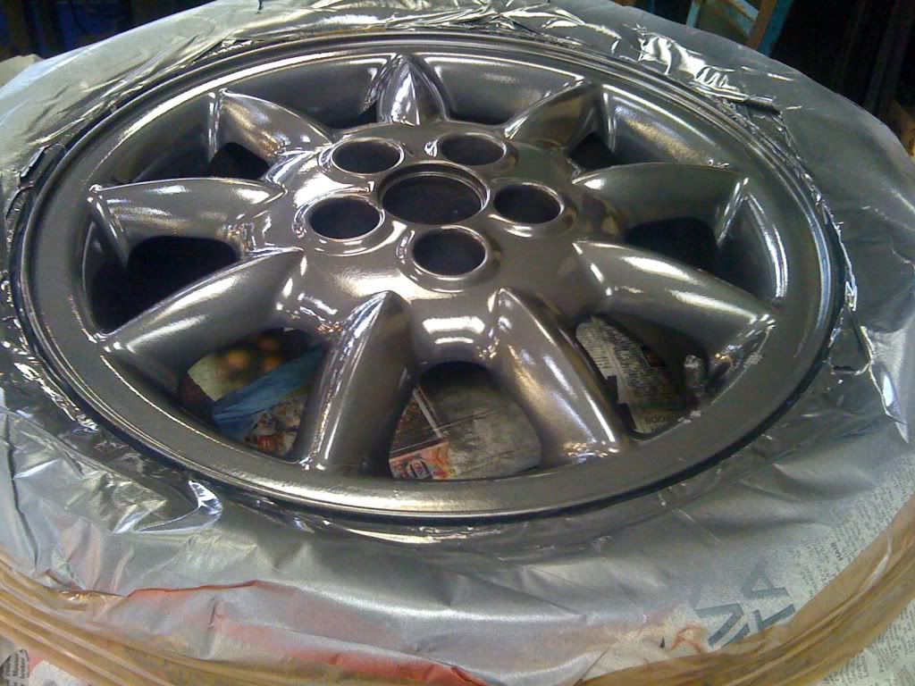

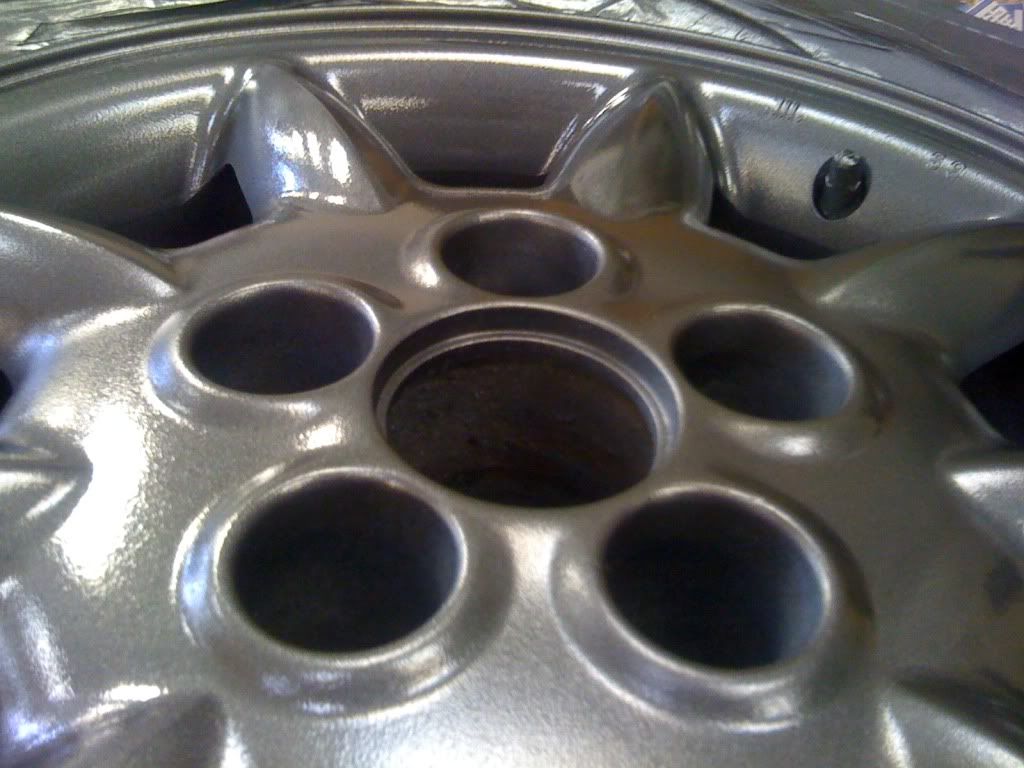

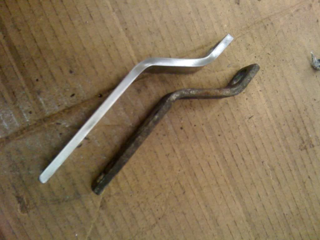

Just finished making my wheel spacers, done two of my spare wheels in Ford Graphite Grey (Awesome colour for wheels), fitted a lil' short shifter thingy and a new bush for my linkage!!!

love the wheel colour.. what colour is your car?

My cars Flash red, cant wait to get em on next week, completely standard at the mo and I'm lowering it next week too so should look baaaad!!!!!!!! (Hopefully)

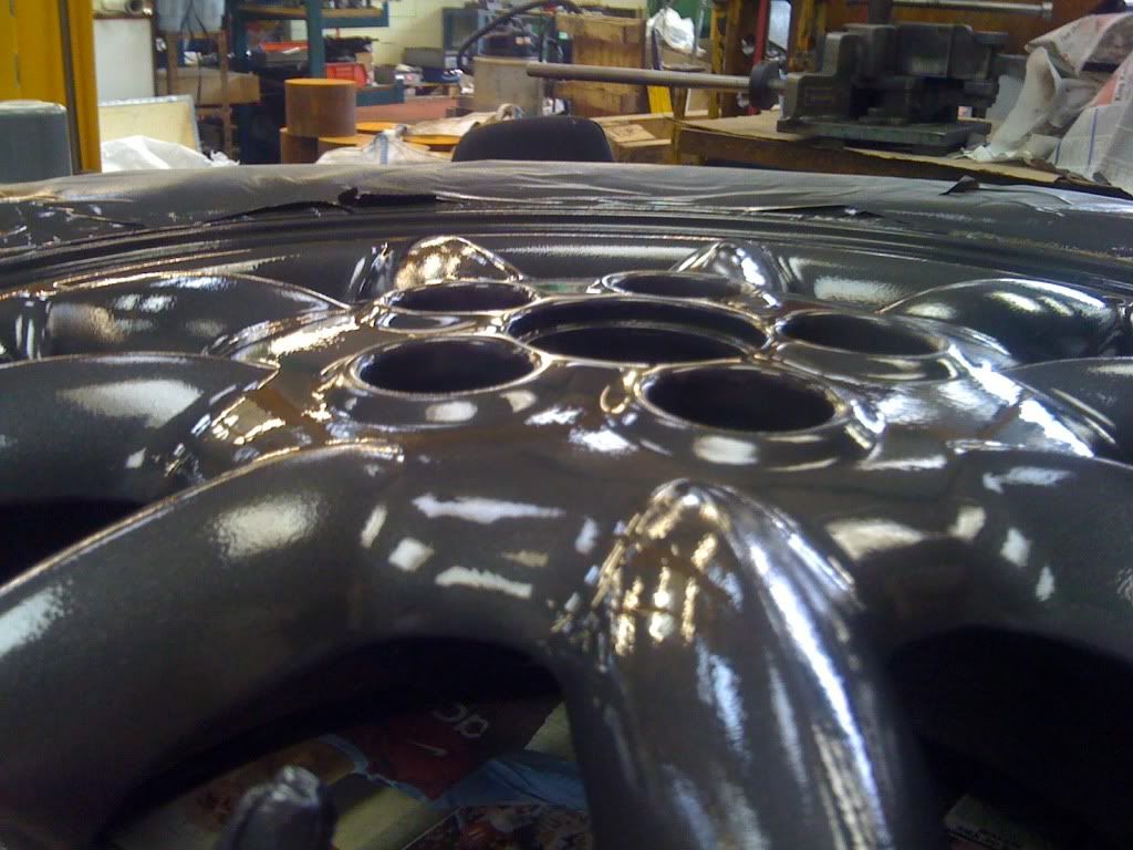

A better pic of the wheel
