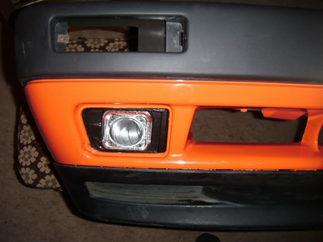

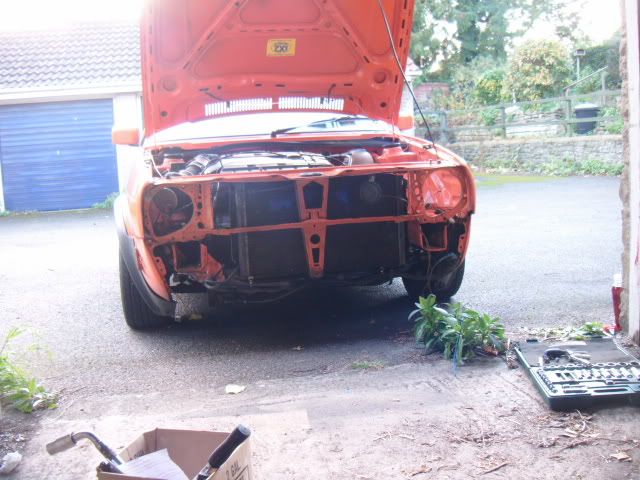

Today i got busy making a custom cold air feed using the shell of a fog lamp, as neither of the fogs are wired in anyway.

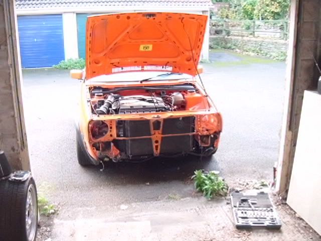

Bumper off car:

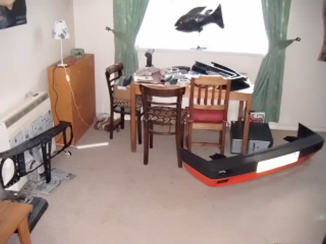

The messy dining room (im in so much trouble)
The fog lamp:
Taking the projector out of the front casing:
Prised the tabs off to remove the projector lens:
Scraped the sealant off the projector back, to prise open tabs retaining the lens holder in place:
Cut the back off the projector shell:
Trial fit of 50mm cold air feed. Will extend to around double this length. It didnt hold with a jubilee clip as the projector shell is tapered, so superglue came into play:
Smashed the glass off the fog lamp front to reveal inner shell:
Painted projector shell and fog lamp front:
Clipped back together:
Installed:
^ finally got the chin spoiler back on, but the stupid pattern bumper is slightly too slim on the corners, as the spoiler wont clip in all the way  :angry: nothing a bead of black sealant wont fix!  :lipsrsealed:

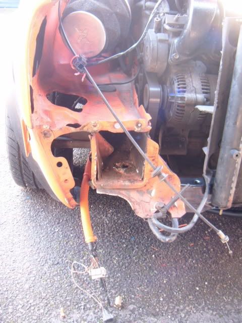

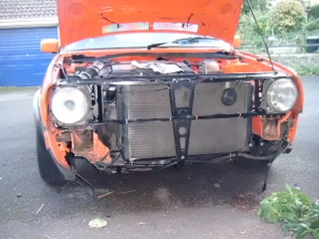

got cracking today and refitted the new front end including new bumper, salvaged (rust treated and painted) front panel and new 4 lamp grill:

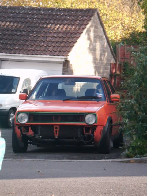

green stripe grill and headlamps off:
old slam panel off:

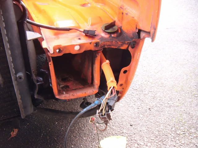

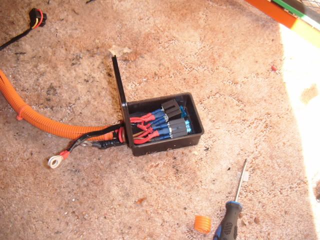

tidied the wiring looms up. they come out of the chassis legs (around 6" back) and needed protecting, so got busy with the orange conduit again:

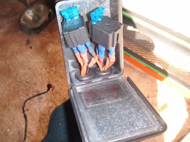

put the upgraded headlamp loom relays inside their new home:

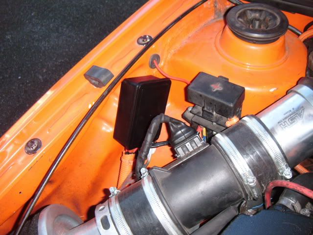

stuck it onto the inner wing (as in hindsight i made the +ve and earth wires a bit short, so nowhere else to put it)

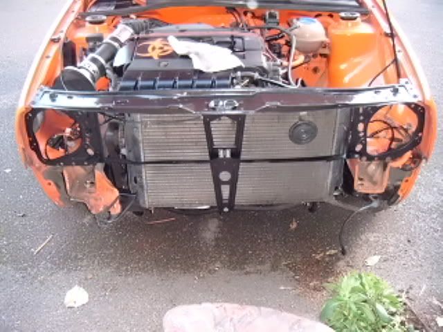

new slam panel on:
headlights on:

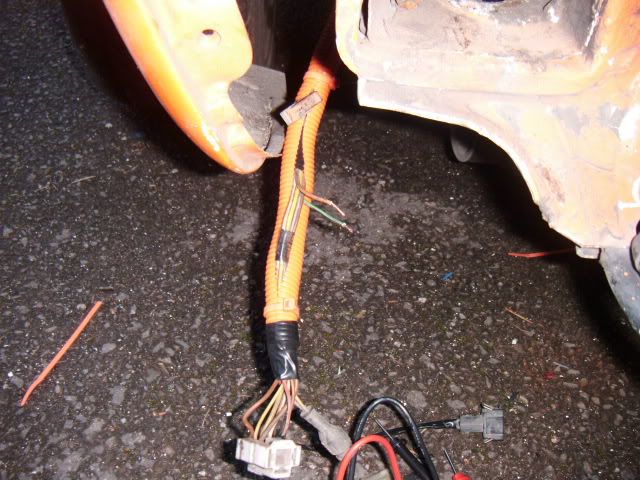

then i realised, whilst tidying the wiring looms, i'd chopped off and concealed the o/s/f indicator wiring! i thought it was the fog light wiring. so i had to dig it out of the conduit and make another connector:
after a bit of swearing (and now a bad back) its all back together, c/w the fog light CAI:
