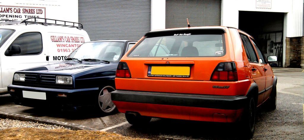

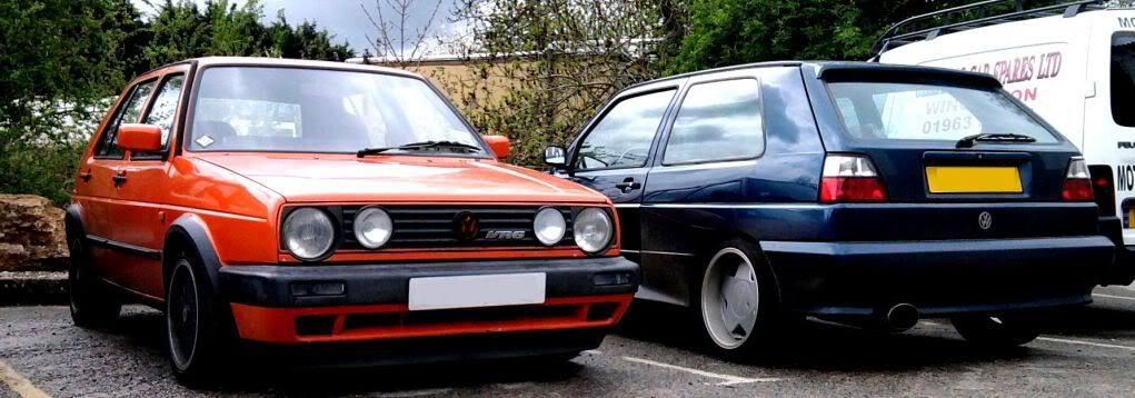

I think i nice picture of the car on the road would do nicely after all the negatives!  :laugh:
I still havent cleaned the old girl, as ive spent some time actually driving her, but I hope these piccies will do:
my mk2 VR6 and a customers rallye... the charger sounds evil!
and the borbets are 9" on the rear  :cool: i want!
I think i can safely say that will do! :cool: love the colour as well! get it cleaned up and it will look so good!
