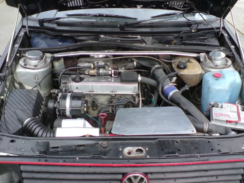

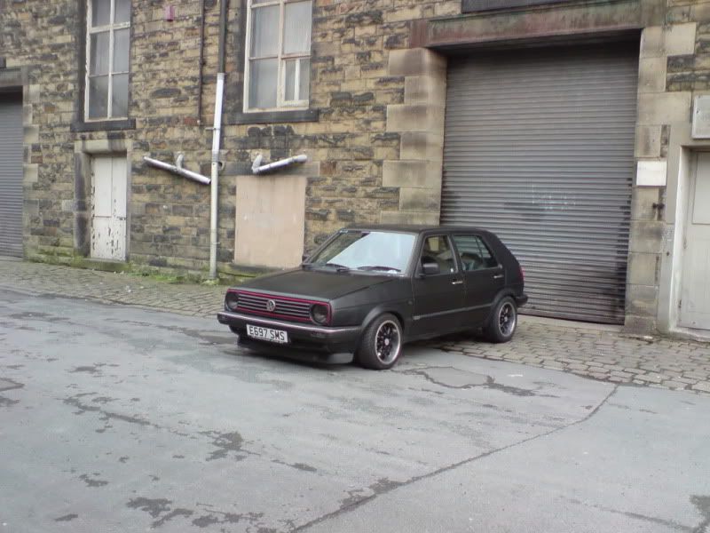

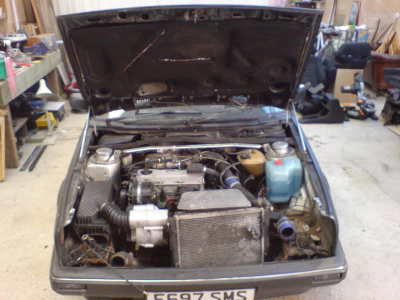

Right, little bit of background. Bought the car in November 2008;
1988 mk2 8v gti
Corrado G60 engine conversion
   -97k miles
   -rsr outlet
   -sprinter intercooler
   -standard rebuilt charger by G-werks (done 1000 miles - receipt for £600)
   -68mm pulley and appropriate chip
   -cylinder head overhauled
   -new belts
mk3 driver gearbox (retaining rod change setup)
280mm front brakes
22mm master cylinder upgrade
40 mm dropped front
Corrado interior
resprayed in matt black (rattlecan job)
All red rears (quality job done with lamin-x)
Smoked headlights (lamin-x)

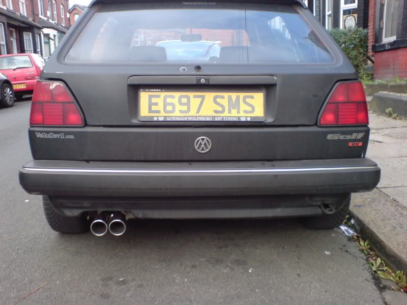

Couple of pics from the advert;

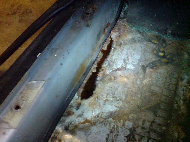

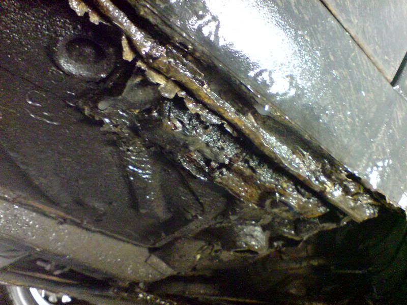

Went to view it one evening, but first thing I did was look underneath and unfortunately it wasn't a pretty sight :undecided: Sills both needed attention and the floor at the front both sides. Told the seller there and then that I couldn't buy it as I didn't have the time to weld it up. However, he insisted that we take it for a run, so I agreed as I had only been in one G60 before. Anyway, got back and loved it so had a good look around the car, offered a silly amount (without his wheels as I didn't like them) that I was sure he would say no to, and sure enough he did. Set off home and about half way back I got a phone call off him saying he would accept my offer :cool:

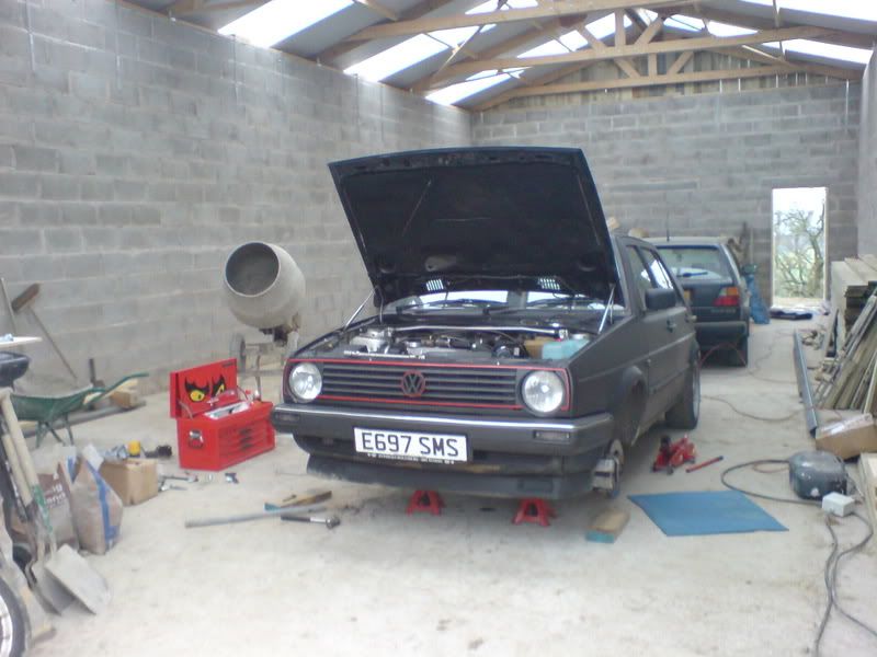

My mate took me over to get it a week later, put my wheels on it and had a great time driving it back :laugh:
Ready to go ..

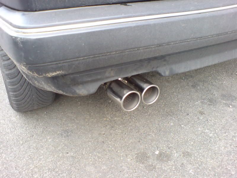

First thing I did was change the backbox as the one on it was a bit knackered and hung down quite low so looked like it was falling off anyway.
Old
New

rust  :sad:
and bad rust  :cry:

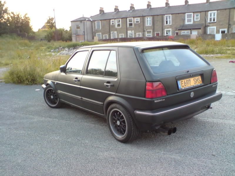

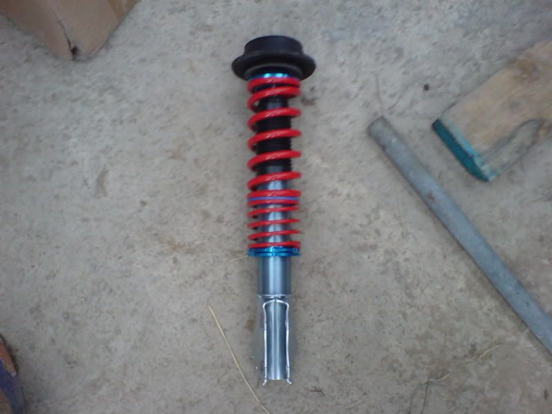

Over the next few weeks I didn't do a lot to it except drive it  :cool: as I was busy doing a masters. However, I quickly got bored of the ride hight and the wheels .. so got some brand new hottuning coilovers (I run them on both my other mk2s and think they're ok - a lot less firm than my old beetle!) from someone locally and picked up some new wheels off ebay.

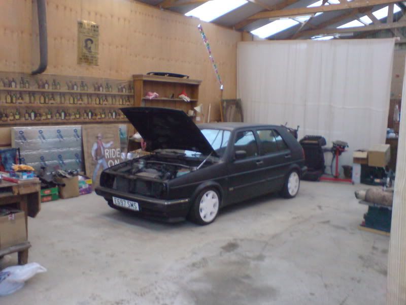

Into the workshop (that's now nearly finished)
Coilovers

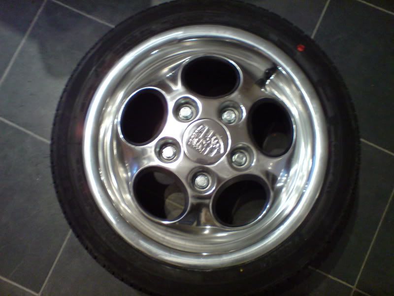

And some new wheels .. 15"x7j et 52.3

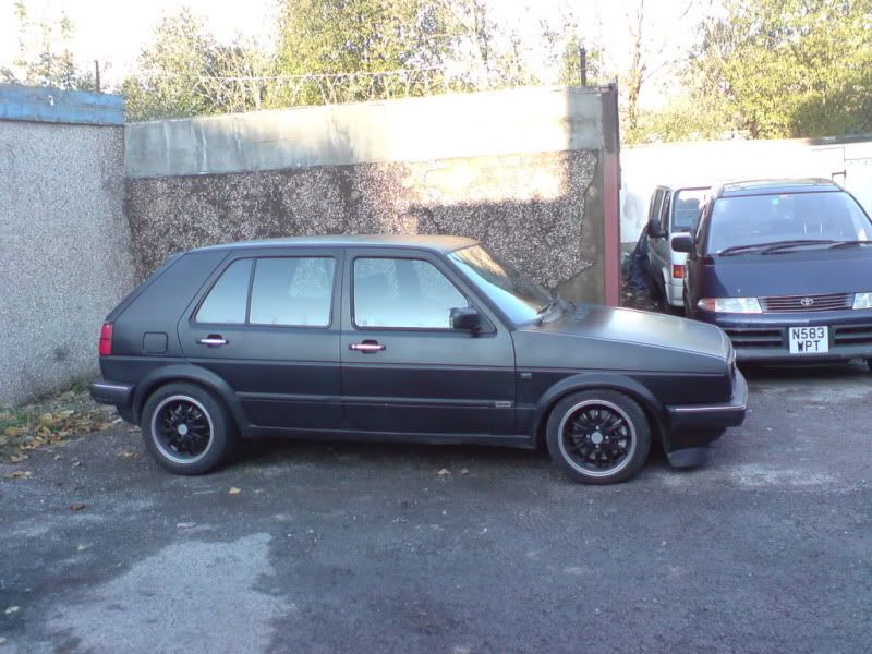

The wheels quickly had some attention and new rubber (175.50.15s) and were fitted with 20mm fk adaptors. I also changed the headlights to a crystal set I had as the smoked ones were terrible, couldn't see a thing at night!
Wheels :D
On car

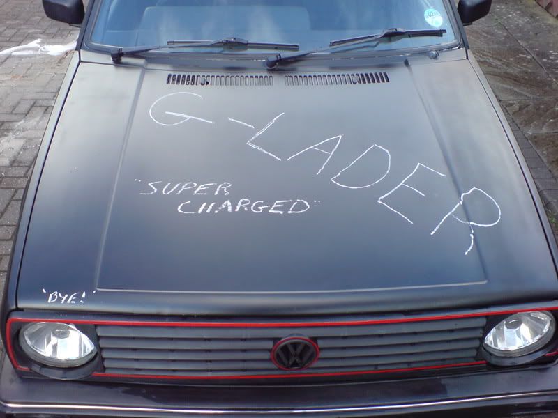

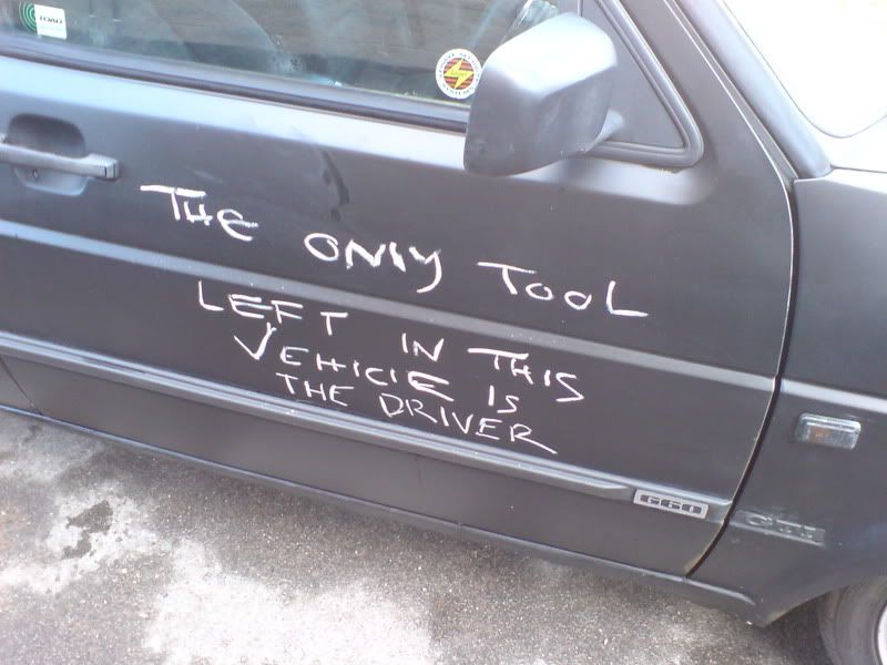

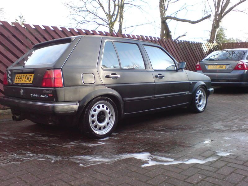

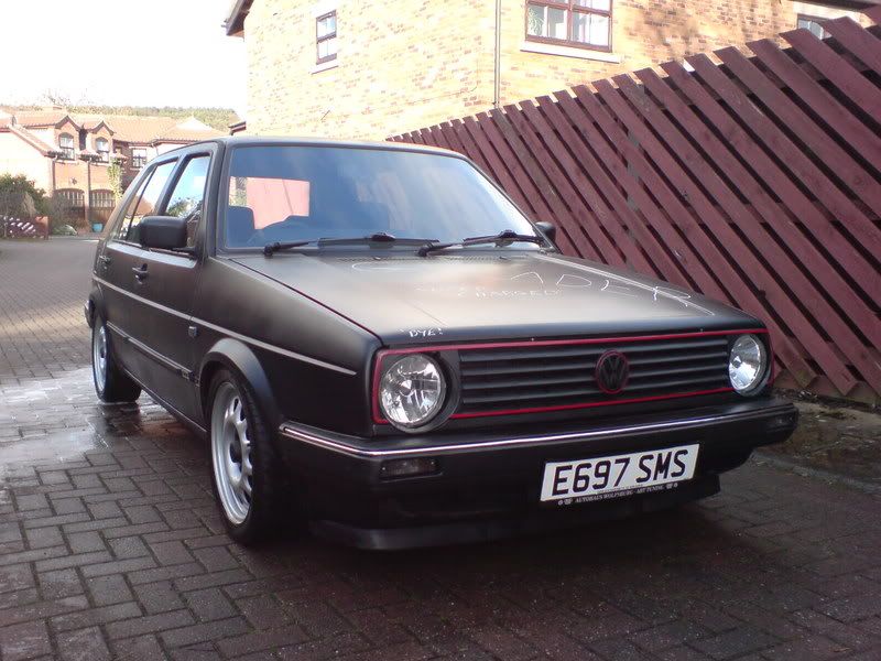

Whipped off the teledials for some much needed attention so stuck my g60 steels on temporarily and gave the car a wash for first time since buying it  :shocked:
Then my friends got the chalk out :rolleyes:
What nice friends I have..haha
It all came off pretty quickly (rain), though probably a good thing.

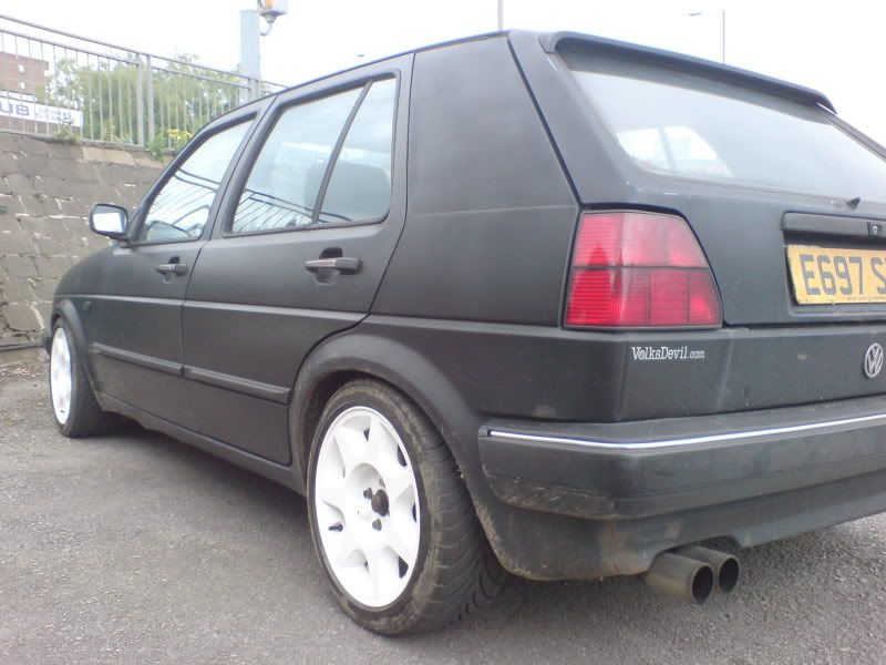

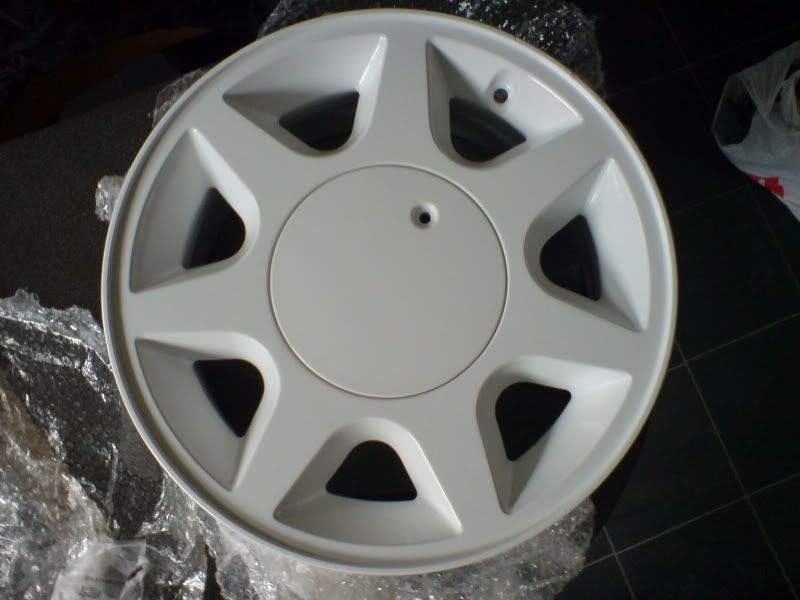

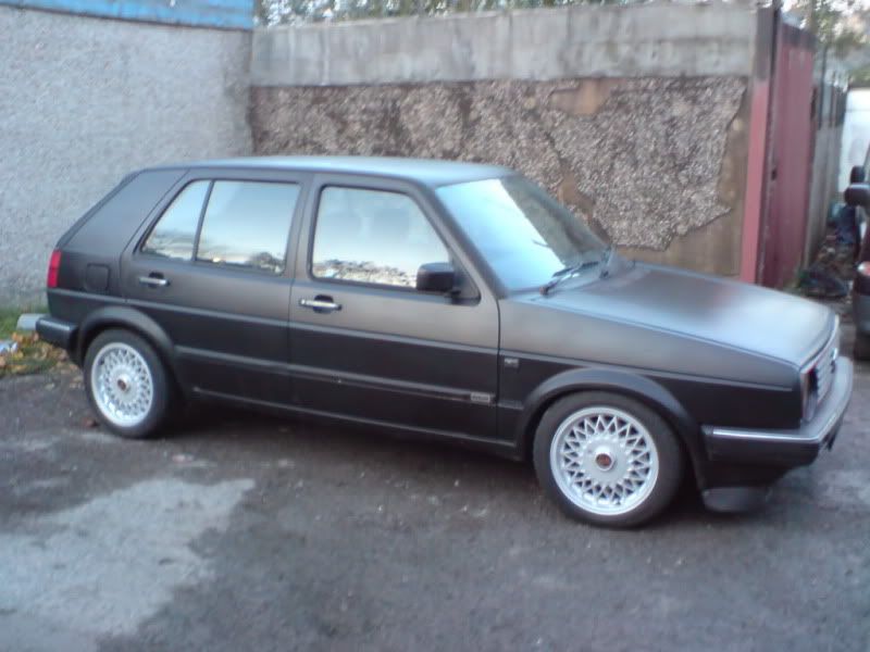

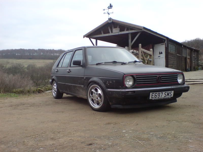

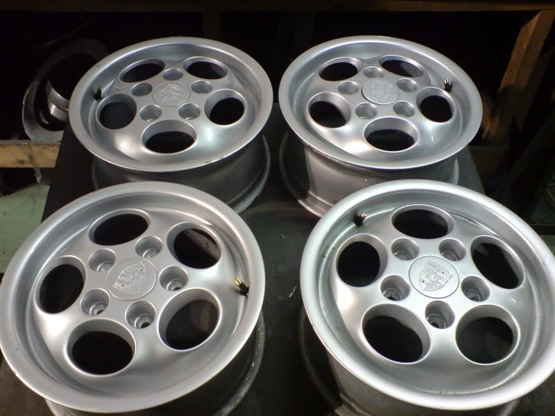

Right, so that was up to January '09, didn't do much else till March when I finally got my hands on some wheels I'd been after for a while :grin: Aero-tech alloys, 15"x7j. Got them blasted and powdercoated in white ..
and a (not great) shot of them on the car shod with 195.45.15s

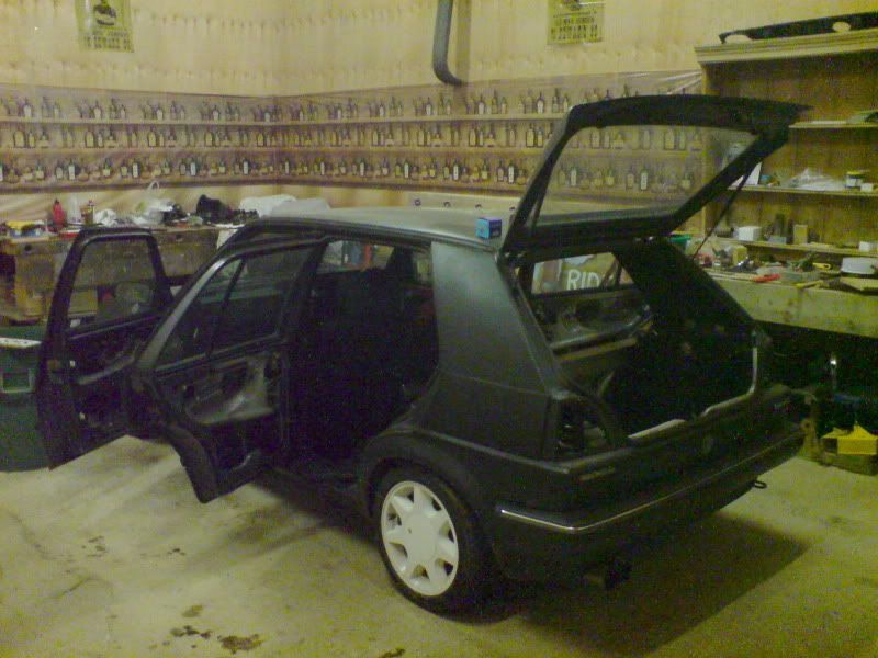

That was pretty much how it was until June when the mot was due and I didn't have time to do anything to it due to dissertation writing :sick: so stuck it in the garage and put my gtd back on the road.
Was left untouched until recently .. moved it into the workshop at the end of December;
Started stripping it down to see whats what

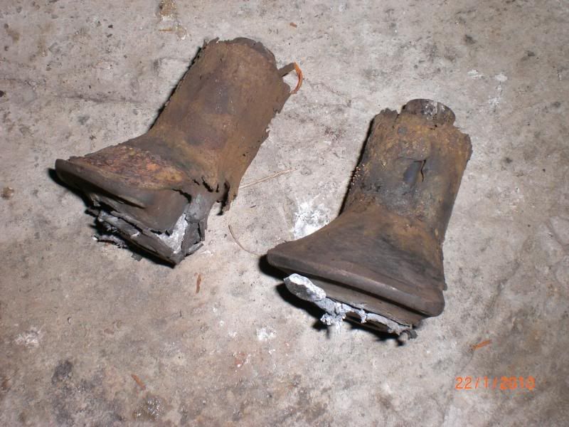

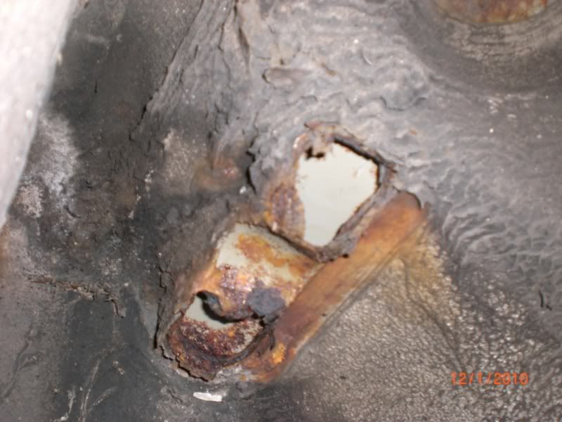

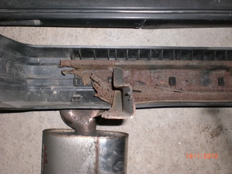

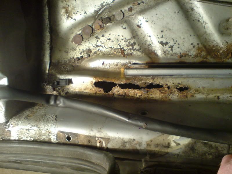

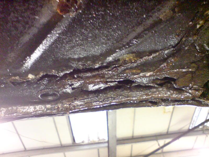

and found a lot of this :cry:

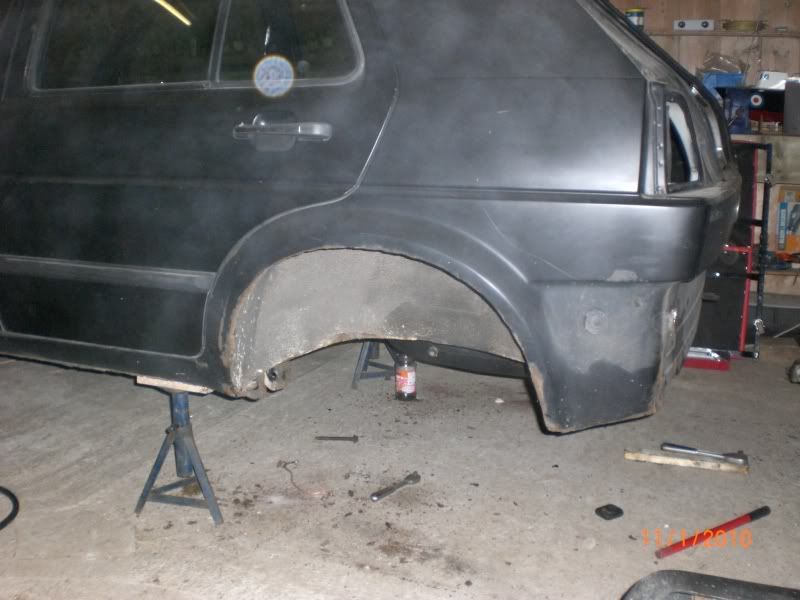

Had a poke at the offside sill too and it looks like it's gonna need a new one, but should get away with patching the nearside. About 5 floor patches and rear suspension turret and it'll be looking a bit more solid again  :smiley:

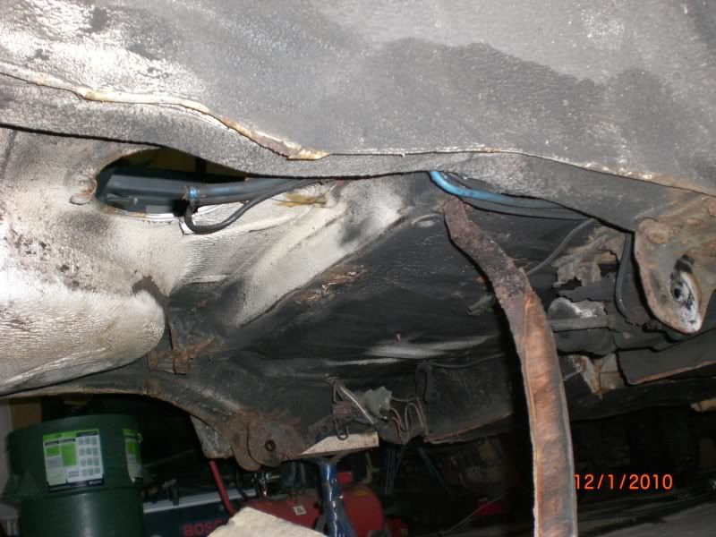

More digging produced this;
It's not actually too bad on the nearside, which is strange, the offside is a lot worse .. no pics but gonna have to cut a pretty big section of floor out and put a new plate in.

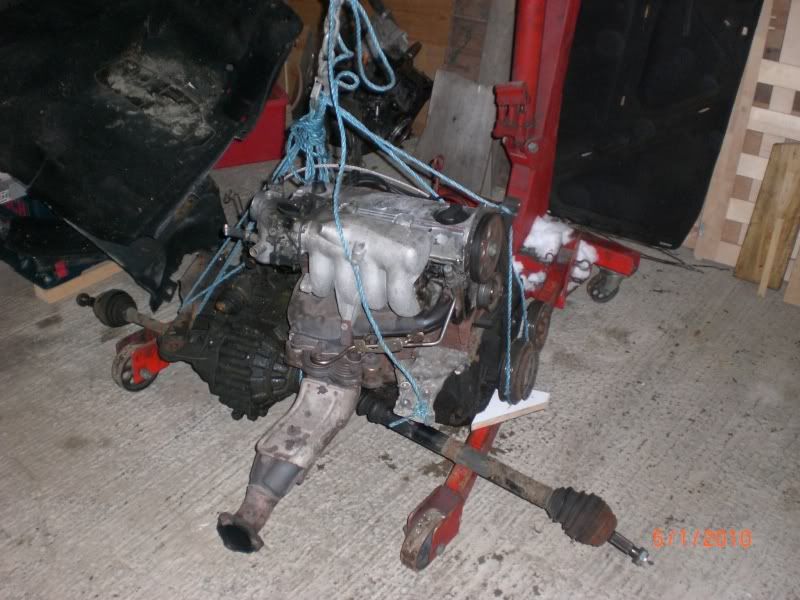

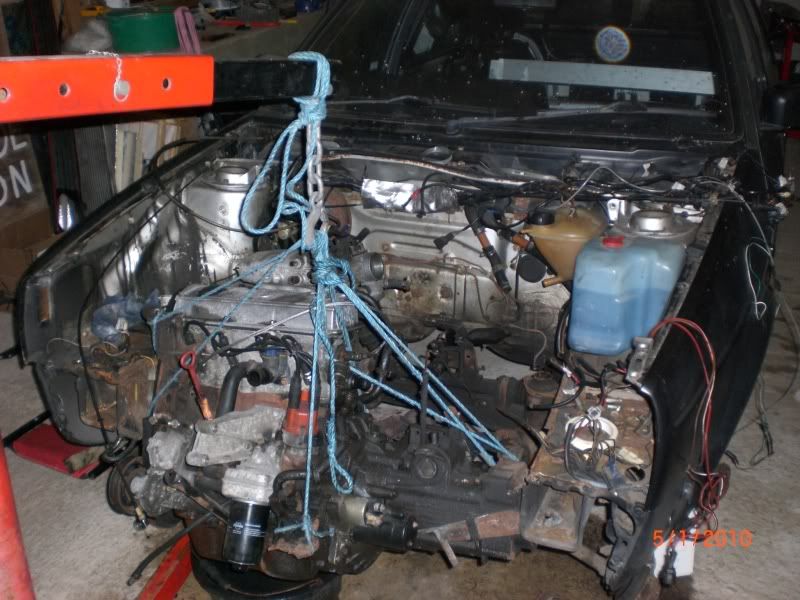

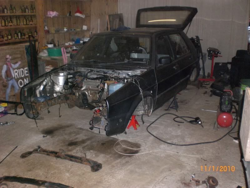

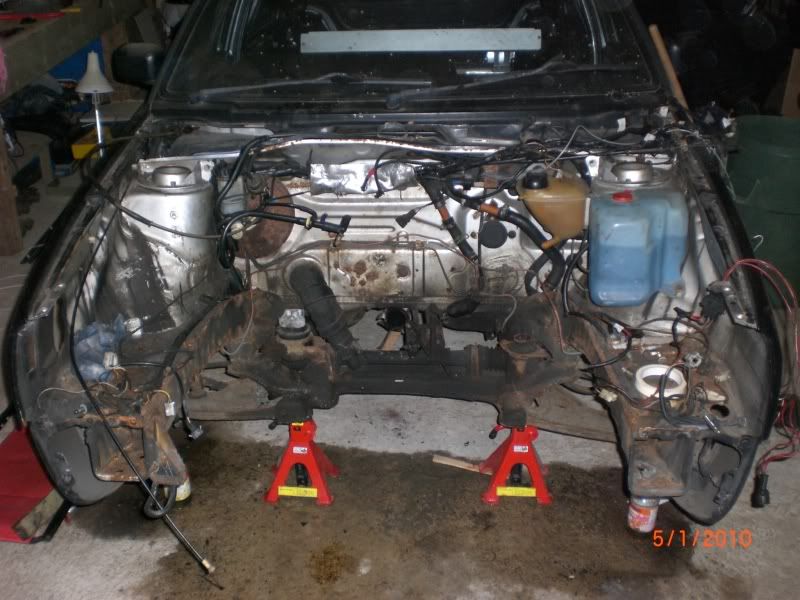

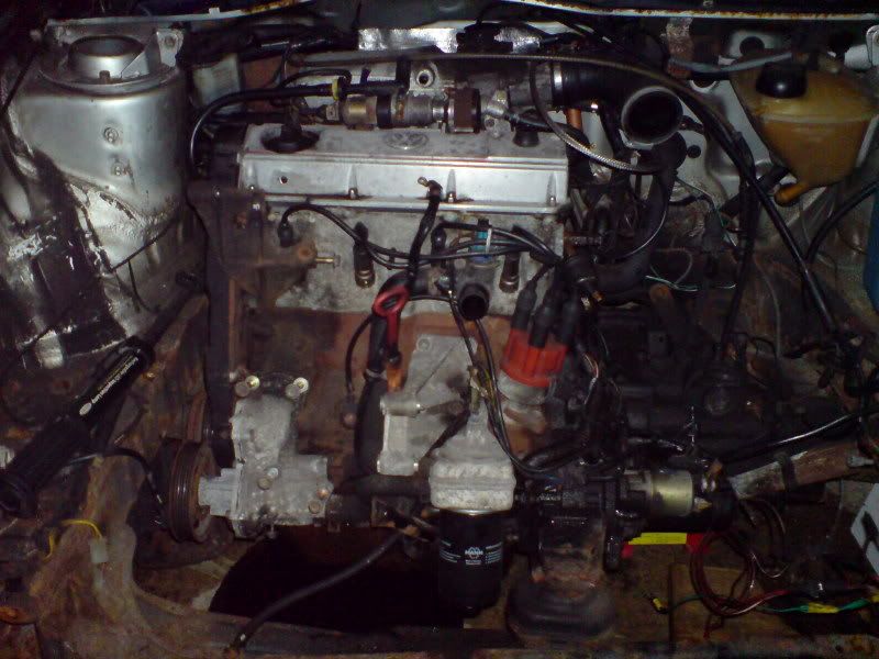

Got to work pulling the engine out;

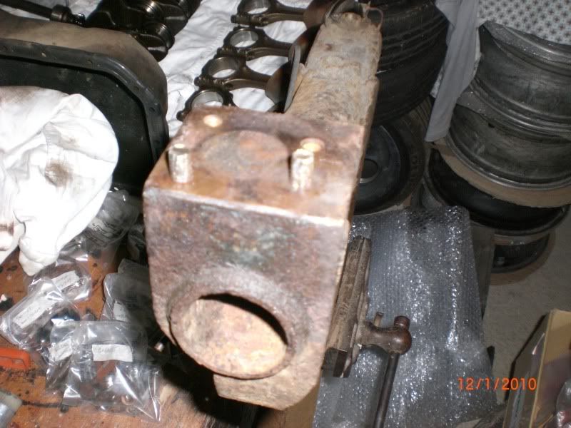

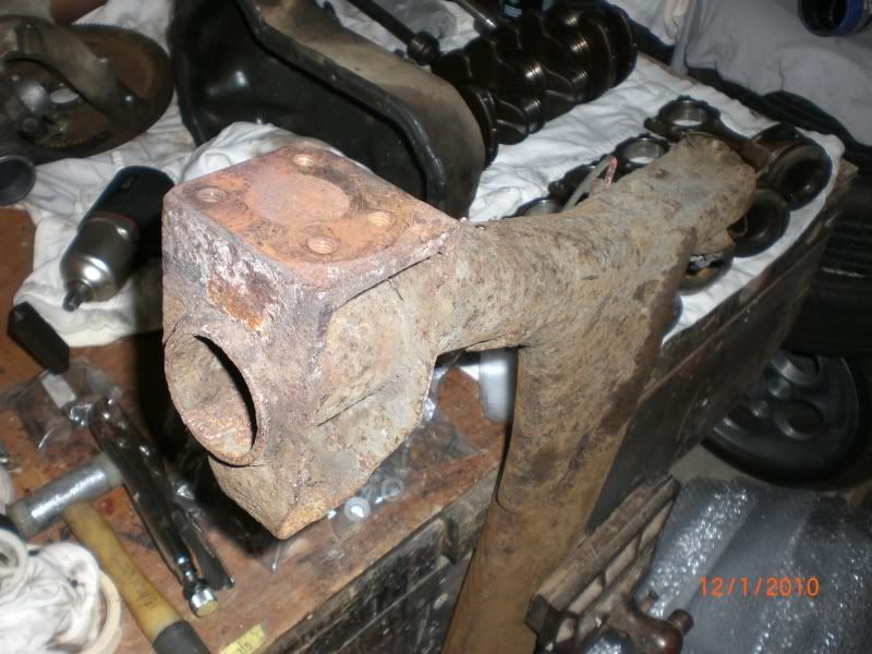

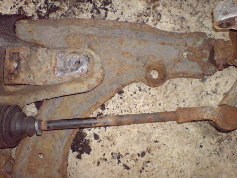

Worst wishbone (hopefully ok when cleaned up);

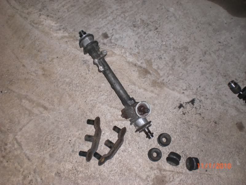

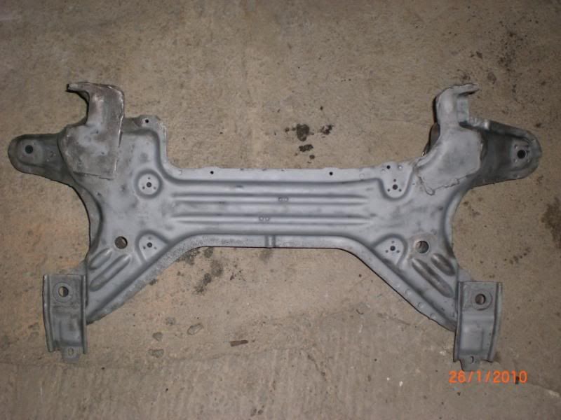

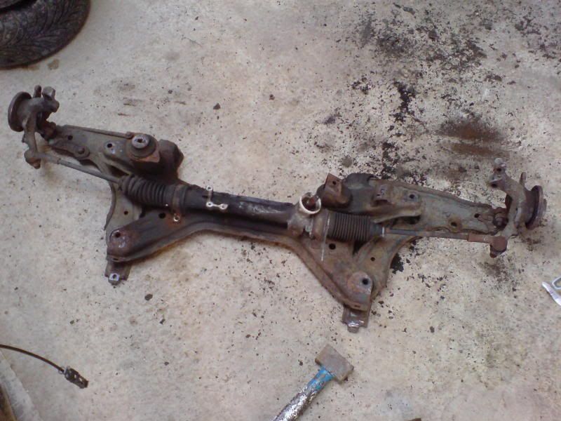

Took a while to get all the seized bolts out, but perseverence paid off and then started to clean it up somewhat, as well as steering rack and front subframe. Need to go over them with the sand blaster next.

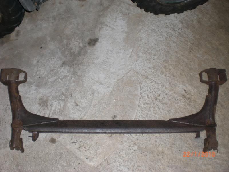

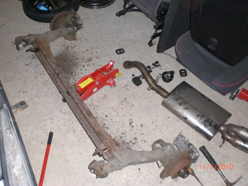

Then I dropped the rear beam off (sounds quick and easy when you say it like that :tongue: ) and started cleaning it up along with the front subframes.
Up in the air (and a messy workshop!)
Beam off
Back end looks odd without the beam/suspension  :huh:
Started stripping and cleaning
Front subframes
Steering rack

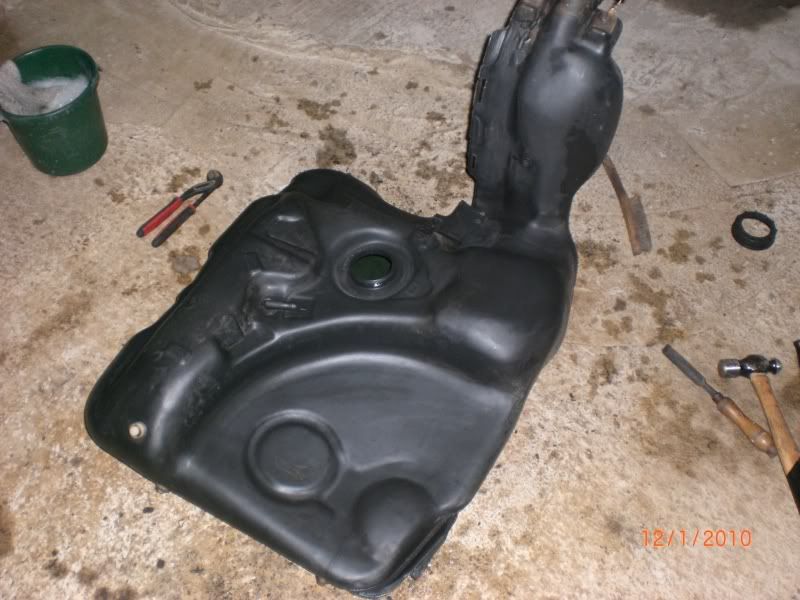

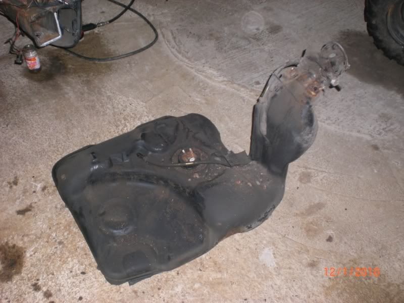

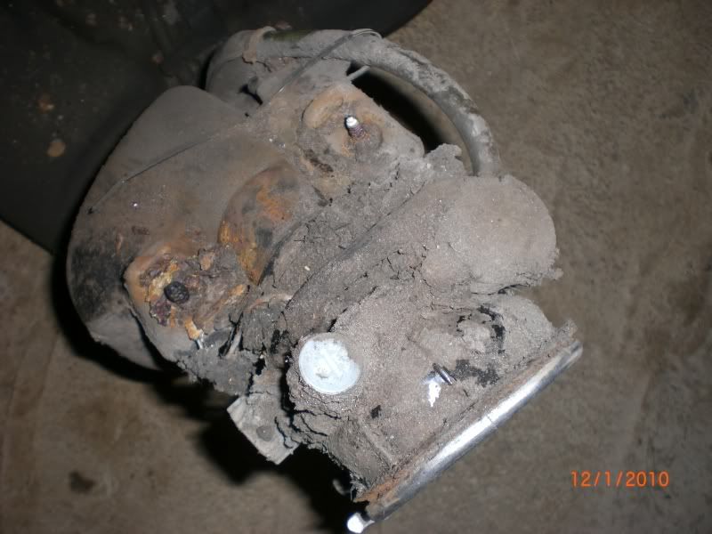

The fuel tank was next and was a bit of a mission as VW in their wisdom used some nice mild steel bolts to bolt the straps on .. resulting in knackered bolt heads some 20 years later :rolleyes: Managed to get 4 of the 5 bolts out in the end, will deal with the last one later. Had a bit of a fight with the rear beam too :rolleyes: three of the stub axle bolts seized, one came out relatively easily, but two were a right fatherless son :angry: blow torch sorted them out :grin:
Tank out
Few holes left  :undecided:
Deal with this later
Cleaned up
fatherless son bolts
Sorted

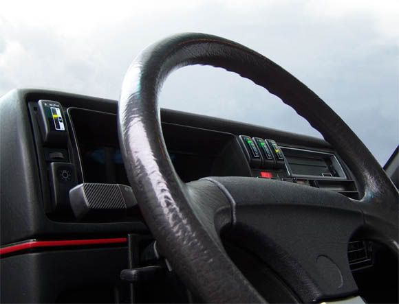

I then made a little purchase :grin: which solves my problem of where to put the gauges.
That is pretty much up to date now. Next job really is to get the last few things out of the engine bay and set about knocking up a frame to roll the car over .. it needs too much welding to do it all on my back with my face a few inches off the car!

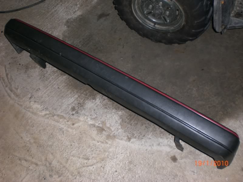

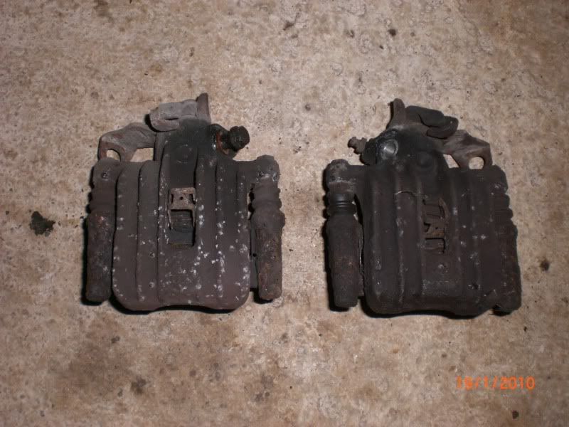

Picked up a new rear bumper at the weekend as the old one was knackered. Also went to the scrappy today and got some mk4 rear calipers :) Cheapest conversion hoses I've found are on ebay for £28 + £4 p&p .. if anyone knows anywhere cheaper then pls let me know  :wink: Also found that I can use the 4hose goodridge kit together with the conversion hoses to make the 6hose kit I need so that'll work out a little cheaper :) GSF sell the 4 hose kit for about £35. Couple of pics;
EDIT; The GSF 4-hose kit doesn't work as it is the two fronts and the two rears that go into the disc. What you need is a 4 line drum (non gti) kit as this has the two fronts and the two lines that go over the beam, which combined with the mk4 caliper conversion hoses gives you the 6 line kit :)
Old bumper;
New;
Mk4 calipers
These will get stripped and painted before fitting of course. My main detail colour is going to be matt white (plasticote) as it should be a nice contrast with the matt black :)

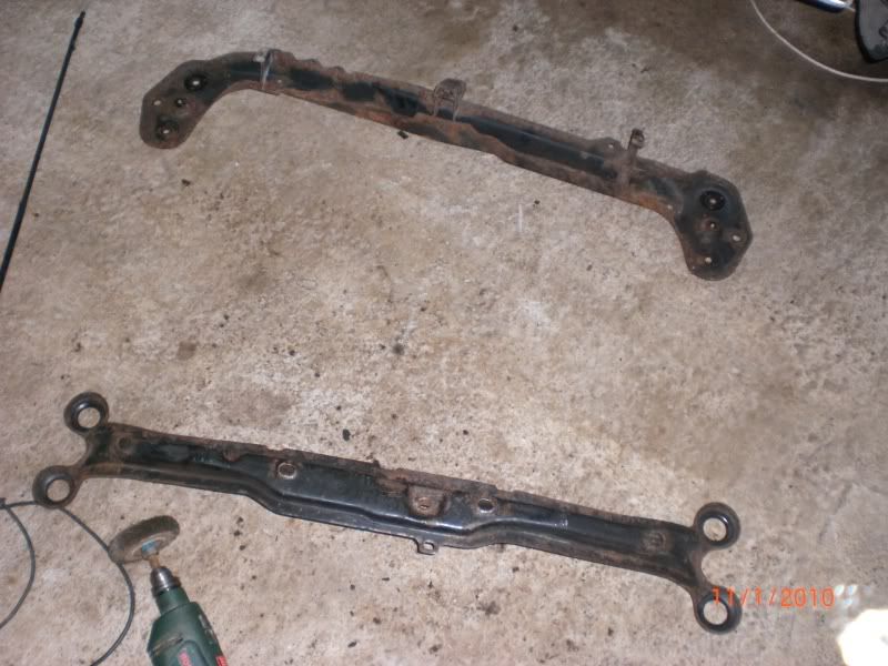

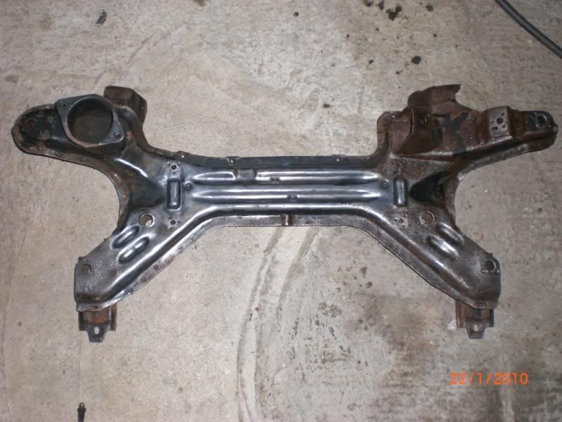

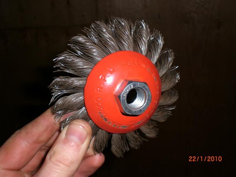

Right, as always not got as much done as I'd like. Cleaned up the worst of the rust on the subframes and rear beam, removed the bushes from the rear beam and found some powerflex rear bushes for £25 :grin: result. Have also stripped the carriers and slider pins off all my rear calipers and cleaned them up a little. Am getting the sand blaster out (finally) on Tuesday (my next day off) and will pick up some paint this weekend so should have some pretty pics next week  :cool:
Great piece of kit this;
Resulting in a much cleaner rear beam and subframe;
Rear bushes were really knackered and were very easy to remove :grin: only took a few minutes to remove both - had set myself up for a couple of hours for that job too;
No pics of calipers, but the mk2 rears are now for sale if anyone is interested. Thats all for now :)

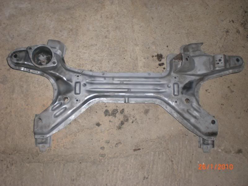

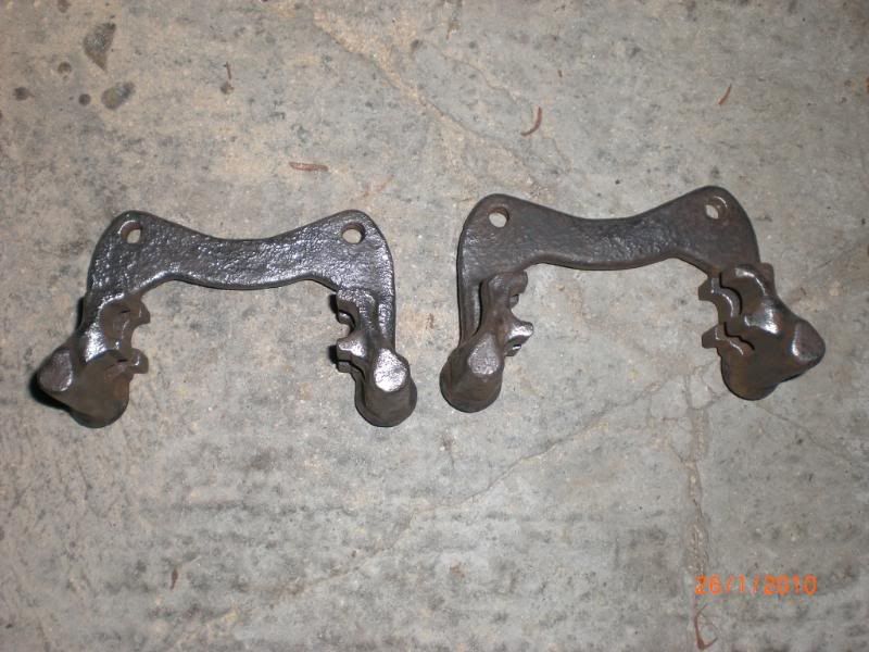

Bit more done today, but as ever not as much as I'd hoped. Had a few probs with the sand blaster so need to buy a couple of parts for it before I can do anymore with it. Managed to do most of the rear subframe though :grin: just a couple of the difficult to get to areas left on that.
Picked up some etch primer (bloody expensive stuff! Couldn't believe it) and some decent metal paint (supposedly better than hammerite, but we shall see) to paint all the underneath bits in :)
Started cleaning up the rear carriers too, but will finish these off with the sand blaster when it's useable again.
Subframe;
Carriers;

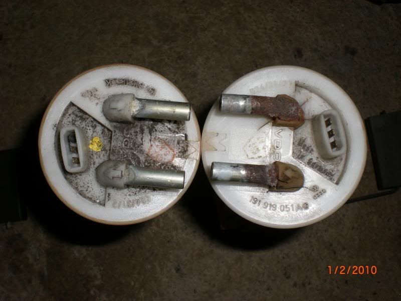

Also bought a new lift pump housing as the old one (right side) was pretty corroded and the plastic was pretty cracked; (99p ebay bargain)
