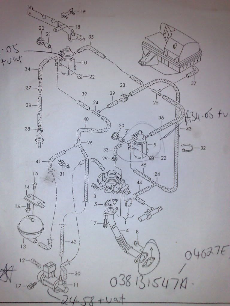

well vw gave me this today  they said n75 code brought up 3 different parts all circled dont worryabout the gasket that was another question i had for him.  prises are next to them
prob is i dont know which one or all three need changed to fix  as think the top 2 are the solinoid valve for boost pressure control   so does that mean i need two ? as i no longer have egr so i think i only need one and that would be top laft????? as top right goes to egr or that still cause prob?
plus what is the part at bottom  with the 24.58 plus vat thing? cant find it in haynes.
cheers
oh and that to  everyone so far as since egr allard kit all sound and solid no more esp light on shprt journeys unless i really push it on a long one so i getting there just hope it aint the injector itself after all this.

as you look at the engine bay its the one on your right  :wink:
as a test you can swap the one for the EGR with the N75 to eliminate that as your problem
just remembered about this site
http://www.myturbodiesel.com/1000q_how_to/multi/limpmodetdi.htm
Hopefully that will give you some ideas  :smiley:

think the N75 valve is number 9 £34
The two valves (9 & 10) they are the same part no(?)

think they are 1 digit/letter different, but look exactly the same

yeah guy said they the same but one was say ending in letter r the onther in say p for example. but he didnt mention or seemingly know what the bottom part was grrr nice but dim lol even with my crayon level explanation lol

if no 9 is the n75 then i cant swap it as it is the part that is not going to anything as hav allard kit so it not connected to egr (unless i read it wrong). but if pic correct there is another what looks like n75 valve or solinoid on other side of engine,(i not had good look yet as car not at my house) it looks the asame and seems to be running down towards turbo? and on the off chance any idea the  part at bottom of pic ?

1. do i presume no need for the parts in the diagram i had?
