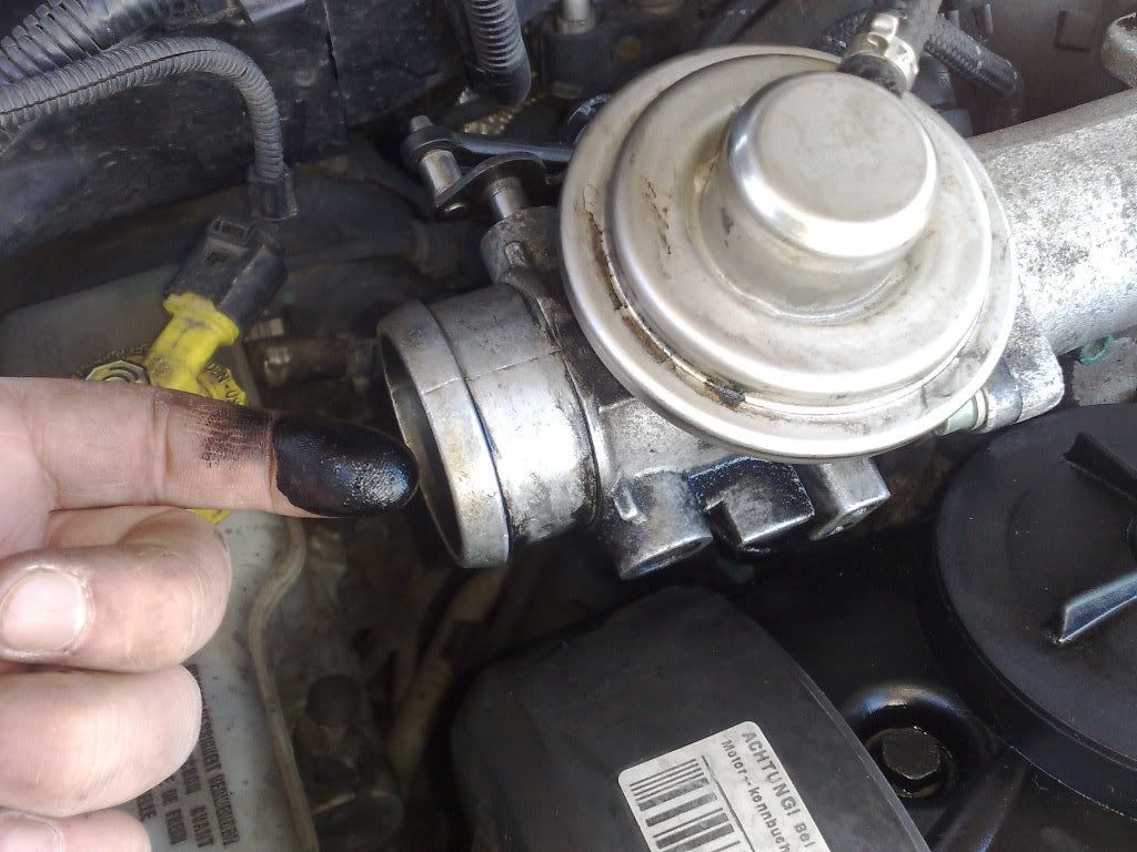

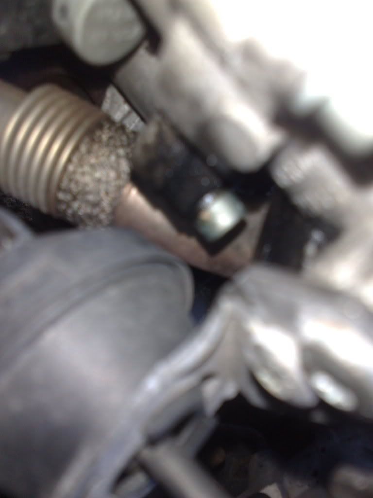

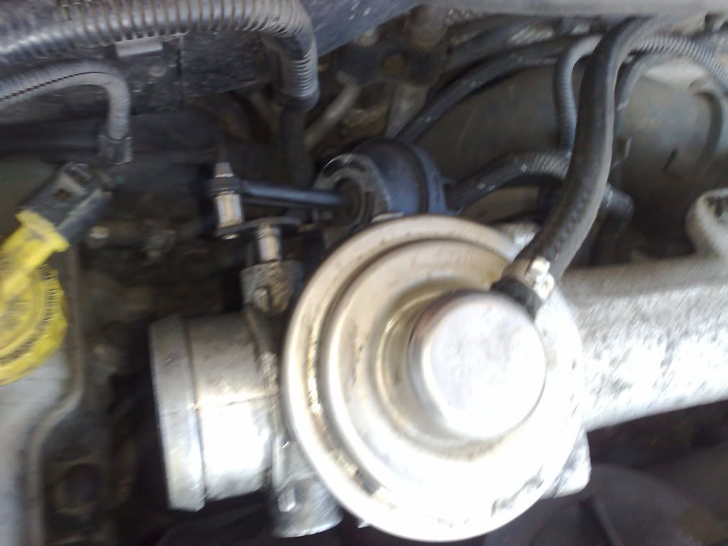

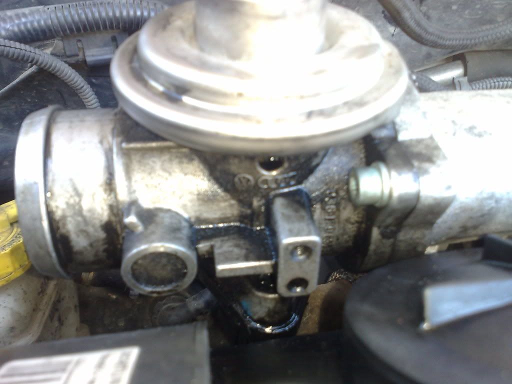

right tried to fit allard kit but had to giv up as a couple probs well 2 probs. the first is i cant get into undo the bottom allan key nut on th egr as only say 10 mil between that and where the blanking plate goes on the intake???? only way i can think is to cut an allan key ver short so only enough to just get in an grip it???????
second is  a question really in this picdo i do away with the ball like joint which looks like it operated the butterfly valve inside the egr , i gussing yes as egr will b completly taken off car but again no space and looks like it a torx bit to take off the two screws that hold it on.
plus once had pipe off it soaked with oil internallt see pic of pipe and egr. plus looks like oil comming from othe bottom threaded hole at from of the egr (see pic)

well that the allard kit on i needed a torx 25 bit and got round biottom bolt by pushing down the intake pipe as took bolts out for where the blanking plate went frirst.
