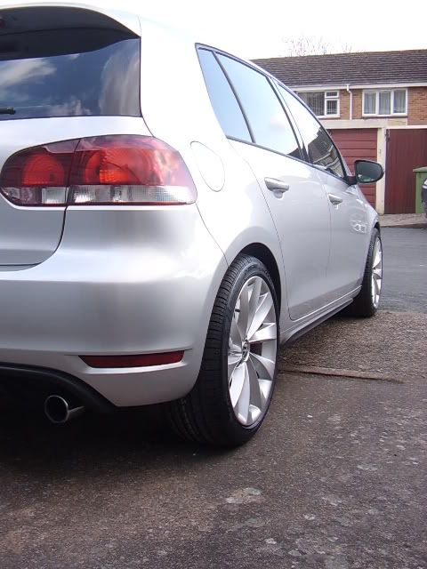

Forgive me for poking my oar in here but here's a shot of mine wearing 235/40/18s taken some time ago which will give you a rough idea of how much the front wheels protrude from the front 'fender' arch.

Thank you, I appreciate your poking. It is just so hard to tell from photos, with the angle having such a dramatic impact on how it looks. Would say the wheel does protrude at the top or is flush, say if you used a level from the fender to the top of the wheel? Thanks again.

The rear sits quite flush, the front tread is roughly level with the outer edge of the front fender (wing in English!!!) but the sidewall protrudes a centimetre or so (third of an inch). Some of this will depend on how meaty the rim protector is on the chosen tyre (mine are Pirellis). 225s on the front will sit quite square on an 8 inch rim and don't protrude in my experience. I previously had BBS 8x18 inch wheels with ET44 on the car which is only a 3mm difference in offset and these didn't protrude at all.

Thanks again, for your evaluation and for helping me with proper English and the metric conversion. I love the Interlagos wheels, so I was hoping maybe 8" ET41 was really the perfect set-up too, for totally flush, but maybe 8" ET44 or ET45 really are the ultimate. With just the sidewall poking, not the tread, maybe I will love them. I do like the big stocky look. I was also hoping that maybe the top of the wheel rim would also be flush. With the negative camber, even though 235 width is wider than the 8" wheel, it seems the upper lip of the wheel could be out from under the "wing". Would you say the top of the wheel is flush, or poking?

It's hard to tell 100% whether the actual wheel is flush with the arch (fender/wing  :grin: ) due the the bulging sidewalls on the tyres. I would guess that it's just about level but can't offer a cast iron guarantee. Maybe if you could PM SteveP on here who is currently running Speedline 8x18 wheels with 225s on the front and 235s on the back and are a 42mm offset, which is near as dammit identical dimensions, for an idea how his look.
There may be pictures in the 'non Monza wheel thread' on here of his car and I know he's posted some up on golfmk6.com
