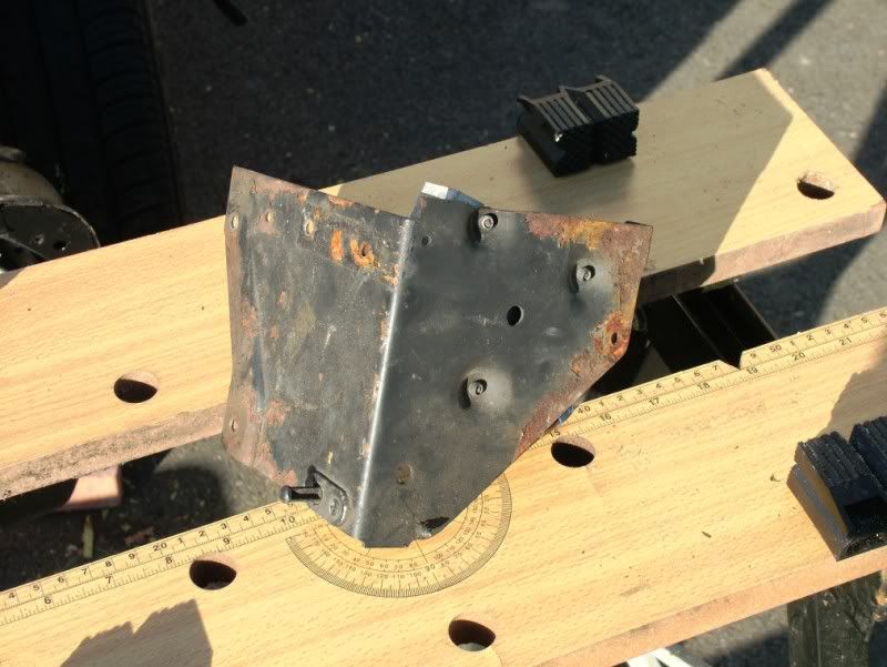

The bit in the bulkhead that the Ignition Module is attached to was a mess so sorted that out too.  Removed the unit from the heatsink first before i did anything.

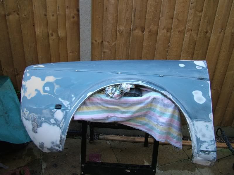

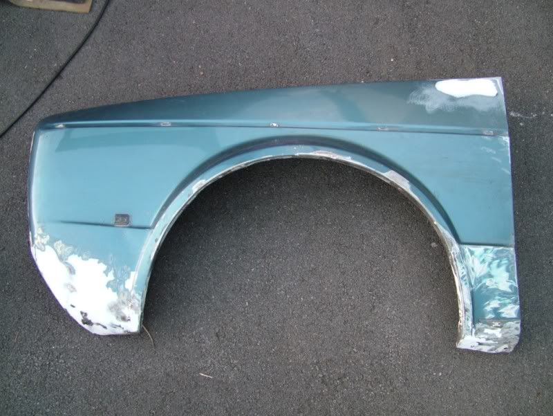

My mission this weekend is to get the wings prepped, painted and fitted.  I'd already done quite a bit to the £25 near side blue one but needed more.
As I left it
after finding more imperfections I gave it another skim then sanded like a mofo, 80, 120, 200, 400 grit.

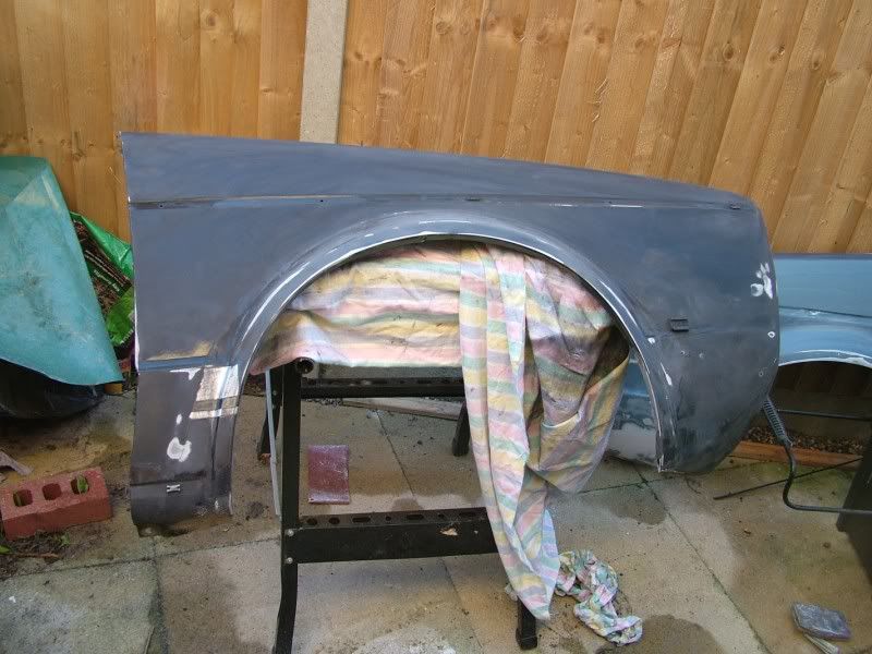

then primed it and hung it to dry
Got to work on the orginal off side wing, same again with the sanding
No need to prime as its original paint was very good, with the right surface out came the satin, you may notice lines around the arch, this is a marker for the kit.. sorry for rubbish pic but worked though the night!

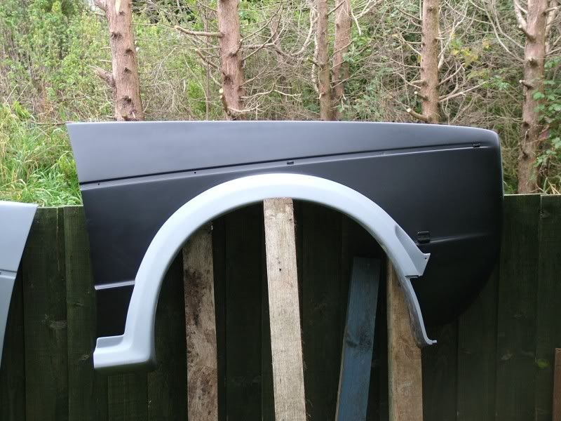

Once the wings were properly dry they looked sh*t up close, grey patchy areas, I think the cold damp air fooked them as the stuff I did previously in proper daylight were fine... I used a rubbing compound and then polished them, looked worse!  Cleaned everything with alcohol and Keyed them both back.................. AGAIN!  :angry: Resprayed and the paint reacted!... FFS!!!!!  :angry: So did that step for another time until all was good.  And between coats I had light help from this to keep things warm...  :smiley:
Not going to post all the pics for that as i'm sure you're sick of seeing my wings now!
Comparison Pic NS wing and BBS arch  :cool:
Now both done but after the disaster I am very unhappy with the finish on the NS wing but it will have to do as I need to move on!
