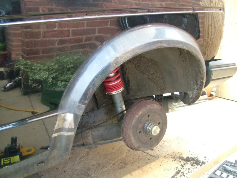

Its a right b!tch when you work like this, You cant see the rest of the stuff behind the car and when it rains you have to cover the car and pack everything away FAST!  happened a few times this week!  (i bet Dan and his wagon know what thats like!)
As posted earlier when i first fitted the coilovers i was unhappy with the rear, i couldnt get a decent ride height without problems!  The main one was with the little amount of weight on the rear, a low ride height would end up with the cars weight resting on the helper springs which made the car bouncy as fook.. Also i just chucked them on without doing the airlock thing you're supposed to do to the dampers before fitting! And in the panic to get her on the road i started taking short cuts and didn't service the inner arches like i did the front and still hadn't taken off the last part of the body kit covering the N/S arche. Off it all came!
found some rust too!   :angry:
It was just the lip that was dodgy and the kit covers it... not the point though as the kit screws to the lip and I need it to be strong and for the rust not to spread.  ground all the sh*t off, treated the rust 5 times until all i could see was clean metal and had to resort to epoxy metal to fill up the gaps.  will do for now, be ok once sanded down and painted but will be keeping an eye on it, new metal welded in soon me thinks.
Also scrubbed the inner arches to death!
Got the old black stuff out to keep them nice!!!

Took the rear coilovers to bits, removed the helper springs so i could wind them up without affecting the height but make the car sit on the proper springs!... its loads better now and when jacked up the spring is still under tension..  :smiley:
