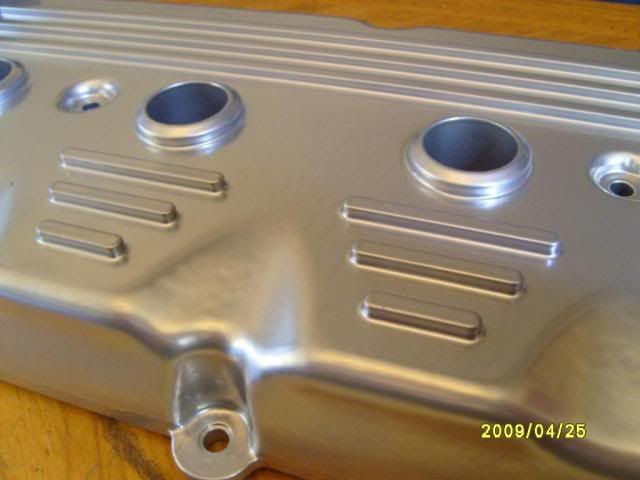

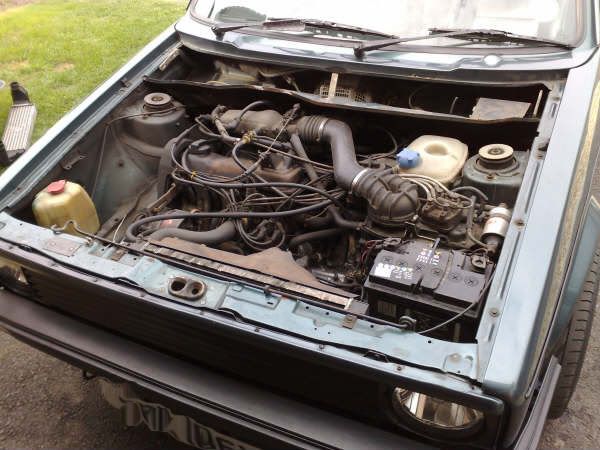

Time to get this project rolling, with a big thanks goin out to RIXY for the fitting and RUBJOHNNY just for being the font of knowledge that he is lol!
Before  :huh: :huh:
After  :wink: :wink:

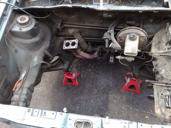

« Reply #64 on: 03 May 2009, 16:59 »
And after a little cleaning  :cool: :cool:

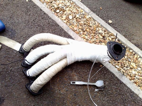

« Reply #67 on: 04 May 2009, 21:14 »
Nicely insulated!!  :cool: :cool:

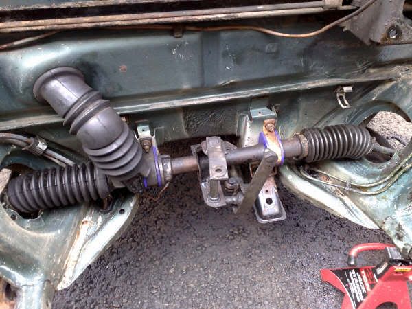

« Reply #68 on: 04 May 2009, 21:34 »
Steering rack polly bushed!!  :cool: :cool:
