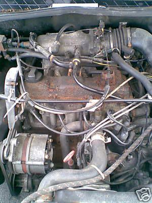

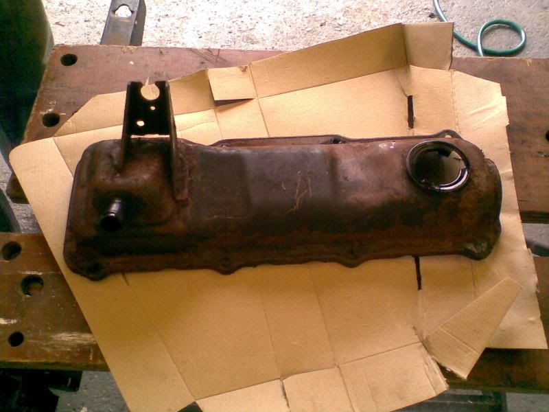

Just done this recently on a mate's Scirocco.
Looked like this when we opened the bonnet....

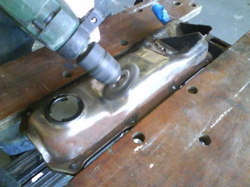

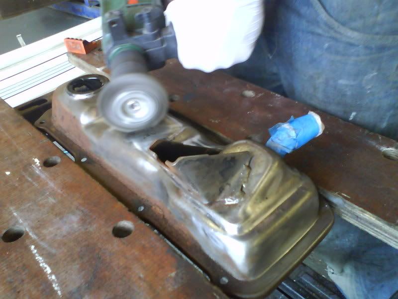

Then after a wire brush...
Then broke out the drill & wire brush attachment...

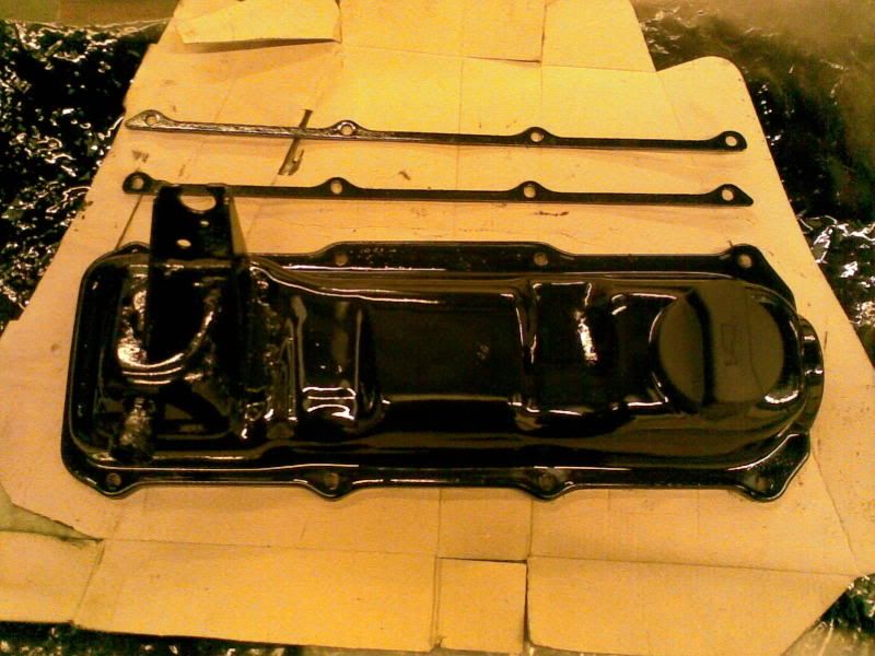

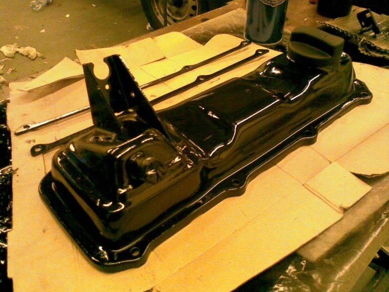

At this point we contemplated polishing it, but for practicality reasons of it being a 'daily' we decided on the stock/ Hamerite option...
Which left us with the finished article! :wink:
