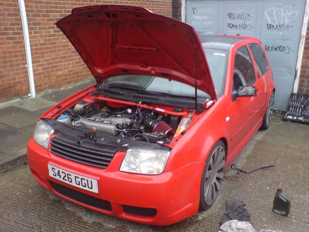

1) Big Bens Bolf:
Was a 1.4e (base model, same as mine) now has a 1.8t non remapped arz lump that has been rolling roaded at 233bhp (just been tuned and tweaked by ben the owner). Full r32 leather interior & clocks, Bolf front end conversion, coilovers, 19" a8 wheels, black roof, the list goes on!

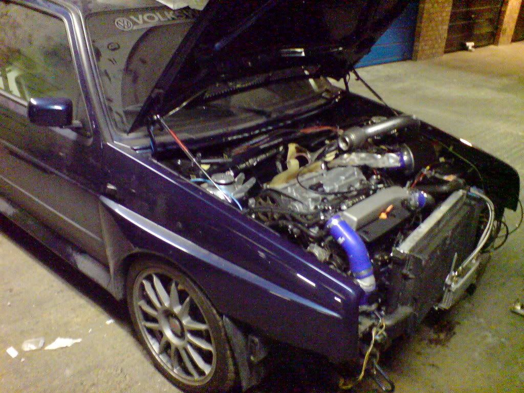

3) James Bangs G60 mk2 golf 4wd rallye
started with original 1.8 supercharged lump, since he blew the charger he swapped it with his  TT BAM lump (KO4 turbo) emerald management tuned by James to 289bhp
4) Ians Rallye g60 mk2 golf 4wd rallye

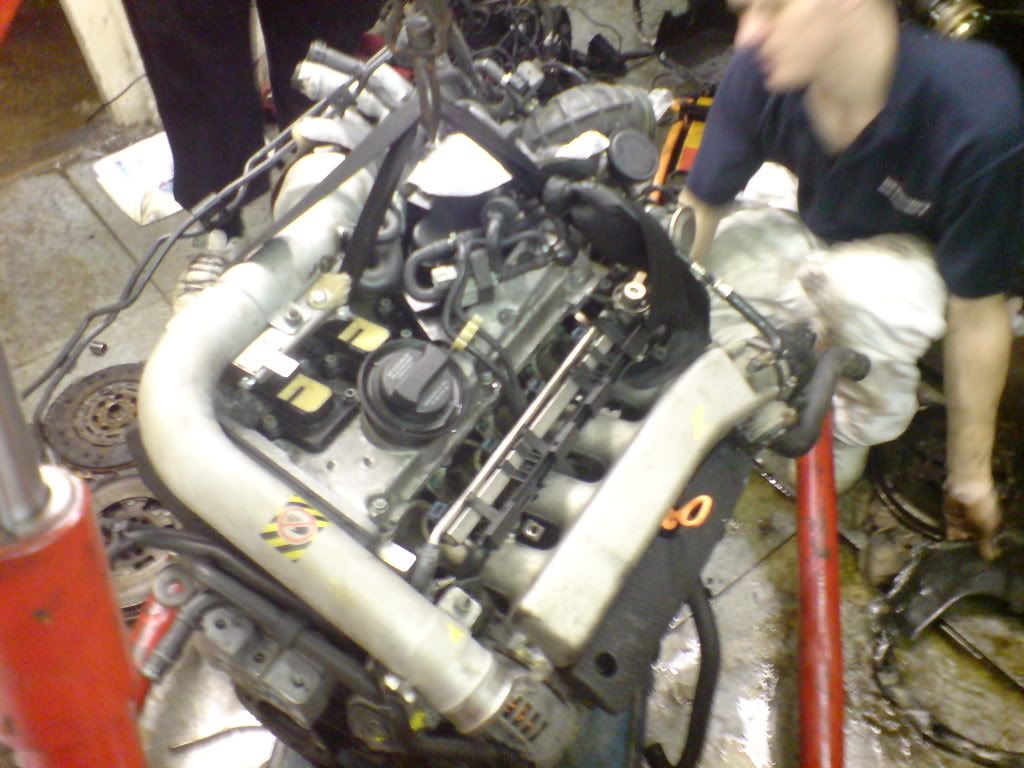

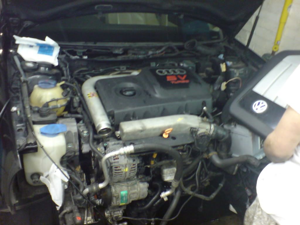

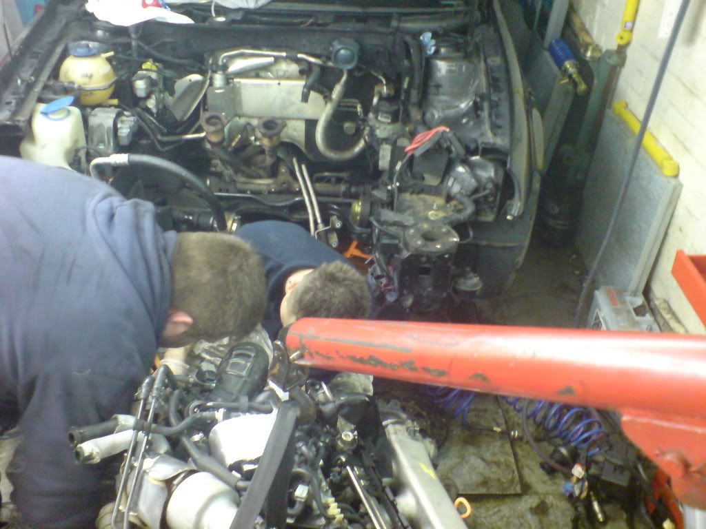

pics of coles conversion:

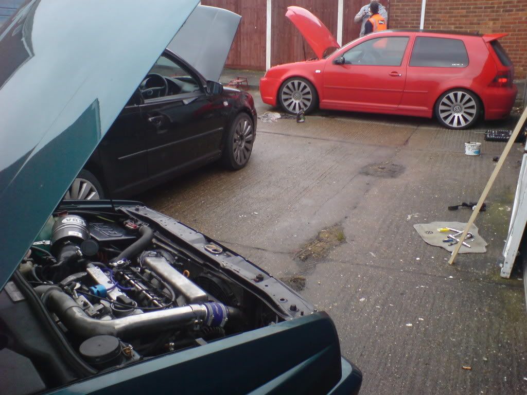

The legendary garages! This is where all the magic happens!
The main trio:
Just thought it would be interesting for people to see what cars we have actually done and just to back up all the claims that I have made that these guys know their sh!t and if you want a 1.8t conversion done (esp in mk2/mk4's) they can do it in a week!
