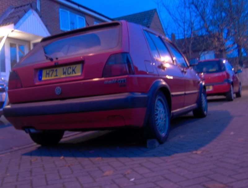

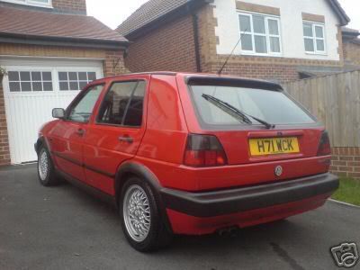

Well the search lasted 7 weeks, then i found this
118k, has had a roof down respray, recent head skim and  new head gasket. and a few other bits.
But the Main thing is its  ORIGINAL apart from lowered suspension.
And thats how it will remain, the whole point of this project is a In  Use Daily that will remain as original as i can.

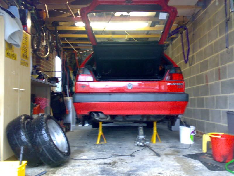

After a damn good clear and underbody jetwash it was into the garage to check over the rear brakes
So whilist flying i decided to do summat about the rear bumper not being level

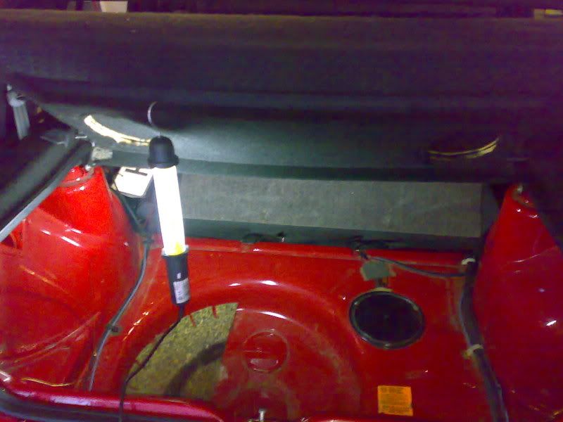

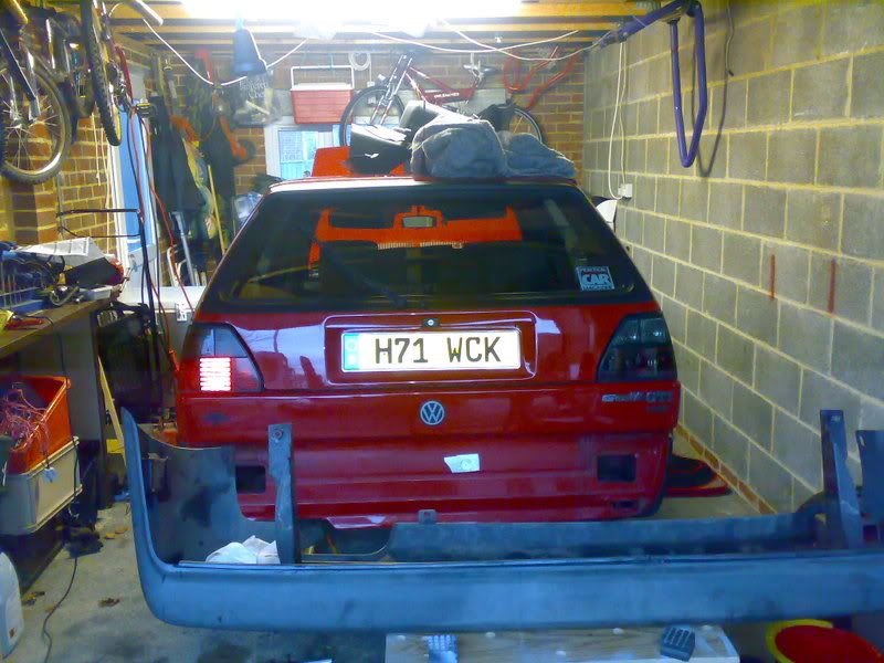

but the fact it was only held in by 3 DIFFERENT bolts might not have been helping   :laugh:  new bolts and a shimmed bracket should cure it tomorro.Gave it a good clean and polish ready for refitting .
i then decided to strip the rear  interior out, clean it all, cure the water leak where the tow bar electrix went, remove the METRES os unexplained wiring and re wire the rear speakes as they were somewhat bodged by the last owner  :shocked:
then i sorted the water leak thru the rear spoiler holes and trial fitted the new rear lights from russ racer ( not the best piccies - will do one tomorrow in the daylight
just got to finish cleaning the boot inside then rebuild it all after a trip to gsf tomorrow.
Then turn it round and do the front brakes and front interior  :smiley:

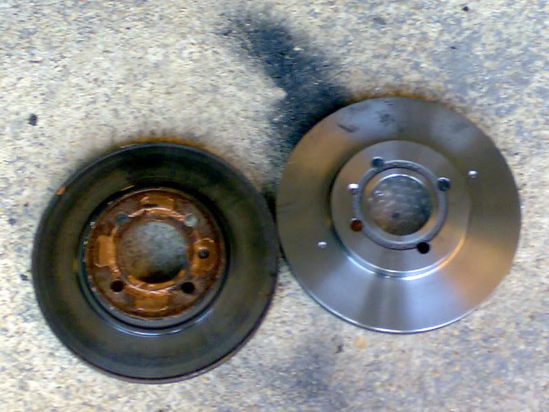

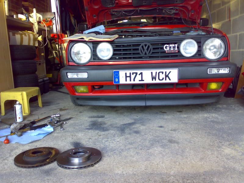

well after my oil change disaster i decided to treat the old girl to some new front brakes
so from old to new
thank god for breaker bars - the caliper carrier bolts were  :shocked: :shocked: tight
But all removed - cleaned - new brembo discs on - and just got to bed them in now. but at least the nasty wobble under braking has gone  :cool:
also hopefuly ( keeping fingers crossed ) cured my coolant leak - swapped the old spung clip thing for a jubillee clip and all is well so far

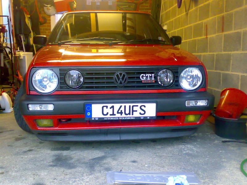

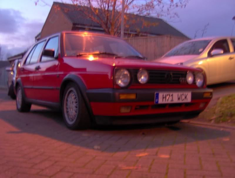

Well thought I would do a bit of an update
Firstly the front end is now nearly totaly crystal lit - just the fogs to go - but I want yellow crystals and I cant seem to find any out there
Then came the private plate as our lass wanted it off her car  - it was a question of which plate style and with a little help from chris - ( cheers again - I settled on a straight german style. )
Next came a new set of wheels - went for the easy and safe route of some g60 steels from caddy vantastic - cheers again. and settled for the Black inserts .
