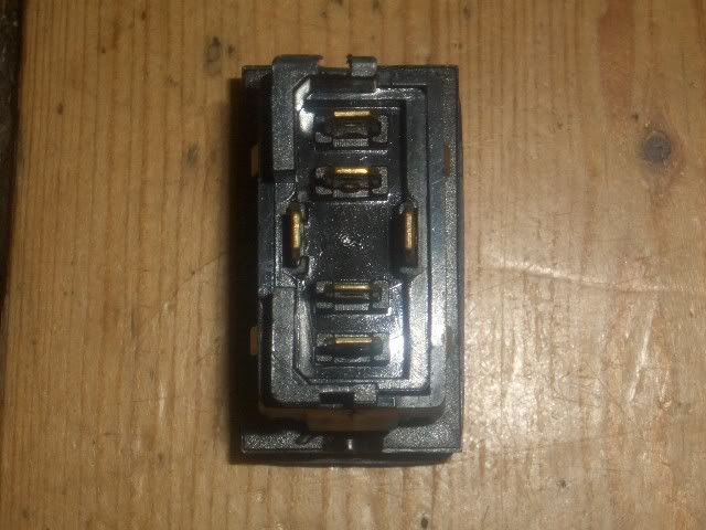

Got some new switches (cheers simpson!), but the pins are aranged differently!
So what wires go to what pins on here:
Heres me thinking it was a 5 minute swap job!

This needs clarifying but I think the switches on the console may be different to those in the rear doors. Do you have the correct ones??? Just a thought.

they are supposed to be, I think they are aftermarket ones though - just have the pins in a differenet layout?

im guessing the two centre ones are for illumination
the top ones for UP
the bottom ones for DOWN
multi meter them to find out

Pulled the old switch out and we have 3 common'd lives, a ground and the blk & blk/blu wires that go to the window motor.
ANy more ideas?

Just looking at the diagram below:
http://www.zen62266.zen.co.uk/images/golf/elwindows.jpg
This is exactly the same layout as the switch I have. It looks like the diagram shows ground going to the 2 centre pins - have I rad this right?
If so, I only have one ground wire from the VAG switches (And therefore a spare live as the vag uses 3), so do I just split the one ground into 2?

Just for your info folks,
The switches work wired as the piccy, just need to split a ground into 2.
and leave one live unused.

im a bit confuses, erm the blue and whit eones go to the top and bottom for the regs i beleive there should only be a live and an earth and the other is ilumination, i don't think you will have a relay on the gsf wiring?
