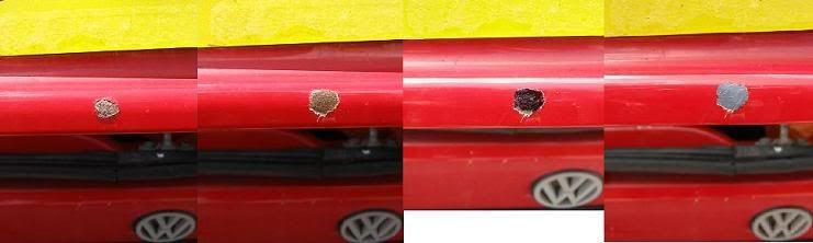

did a bit more work on the boot lid today.
thought i'd try and sort some rusty stone chip type spots.
1. nasty rust spot
2. scrape away all the loose paint and rust with the tip of a stanley knife. you need a steady hand.
3. paint on some kurust
4. with a fine artist paint brush fill in the chip with anti oxidising paint.
now all i have to do is find a decent tornado red paint match. Halfords are worse than usless. the tornado red they had looked more like tornado burgundy. I'm not sure how succsesful this is going to be but we'll see.  :undecided:
