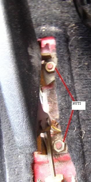

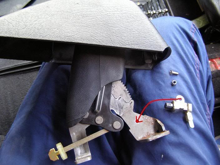

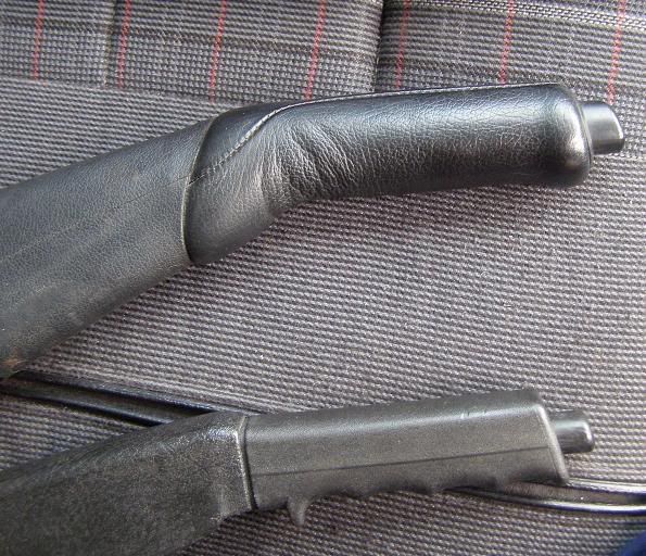

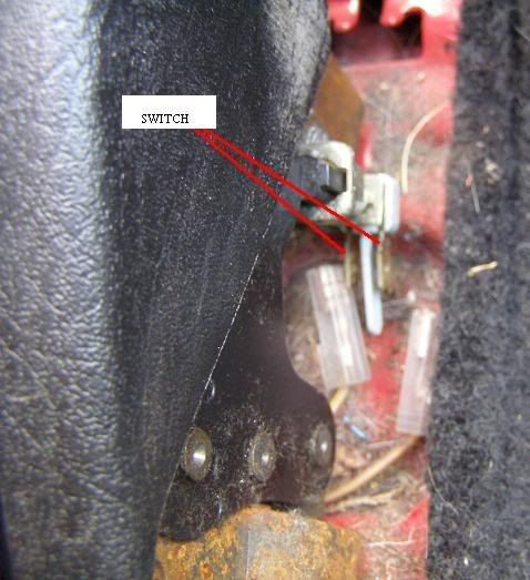

decided to see if a mk3 handbrake would fit....and yet again VW's interchangeability does the trick.
undo this screw
unclip the switches ( soz this pic is reversed , they are on the left of the handle)
undo the two nuts
pull the lever from the floor and twist it out of here
you may have to drill the switch out and bolt it back on as it won't quite fit through the cover that goes over the mechanism with it on.
nasty skinny plastic thing V soft padded black leather  :cool:
fitting is reverse of removal

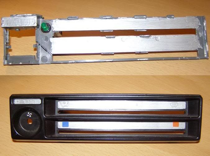

had a spare heater facia that had a blown bulb so pulled it to bits.
Got a mate to fit a new LED and I painted the grey plastic silver just to see what it looked like.
the paint is a bit (well, alot) rough but it was just a mess about really.
I'll stick it in tomorrow and see what it looks like.
