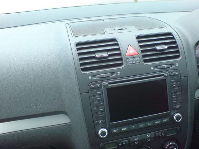

Placed the GPS antenna in a gap between the top air vent and the dash (where there is a bulge) and put everything back together.
any pictures mate of the above?
Is the antenna totally hidden under the top air vent or is it resting on the dash?
The picture below, taken from the Doc's Nokia guide, shows the location where I placed my antenna, see red arrow.  Once the air vents are removed, there is a hole where you can neatly slide the gps antenna into and out of view.
I have had no problems regarding loss of signal as there isn't any metal above it.  Once reassembled, the antenna is out of view. (My dash below)
Hope this helps.   :wink:
