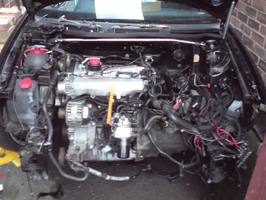

Another update, me and vdubben today replaced my whole aum engine loom for s3 APY loom and I am going for complete S3 APY management. The advantages of this are that I dont now have to go for a custom AUM map but also the AUm ecu's are prone to throw up more fault codes and to put it plainly the s3 management doesnt actually give a foobar, lol.
Spoke to BNB today and he has all the bits I need to get the car up and running; injectors, 3" maf, APY ecu and hitachi coilpacks. So im going to pick those bits up tomorrow and trade some my remapped ECU and other bits and get this beast running!
Got some pics il upload them when I get back to a pc with a dongle!
Posted: 09 June 2008 - 02:07 PM
right got the pictures, got the 3" maf, and 3 ecu's to try out, unfortunatly one of the ECU's was a BAM one and the other 2 were for AMK S3's (which are pre 2000). The problem with this is that my keys and clocks are 2001 and therefore we cannot add the Ecu so it'l run. We temporarily used an ARZ ECU to get the car started and running. Just need to pick up the hitachi coilpacks, APY ECU and 210 injectors and then she'l be driveable! Below are the pics:
S3 loom:
AUM loom out:
S3 loom going in:
Had to modify the wiring for the throttle body as the s3 ones are on the right hand side and the mk4 ones are on the left:
