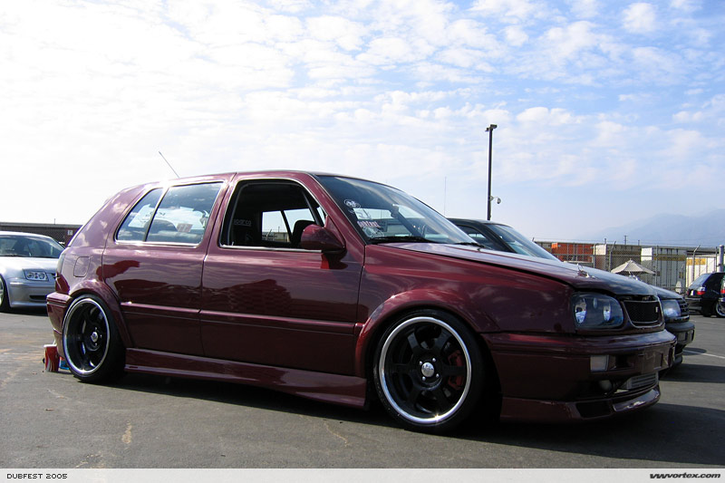

Just drill out the rivets from under the arch, and they just pull off.
On my last gti I literally just PULLED them all off, without removing the rivets lol - worked the same :laugh:
I'd say try and pull them from the arch by hand and look behind them, if you see anything that looks like rust etc leave them :wink:
Im really into the colourcoded look at the moment, if my arches werent removed id do this!

From what you say matt it seems like a simple job which is good to hear as i heard it could be a nightmare and yeah i once thought of doing the colour coded thing, the one shown looks pretty good. I'll check the metalwork before i take them right off (hope i dont find any rust or owt like shown on another post!! you lot would probably hear the screams)
