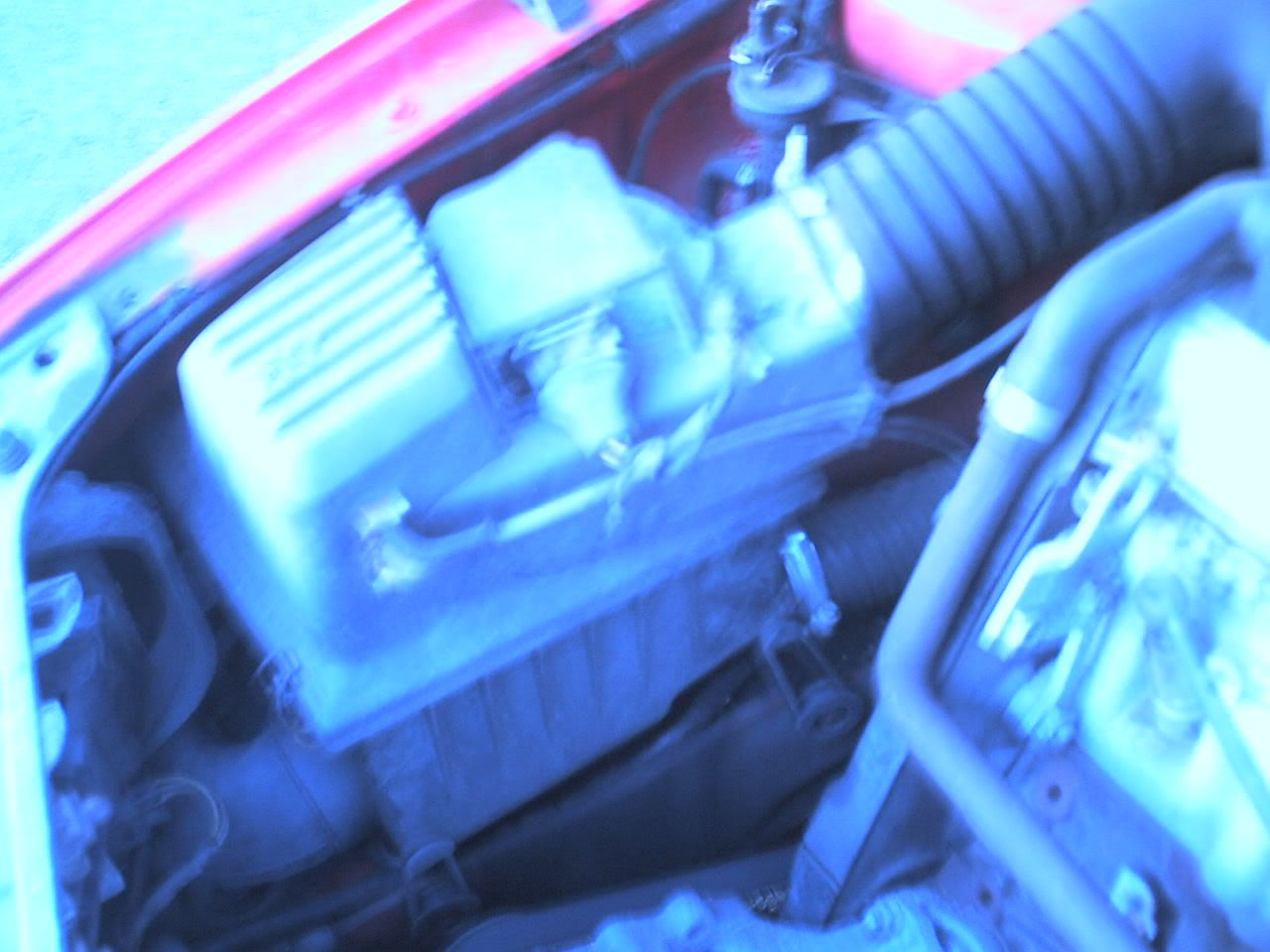

heard its a lot better than an induction kit, so... how many holes/what size and what part of airbox ? pic of box provided.... guidance appreciated. and would i need to change my filter to a kand n panel or is the original ok ?

it'll make it louder and let warm air form the bay in. dont do it.
replace the filter with a performance panel one and put 70mm ducting from the grille next to the horn.

Will work fine as long as you ONLY drill wing side and front of the box.

if your just after induction noise, go ahead. if you want more performance, drilling your airbox will make no difference whatsoever. if an enclosed  kit like a viper or similar only give a few bhp , a few little holes with no additional airflow to speak of would be worthless.

Drilling the airbox correctly and adding a performance panel filter will add a few extra bhp, so worth it for the money, stock air intakes are deliberately restrictive to reduce noise. However what people generally are unable to grasp is that such a mod will do more for the driveability of the car. Its not the overall gain the counts, its the fact that mid range torque will improve noticeably.
