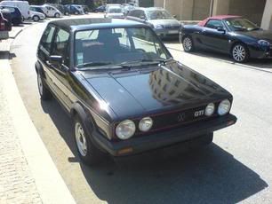

Hi,
I am a newbie from Portugal, and I have bought recently a Golf GTI Mk1
The car is all fine but compared to another MK1 GTI that I had a few years ago it lacks power!!!!..Also the fuel pump is quite noise and the car feels very nervous at idle!!!
It only has 80.000Kms on clock, and It previously belonged to a 82 year old gentleman.
Where should I look in order to get this fixed??
Here is a pic:

Check the timing and CO, plugs, leads ect. always a good place to start.
Nice looking motor :cool:

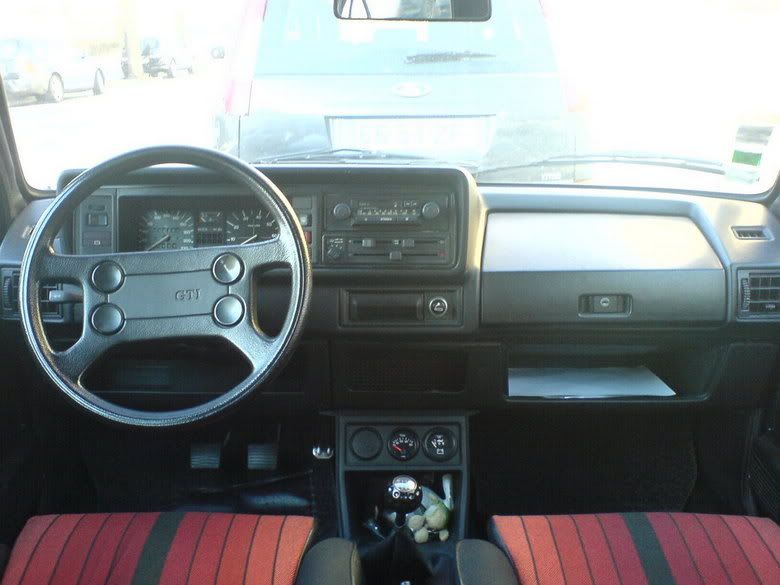

A few more photos:

Nice.  :cool: I say this loads, but I just love mk1s.  :grin:

ooo..that is sweet mate... :drool: i want one like that!!!
