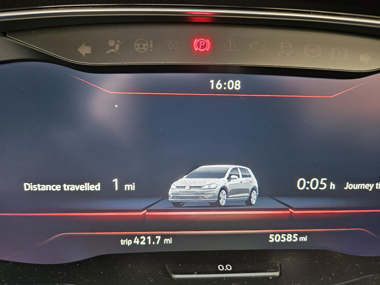

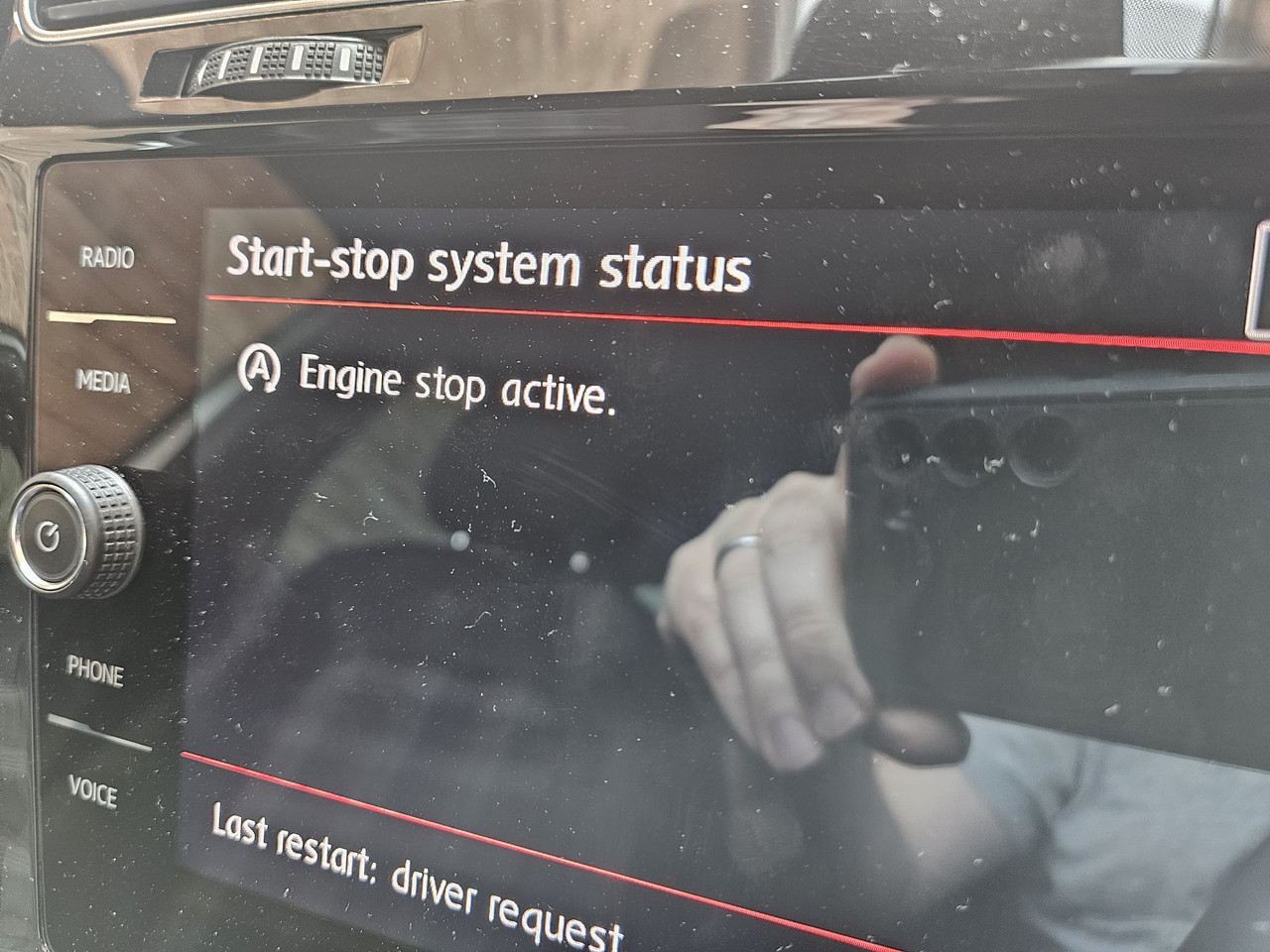

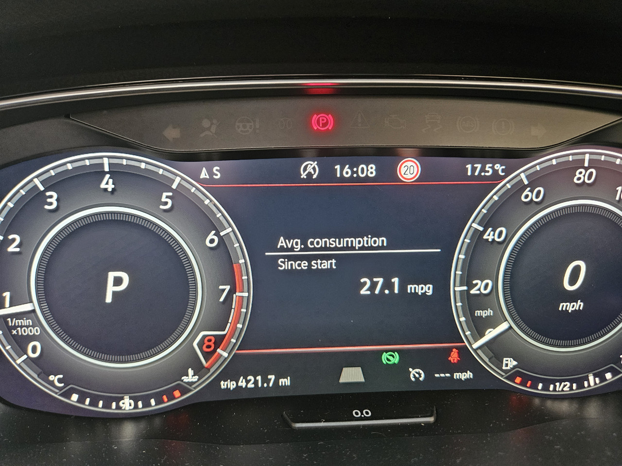

Just an update from me.
Had to take the car out to town last night to pick up a few things. Traffic was abysmal and I averaged 15mpg over 6 miles. Had a hot/burning smell again. The stop start worked once at the first set of lights and then dis-engaged whilst I was stopped and didn't re-engage again with the usual message appearing. Left it on charge for the rest of the evening once I got home.
Decided to go out for a drive this morning and test out the tips from @SRGTD. Let the oil temperature warm up to around 90 degrees and then let it rip on a few country lanes in sport mode. Whenever I would find a straight section with no cars behind me I would floor it to 60 and then switch to manual mode and drop it into 3rd or 4th gear and let the car slow to about 30. I did this a few times before joining a dual carriageway near mine with a bunch of roundabouts on it. I had a bit of fun gunning it up to speed and then before each roundabout I'd engine brake again until I had to intervene with the actual brakes. From the first stop on this journey I had the message saying about vehicle power consumption being too high on the stop/start screen. I finished the run at a local supermarket and was surprised to see I had an mpg of 30.8 for the 26 mile journey even after driving like I stole the thing compared to usual (Bear in mind I got 33mpg on a gentle motorway run using 7th gear last week). The stop/start message was still there which concerned me but when I got back to the car half an hour later the message was gone and it hasn't returned all day.
The drive home from the supermarket I have done many times in the last few weeks and the best I could muster was around 27mpg. This time I got 35 without even trying.
A few hours later I drove to my dads. He lives literally 1 mile away and it was a cold start on the engine this time. Previously I'd be lucky to see 18mpg and I managed 27 this time. The entire time stop/start has also been working.
I have to say that so far the advice about the GPF seems to have done the trick. I will keep an eye on it all over the coming days but fingers crossed the problem is solved.
It seems mad to me that the car does not make you aware of this issue at all with any messages telling you it is trying to do an active regen and as far as I can see it isn't mentioned in the manual either. Its also crazy just how much extra fuel it is burning to do it. I've basically dumped a ton of petrol the last 2 weeks that if I had known I could have avoided. It makes me wonder how many people are just driving round on short journeys with a GPF equipped GTI all the time burning a load of fuel because they have no idea the car is trying to regen, then on long journeys sticking the car in eco mode and not hitting 2k revs or doing any engine braking. A new owner might just assume this is a normal amount of fuel use and its only due to me having the mk7 that I thought something seemed off.
A few images below showing the message I am now getting and the last journey:
