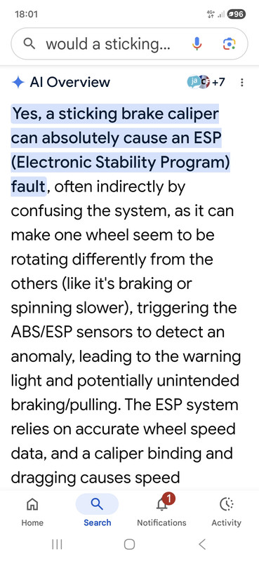

Then tonight I have the car with the squiggly lines lol come up and say esp fault, in the middle of traffic was great fun! The D on the auto was flashing and wouldnt let me move just rev. Didnt know what to do, turned off and on and I could move again.
Google says a sticky caliper could poss be the problem  to set this light etc off.

Ok ta, yeh "google" says wheel/speed sensor possibly
it would put the light on to show their was an abs sensor fault (ive replaced 3 of the 4 over time on my leon for this, using vcds fault tool to find which was faulty) but it wouldn't stop you moving. The warning light are often used to indicate quite a few different faults. I'm thinking maybe mecatronic dsg control unit issue. When was the last time the dsg oil was changed?

Does say possible transmission fluid low too. Praying its a sensor for now lol

Abs lights went off as drove to work today, but when I left to come home they came on as started car then went off, then felt the car slightly juddering then the abs and steering wheel light came back on and once that came back on it drove normal again.
When googled it, it said .....again..... abs / wheel sensor and the judders could be the abs trying to activate .
