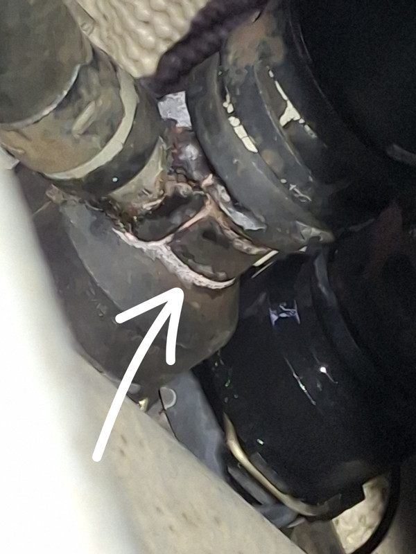

Thanks for your reply nino as always! Great info 👌👌😁
The garage couldn't get me in till.6th Jan understandably around this time lol..
But drove past work today to see our mechanic and to show him where the garage said was leaking on heater pipe, our mechanic literally touched the connector very softly and the "nipple" literally fell off and he said well id say thats where your leak is from (and a high spot as u were talking about)
So I was like sh!t, but hes very experienced and an hour later after having a think and taking the top.hose off he tap and dyed  the connector and put an aluminium part in and reconnected so, sorted, whilst he was doing that I did order a brand new one only £13 but he did say tbh the metal part prob stronger than another plastic part 😆 🤣...
We let it kept up to temperature etc and seemed no leak at all will keep an eye on next few days obviously.

The only tiny thing is where that drip was on the other pic I sent on auxiliary pump, that broken heater part, surely couldnt/wouldnt have made its way to that point !?! Haha
Which is why possibly (aswell as yesterday's fix) could be those 2 coolant pipes that wrap around front of the engine too. 😁

Right..lol... just gave car a clean and once over, thought would stare at connector for a few mins
..and it was leaking about every 1-2 mins..
The part fixed yesterday seems fine I have took 2 pics and put arrows lol... I think the actual part is knackered maybe a ti y crack in it or something not that we really checked it last night,  as was dripping from the top part... looked like where I have "arrowed" so maybe good job I ordered a whole new part lol

Very good work! I would say you have found it too.

Only thing I thought was if the connector wasnt on 100%and the drip came from there and fell off on that area but not sure

If was coming from red arrow area surely would drop off at lowest point  blue arrow,  but its dripping from green arrow of the plastic connector ... so hopefully a new 1 sorts it :rolleyes:
