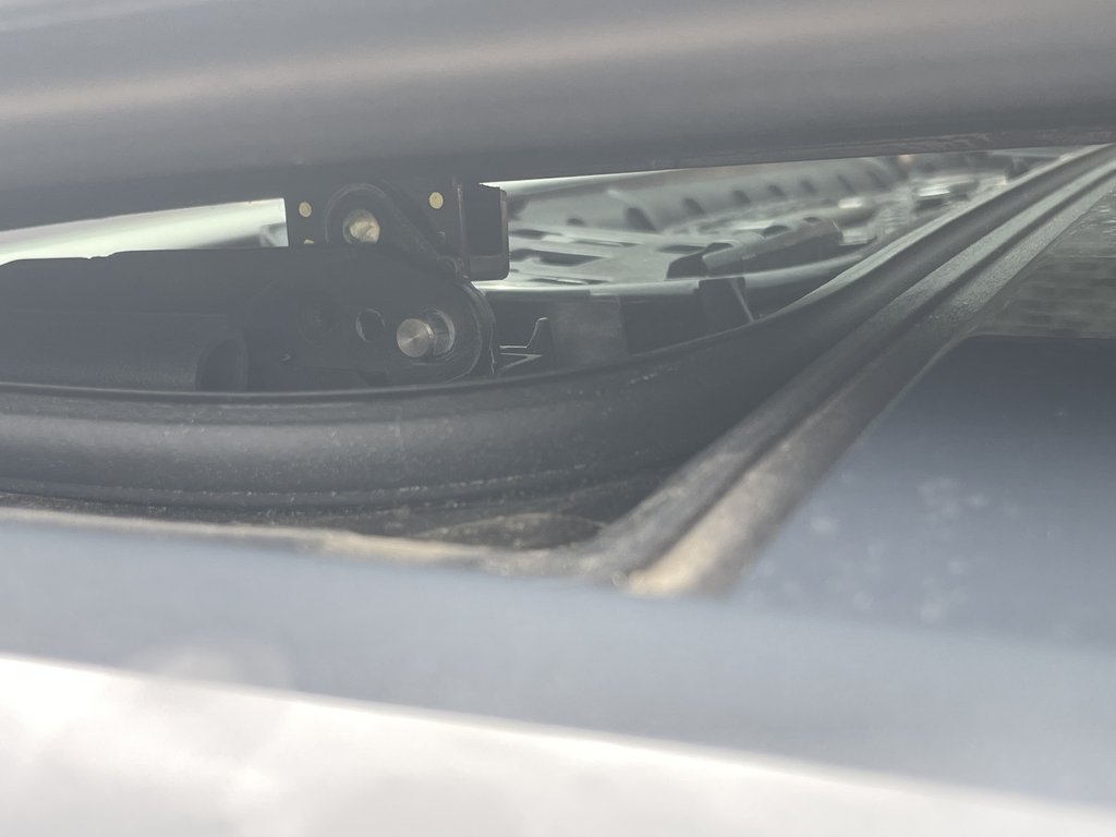

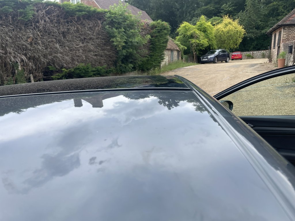

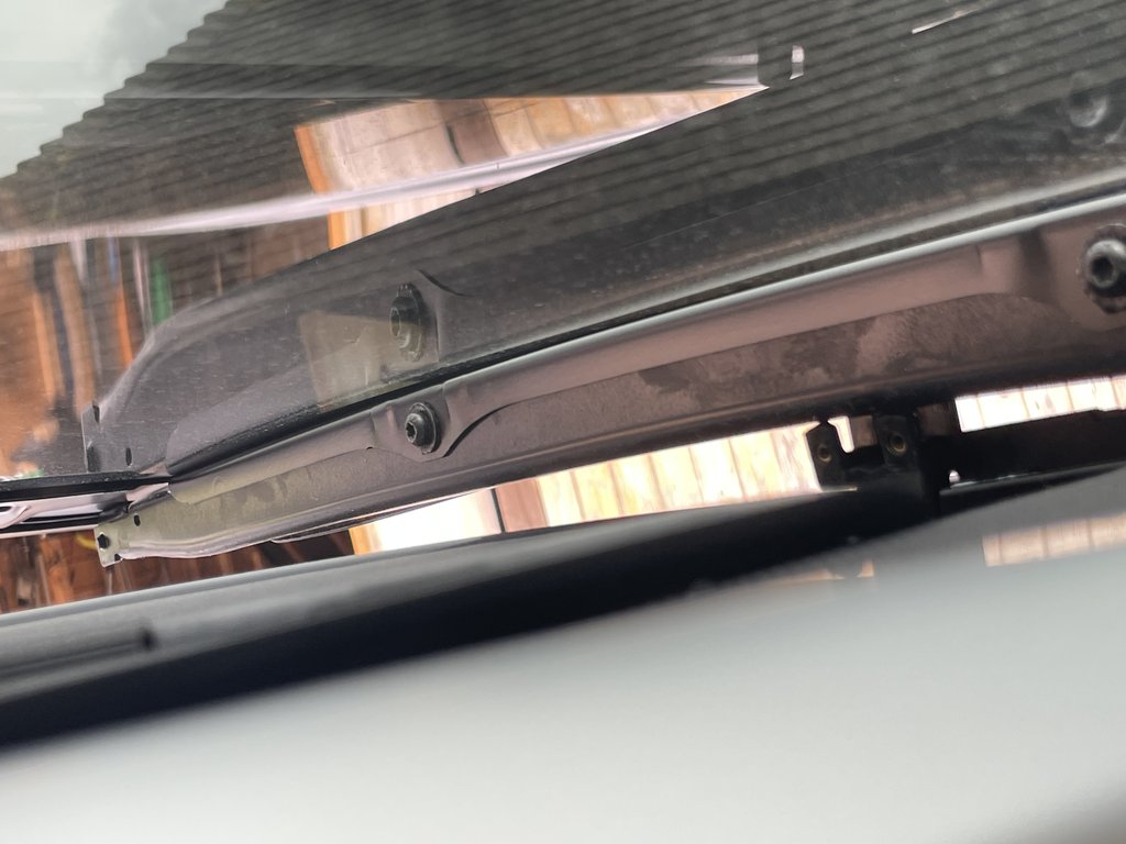

I was reversing my car into the garage with the roof open, and a part of the door mechanism (barn style two side opening doors) got caught underneath the glass and BANG - I’ve managed to break something and pull the glass roof out of the tracks and it’s twisted. The glass itself is not visibly damaged. I found a broken bit of plastic from don’t know where and the guides/runners may be bent. On one side the glass slides forward and back a bit, but not on the other.
I’ve been looking for a guide/instructions for how it should look / how to remove the glass to see if I can do anything to get it all back in place but no luck. Does anyone have any manuals/guides?
It seems different from mk7 but I assume it would have the same general principles of some sort of frame being bonded to the glass and that frame then being attached to the runners/mechanism. There are some star/torque headed screws that look tempting to try if I can get to them but don’t want to do it blind if I can help it.

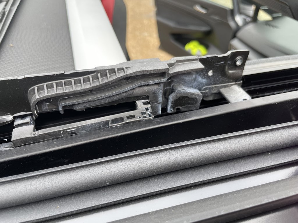

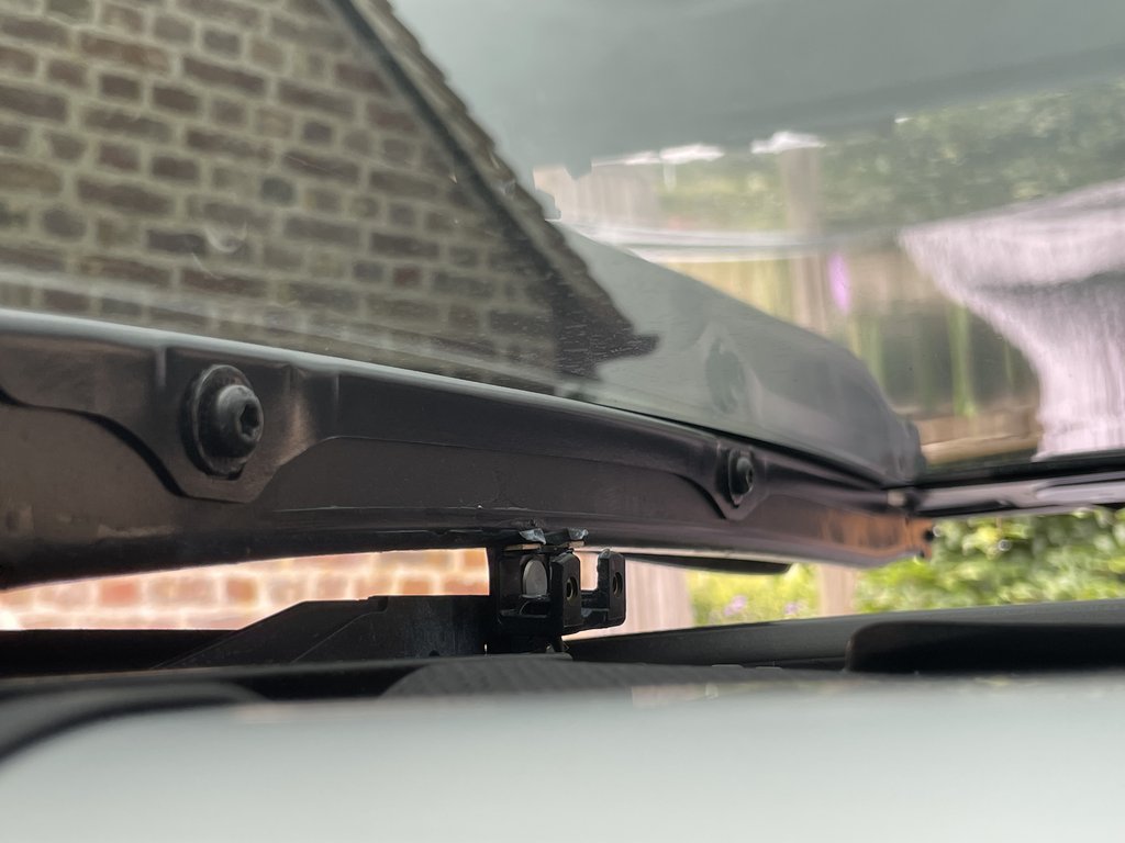

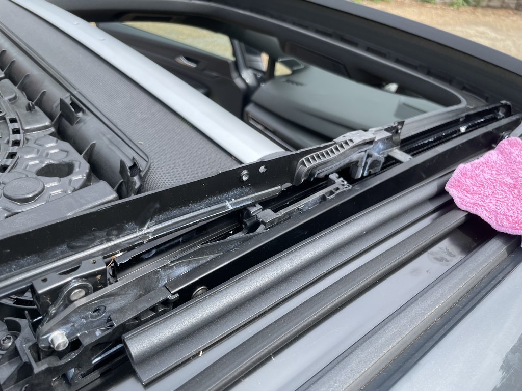

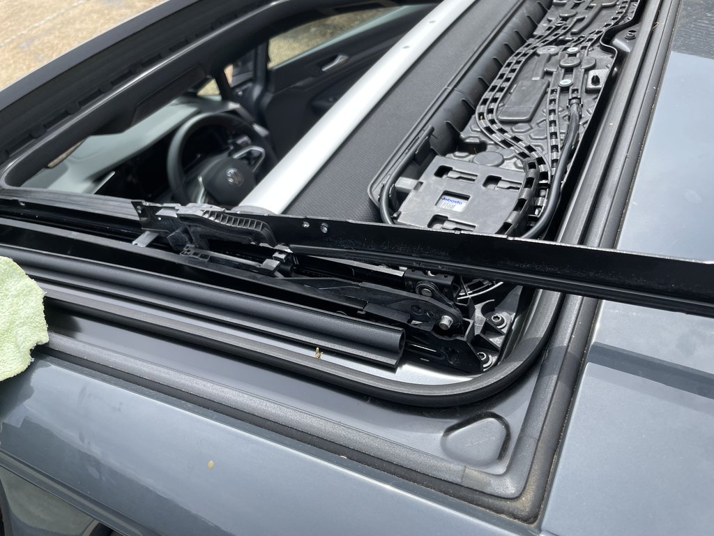

Update:
- managed to remove the glass panel. Had to do without re activating the motor so was a bit tricky. Four torx screws each side

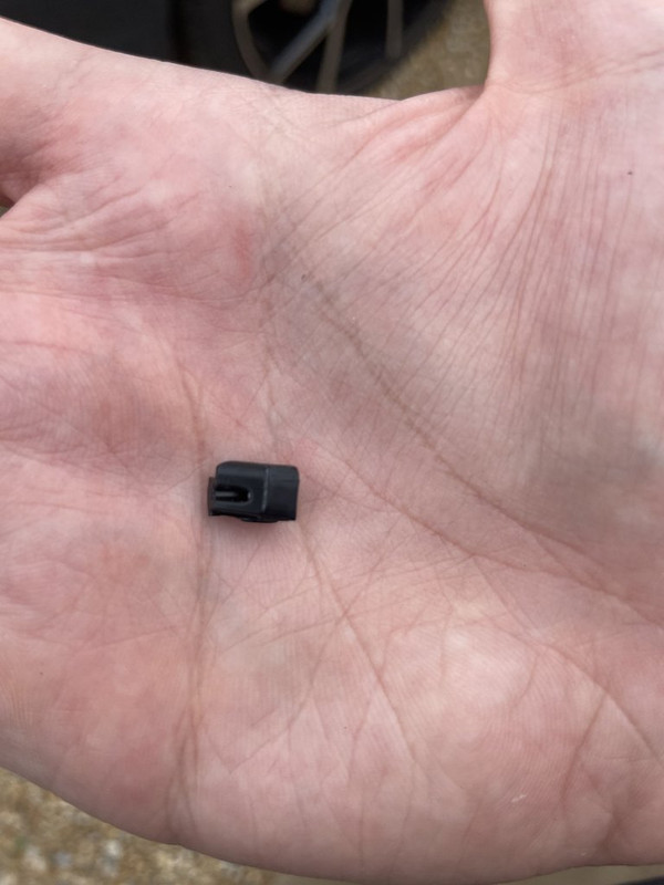

- found two bits of broken plastic, one either side, can’t work out where from
- once the glass was off was able to inspect the runners/track

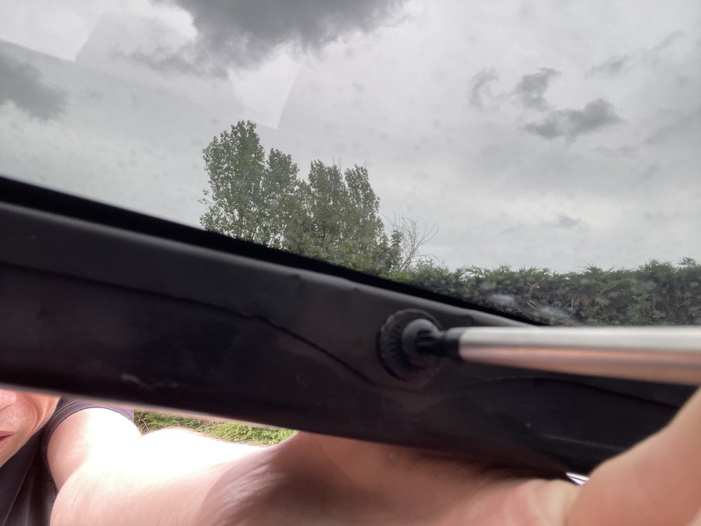

- the drivers side had lifted off / out of position and both sides come out the guides
- drivers side rear guide is cracked/bent
- with a bit of force managed to get it back in place both sides
- re attached the glass at front and back points (couldn’t access the two middle ones anymore in its position)
- moment of truth 1… activated the mechanism back to tilt position - it worked
- then able to do centre points
- moment of truth 2…. Put into close position… some odd noises but worked.

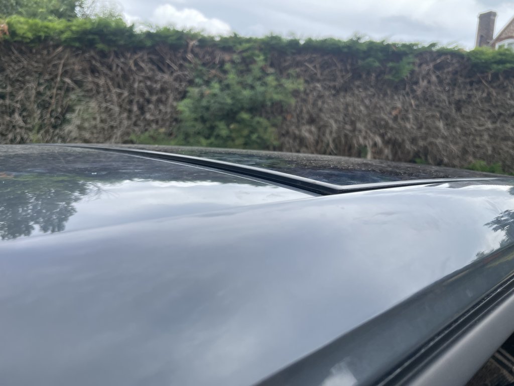

- however drivers side rear massively out of alignment, other points seem ok
- readjusted drivers side screws as best as possible, however best can get it is still out of alignment, presumably due to something being bent
- although looking at original marks where screws were it was already using most of the alignment space, so wasn’t a lot of adjustment space left
Have left it for now as at least it’s closed, seems to open and close ok. Will reflect and see if want to try to completely detach again and see if something can be bent/pushed back
Plus there are the two left over / presumably broken bits of plastic
