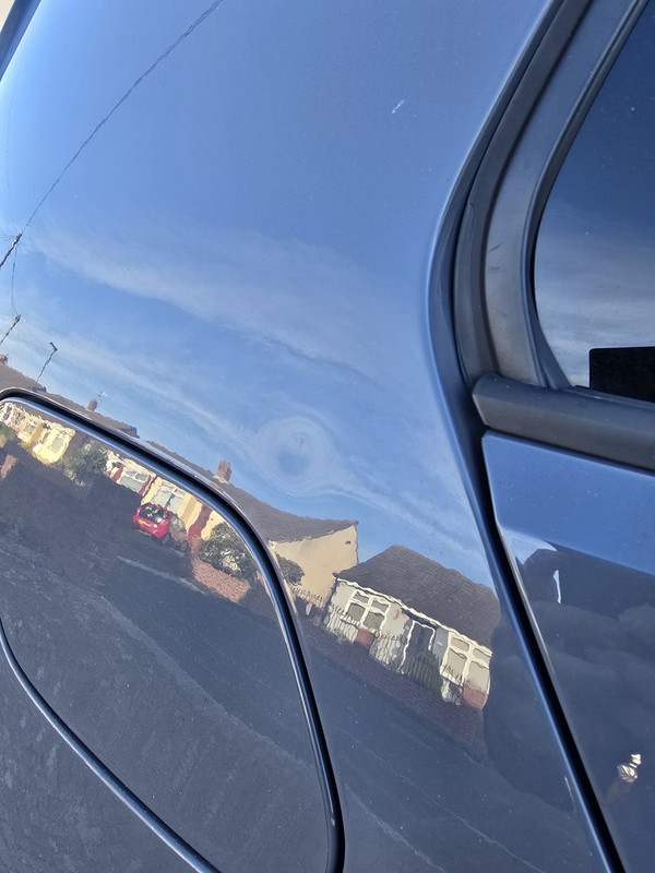

So, a seagull has dropped a fat ball from a great height and dented the side of quarter panel above the fuel filler cap. Does anyone know the best access point? Up through wheel arch? Dent guy coming tomorrow so just looking for best access. It could be hot glue pulled but as I've got PPF I would probably need to get that replaced (this will be last resort)

Ouch, sorry to see that. Might get better and easier access by removing the fuel filler flap and the rubber insert which come out together.
You beat me to it @Watts :smiley:.
Found this video on YouTube - the video is of a mk7 Estate, but I dare say the area behind the rubber insert will be similar on both the hatch and the estate.
https://www.youtube.com/watch?v=0B9625upU_I
Excellent, cheers for the video. Wasn't exactly sure if that bit came out but cheers. I'm guessing you can leave the flap on without I clipping it and still remove the rubber surround?
Yes, very quick and easy.
