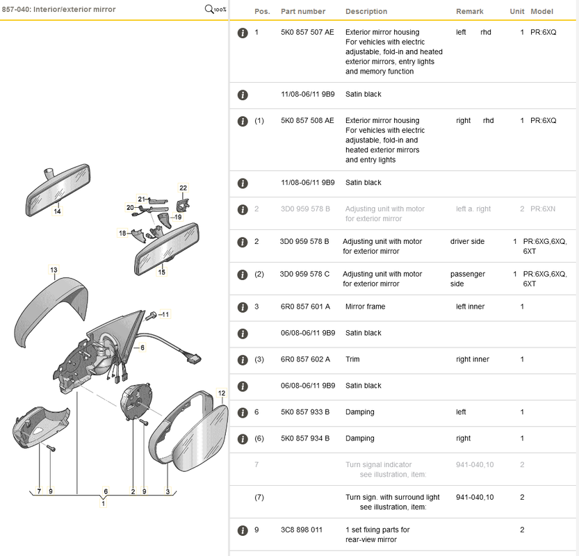

Offline Bluto
  • Posts: 126
Re: Folding mirrors retro fit - Questions
« Reply #8 on: 26 October 2023, 18:43 »
Checked mine:
Drivers: 5K0 959 701 B
Passenger: 5K0 959 702 B
I wonder what the difference between ours is.  :huh:
Hi Nino:
Well as the C and B generally refer to revisions, there may be some minor differences.
Having had a quick look on Partslink24.com with my car's VIN number.  5K0 959 701 J and 5K0 959 702 J look to be the latest compatible Window regulator motors for my car. Guessing the J is the latest revision of that motor.  Which I'm assuming must have some kind of module on it, as VCDS scanned it.
The Window regulator motor's control module may be the unit that sends the signal to control the door wing mirrors on key press.  Though I'd actually expect that to come from the car's Body Control Module (BCM).  Not a mechanic, so not sure.
Not sure if you're already aware, but one note of caution regarding module part numbers is that modules can have index codes that aren't shown on the original module sticker.  Point in case is when I upgraded my car to LED rear tail lights I needed a new BCM. The dealer quoted me part number 1K0 937 087 E Z1Z, not just 1K0 937 087 E.  So somthing to bear in mind when purchasing used modules.
In terms of part number of the wing mirrors themselves. I don't believe they have modules in them, so don't think VCDS will be able to pull part numbers.  So without some dissassembly I doubt I can get that for you.
But I'd suggest maybe going looking at Partslink24 with your VIN to see what Wing mirror parts are available.  You can get one hour's access for about £13.
The complete housings compatible with my car are currently listed as :
  • 5K0 857 507 AE
  • Exterior mirror housing
    For vehicles with electric
    adjustable, fold-in and heated
    exterior mirrors, entry lights
    and memory function
  • Left
  • RHD
 and
  • 5K0 857 508 AE
    heated exterior mirrors
    and entry lights
  • Right
  • RHD
My assumption as to why the left-hand mirror has a memory function and the right-hand one doesn't could be the dip passenger mirror on reverse feature.
Cheers
Bluto
« Last Edit: 26 October 2023, 18:57 by Bluto »
