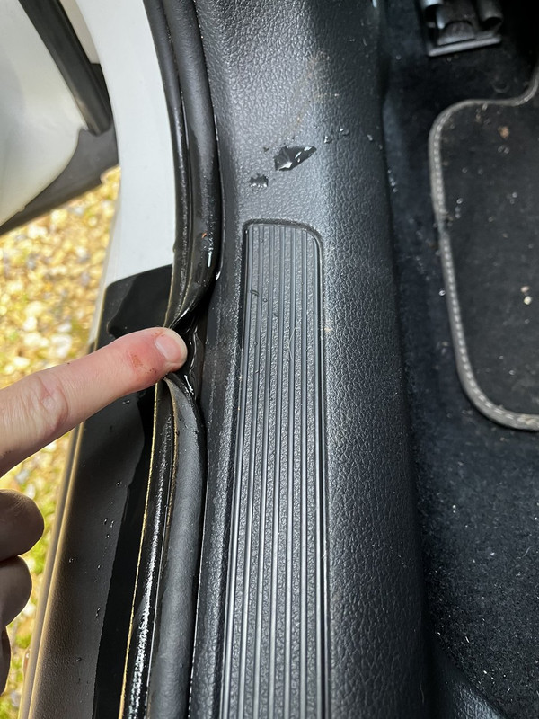

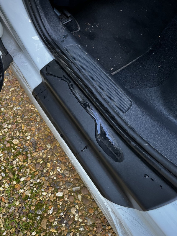

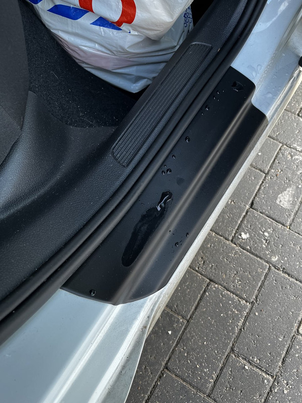

I have an issue whereby water is building up on the rear door sills of my 2017 R. The offside is much worse than the driver side. I’m presuming it’s the common problem of the speaker seal but just wanted to check before attempting to resolve the issue.
Any thoughts?
If so I was going to follow this video to fix https://youtu.be/pDLqcbRtlGc
