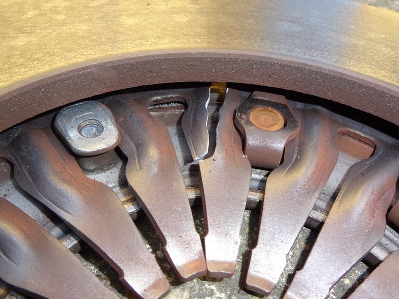

I have just been outside. I cannot see any leaks anywhere and the fluid level hasn't dropped.
A couple of years ago this happened to the clutch on my Mrs' Alfa. It was an LUK/Valeo and was fitted than 3 years and 18000 miles  previously.
