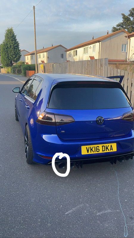

The exhaust almost sounds like something is rattling (when it isn’t moving or when I pull away in first gear to second then it sort of goes away that or I cant hear it due to how loud the car is naturally) like a coin when you have the must really loud in the doorwell? I have looked and the passenger rear side the exhaust tip to the right is the one playing up most or sound is coming from there? Ive attached a picture to show which one I mean as rubbish at explaining as you can tell!

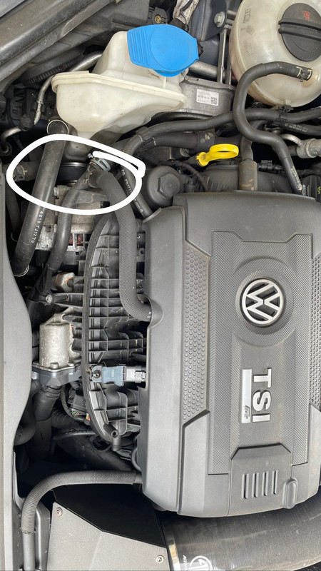

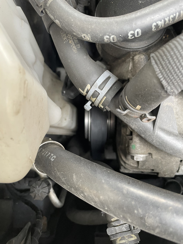

Looked at the engine today and I swear I have a rubber cambelt not a chain? My reg is vk16dka and its done 54000 miles so slightly concerned.

That's not a standard exhaust so perhaps it has been fitted badly and is rattling on the bodywork. Why not get it checked over by a garage? Could be as simple as a bracket needing adjustment.

I'll take a picture when I'm on lunch and see if its me being a tit

It definitely has a cam chain, not a belt. I assume thats the serpentine belt you are looking at.

That's the serpentine (fan) belt, the timing chain is housed under the cam covers nexty to your yellow dipstick

 :laugh: :laugh: I so knew that!!! I am so used to having a cambelt and now have extra money to use now as I saved - what a t**t I am!
