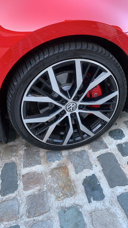

Can I just check I'm looking at the right new tyre....
Mine state Pirelli 225/35/R19 88Y - is this a p zero tyre?  It doesn't state p zero on the tyre wall though
They should state P Zero on them usually opposite side to the tyre specification, in my old ones case 1/3 turn counter clockwise, see below:
