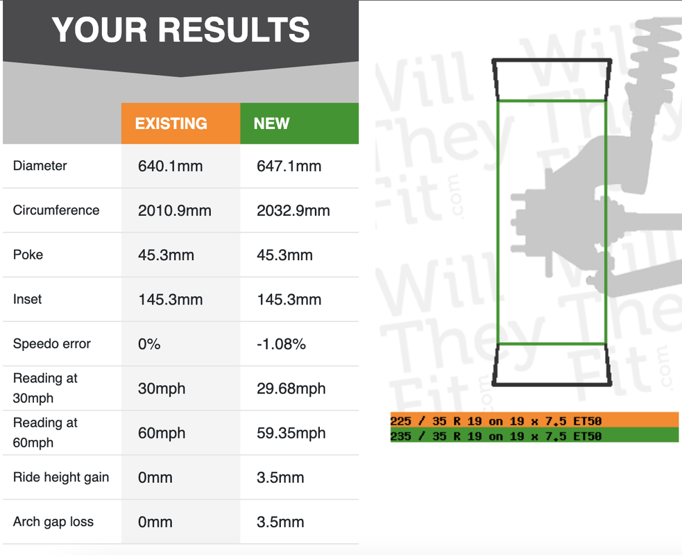

Question is has anyone put 235/35 on this rim ?
I ask because the 235 are alot cheaper than 225?
Tyre place said it would work but might affect the speedo reading.
What's everyone's thought? Should I do it or stick with original size 225/35 and pay more?

The speed reading will be changed slightly. The 35 figure is the % of the width of the tyre that is the height so the wider tyre will have higher sidewalls so lower speed reading by about 4%. Can't comment on any other factor of handling etc.

Your speedo will be effected by 1.08%

I've done it, mainly to protect the rims a bit better, and because I like the looks.
Looks real good and I've noticed no real difference in any other way.
Spedo is ever so slightly off (spedo =69, GPS =70) compared with waze\gps but it wasn't 100% before anyway.
