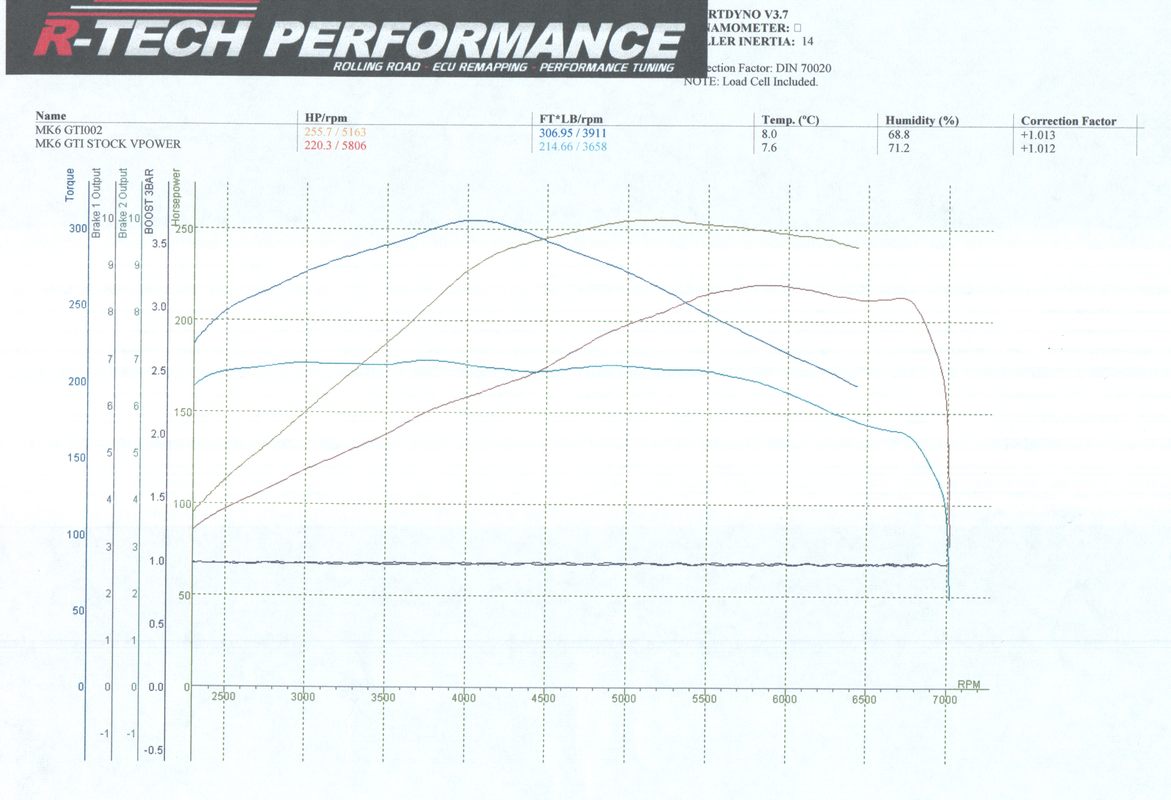

I had mine done in 2016 with R-Tech, see below for the graph.  My standard BHP was measured at 220 on Shell V Power, this was boosted to 255.
However, if you are getting this done, upgrade your coil packs at the same time, I had one fail the very next day.
The other "downside" so to speak is that I now have to fill up only with Tesco Momentum or Shell V Power fuel.  I was told that filling up with standard 95 fuel would hurt the engine.
