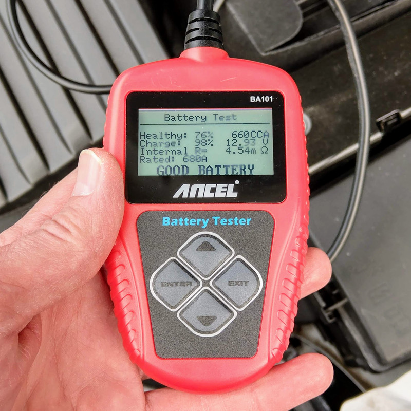

Just checked my battery again and it seems to be holding up quite well for nearly 5 years old and considering how many people have battery issues with these cars.

Those readings look good particularly the voltage. Had the car been standing for a couple of hours prior to the check? Can make quite a difference to readings if just run.
Been standing about an hour after the last run, looks like it might last a while yet though.
So the best time to test the battery and get a good reading is after it's been standing for a few hours?

Best off checking when been stood for a while to let all the systems power down fully and enter there "sleep" state.
There can be a few systems which can remain active for a while hence giving you a false reading.

Well now I’m even more confused :grin:. My stop/start rarely works but my battery voltage says 14V on my OBDeleven after cars been sat for 24h

14v is a high reading for a battery that has been idle for 24 hours, A 12v battery should show 12.5-12.8v under normal circumstances.
A 14v reading is what you would expect to see with the engine running and a healthy alternator is charging the battery.
I would try another battery to see if it makes a difference.
Or try your Obdeleven in another car to see what reading you get for a different idle battery.
