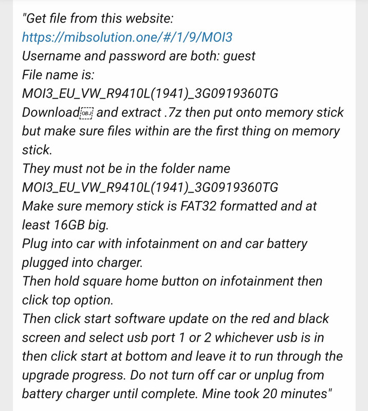

That's good news. May I ask, where can I find the instructions?
Thanks

Still no issues to report after updating 1941. I'm happy with it. Only thing to note is the graphic of my blue Clubsport has changed to a silver GTI lol which makes sense, as the software image obviously wasn't made specific to my car..
Except for the performance, and the interior & exterior styling, I don't think there's actually any differences between the GTI and CS is there? Nothing the infotainment unit should have any impact on anyway? Mine's all stock, excl paint.
