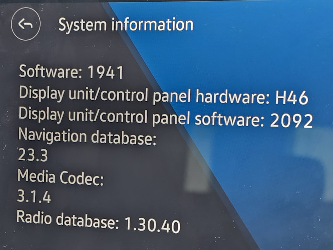

Just to follow-up on the above, I've now also successfully updated my software manually to 1941. TBC if it actually proves to be beneficial  :grin:

It's hardly a definitive conclusion, but I've had a few short trips post the update and nothing annoying to report. No restarts, bings, bongs, warnings of any type. The whole UI feels faster and more responsive too. Probably the fastest I've seen it boot up when I first went out.

Updated manually to 1941 after following the instructions.
Updated successfully.
So far, great. It would usually light up like a Xmas tree when reversing and steering was on full lock.
Tried it a few times, and not a single error message.
Not sure about the responsiveness of the screen being quicker, I wouldn't say I noticed anything different there. But then again, I never really noticed the responsiveness as being an issue in the past.
But, so far so good.
