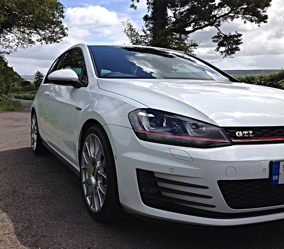

Here's mine on a set of 19" BBS SR (19x8.5 ET46) these are fitted with 235/35 R19 Goodyear Eagle F1's…
Apologies for the link but I need to look up posting photos again, not done it in a while lol - also, don't know the in's and out's of using other people's pictures by that site, as they're mine, but not really bothered...
https://autotk.com/tuning/volkswagen/gti/16088/
Personally I think the tyres look just right - I agree that 225/35 might look too stretched on a 8.5" rim, although you'll gain a little clearance.
For reference, I have Eibach sportline springs fitted and have had to do the fender screw mod. It's not rubbed once since I did it though.
Oh, and if the CI-R has the same mounting system as the SR, then BBS will warn you against using any type of spacer with them. The spigot ring is metal with a circlip holding it in, which means it's spaced back from the mounting face by enough to make some spacers lose the centering ability on the hub.
Also, - edit no. 2 - the 8.5" wheels are ET45 according to the BBS website, should fit fine with 235 tyres.
yeah i would go 235's on an 8.5J, but 225 on an 8J.
didn't know about this info ref spacers??? so can't have them no? i know a certain car had the CI-R's on 8.5 ET45 and ran 12.5mm spacers on each corner.
Now i'm unsure lol
