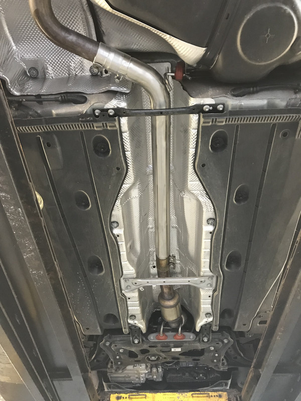

Mine has one and I got it start of June 2018 but reckon it was built quite a bit before that.
Here's the GPF (the larger section just before the clamps where it goes to the engine and cat)
« Last Edit: 28 October 2019, 16:55 by Jim_mk7.5 »

I thought the GPF was right after the turbo? That pic above being the cat.
I’ve a March ‘18 245PP with very sooty pipes, I really must have a good look under it.
If you've got sooty pipes then you don't have a GPF.
I'm fairly sure it was pointed out to me that the larger round section you can see is the GPF then the cat is further up towards the engine. I might be wrong though.
