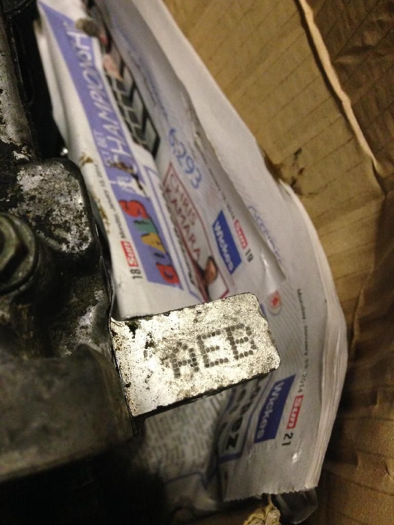

Small port just wasnt going to cut it, So I found an AEB the other side of the country.

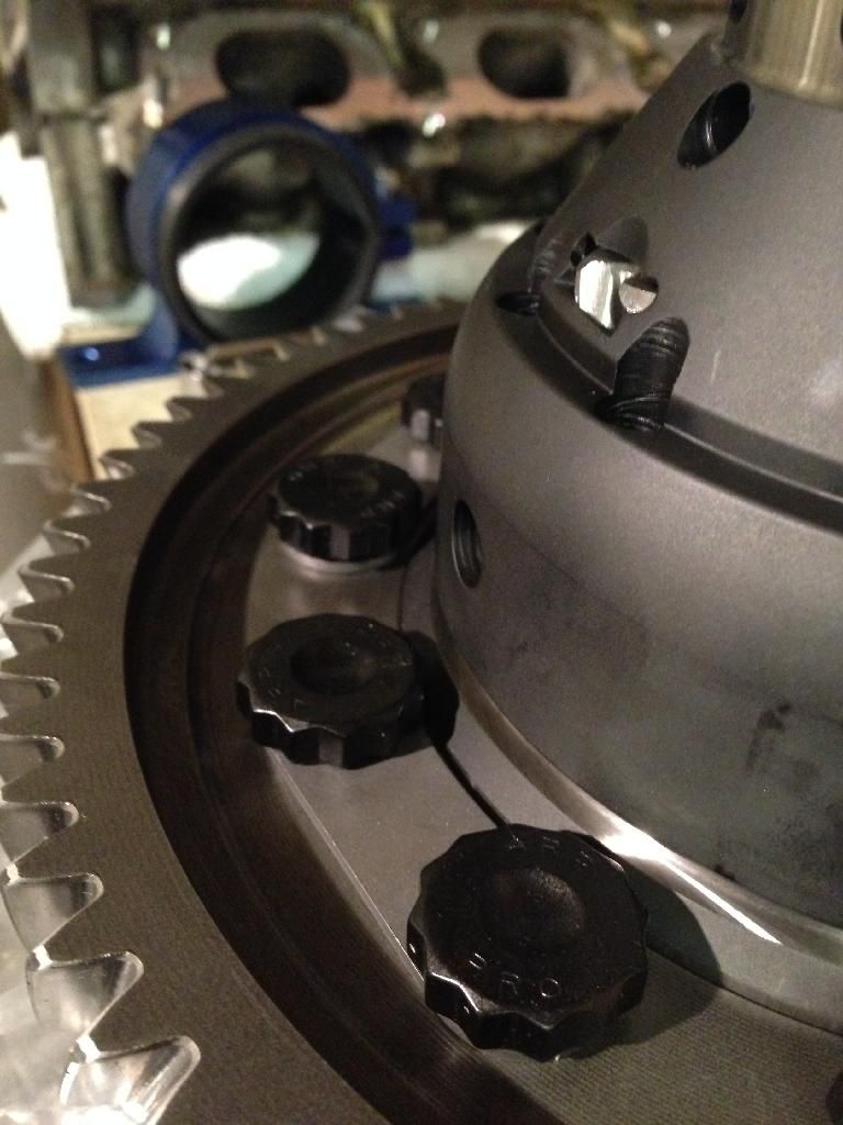

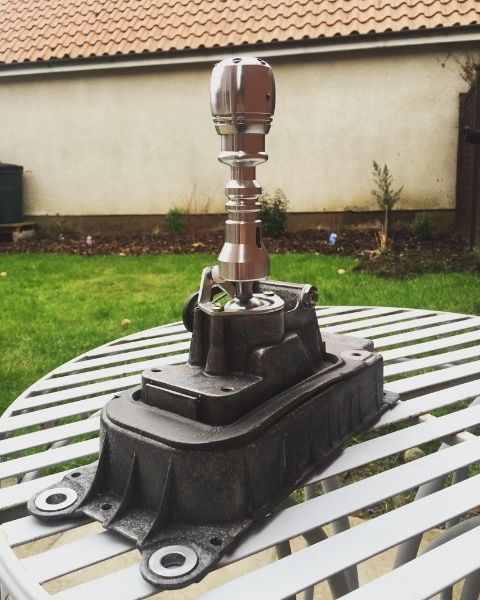

Strippin' the box.

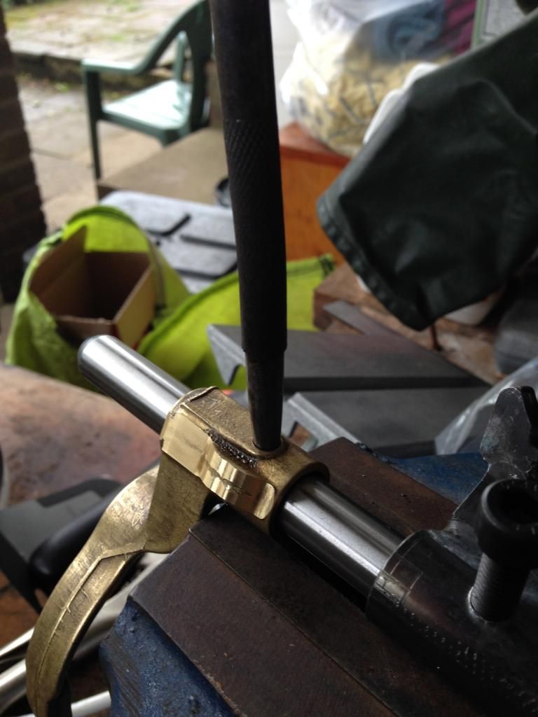

Forks are a huge issue on the 02m's so we will deal with that issue but first, Time to get drillin'

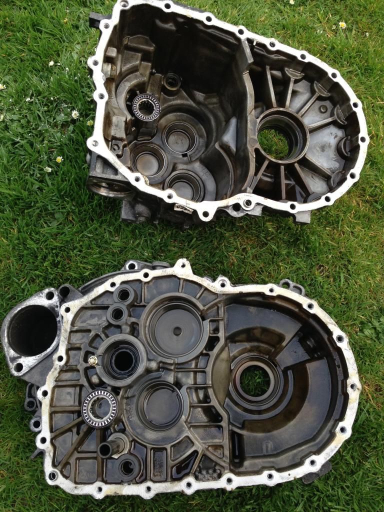

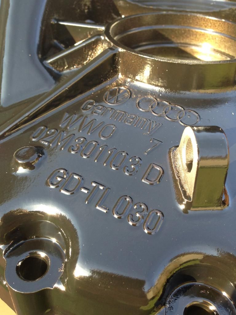

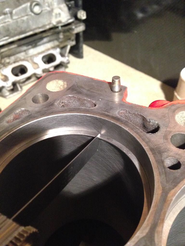

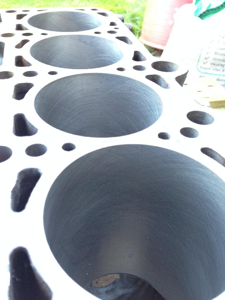

Time to get the cases rebuilt:
Again, Stripped blasted and painted:
Pegging the crank:

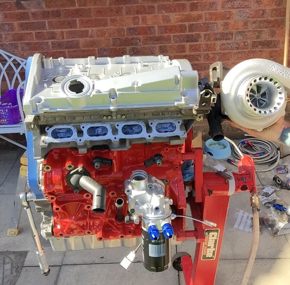

Head on, and other little bits and bobs:
The snail arrived from USA amongst a small arrival of other parts:

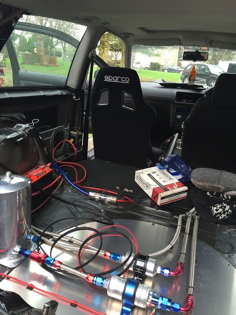

Trial fitting the fuel system...
Hell on earth figuring out all the wiring ( making my own loom for just about everything, including entire loom for fuel system to link to new ecu )

Thanks for the kind words guys. Its a precision 62mm Billet CEA for now until I get to the stage of mapping, then I can plan the future direction of the project. Kind of wishing I stuck with the VRT build, as I am still undecided in which direction I will be going nect year (4mo full control vs Rwd fun runner)
