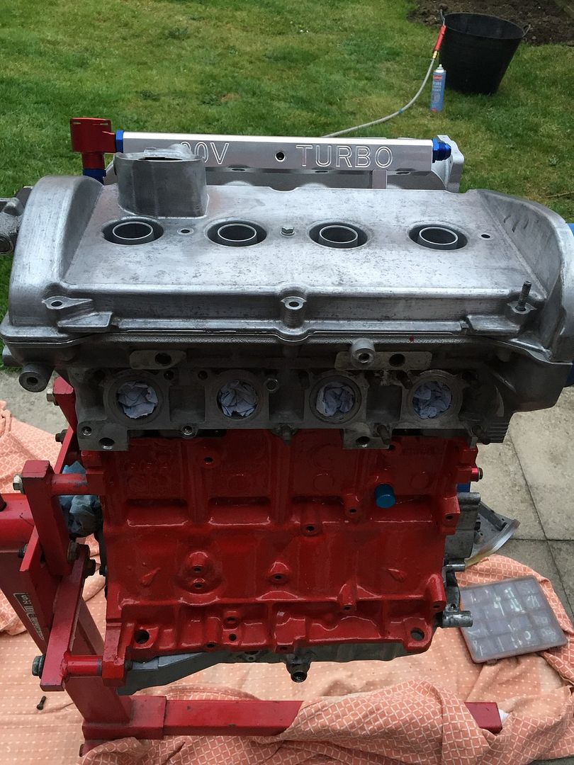

So yesterday turned out pretty nice weather wise to decided to pull the motor out the garage and get some work done, Needed to clean up the gated baffled sump and get the 'New' flat rocker cover cleaned up.
Engine out and stripped back down:
Sump off:
I had an itch after installing the sump and got a message from Bill @ Badger5 about an item I wanted to grab from him.. So a quick run to Stonehouse and ran the "package" back...:
But what is it....?

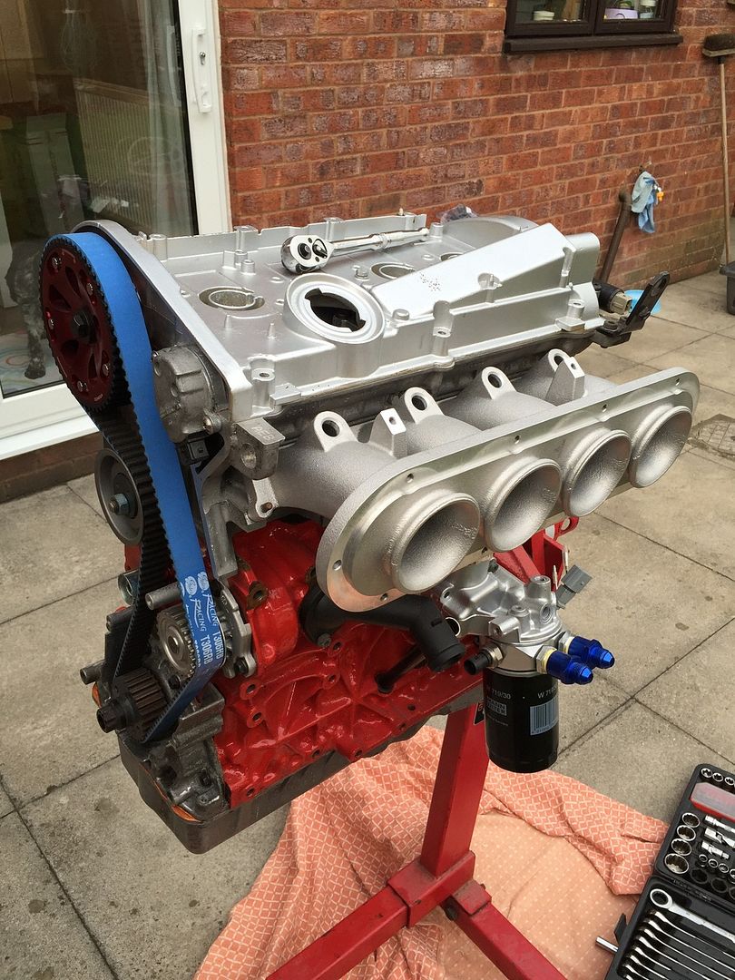

Again, Outstanding quality from IE, This things huge.. Will get more detailed photos next weekend.
Installed on motor:
Had to chuck on the flat rocker for a mock up, huge difference aesthetically speaking, happy with how flat it is now, just to get it coated:

Rocker took me over a year to find one, was a hell of a search! Flow is improved in every area possible. Stock flows directly at cyl 2 and seem to choke up early on the flow charts, actual air flow and velocity on stock is all over the shop too.. IE focuses more on the actual equal intake of each cylinder receiving the same amount of air flow per cycle. Hard to explain but check out the pic attached:

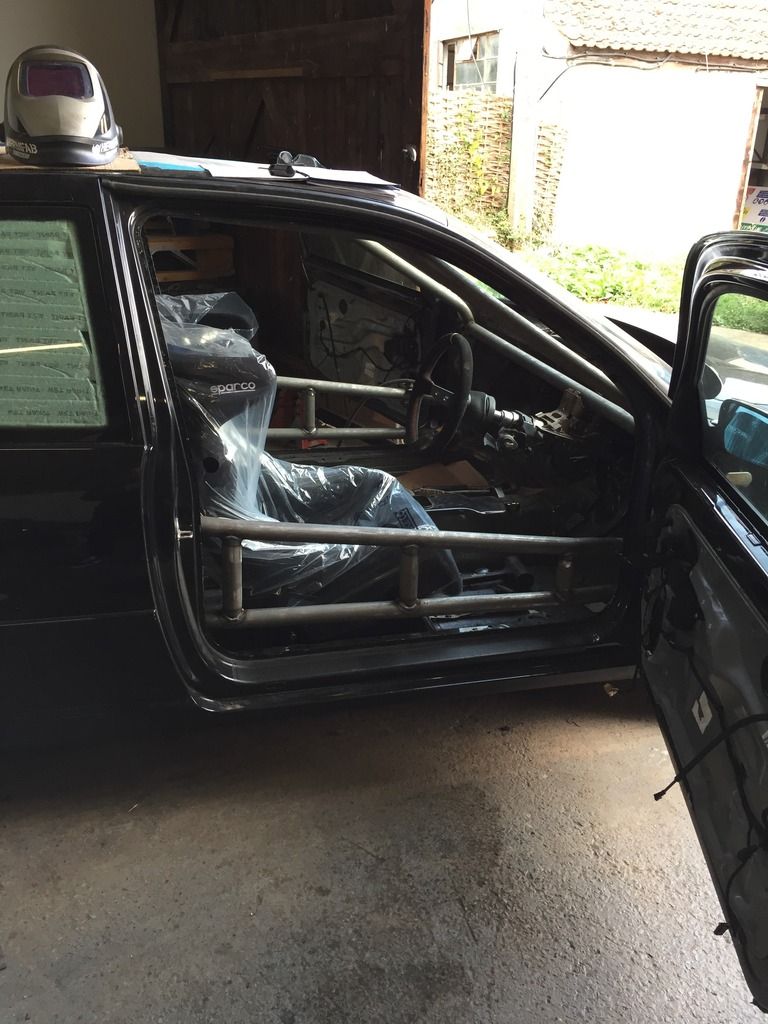

Car has been stripped to nothing now, looms all gone (no pics, apologies!) So started on fabrication of the cage amongst other items (pics to follow)

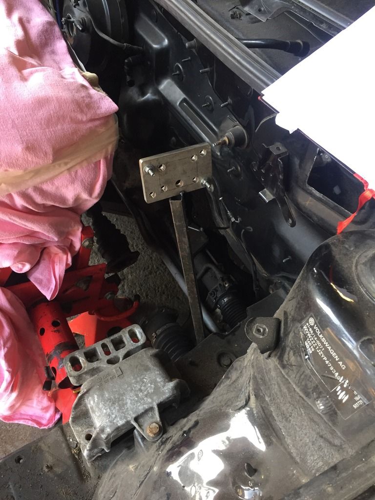

The stock shifter not only looked cack, but also had so much play and throw, so decided it was time:

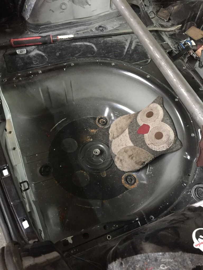

So this week I decided to spend a week with a good friend of mine, Herm to get some much needed work on the Golf done. Work has taken a full stop and Ive taken a weeks holiday to smash out as much as possible.
So we started with the rear end.. No puns intended.. (AGAIN, sincere apologies for crappy pics, Really dont have time to keep bringing the DSLR in just to get wrecked in the workshop)
Ignore the owl... Inside joke
Bum clenching was in full force:
Mocked up and swaged to strengthen:

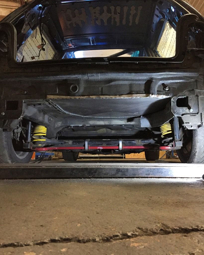

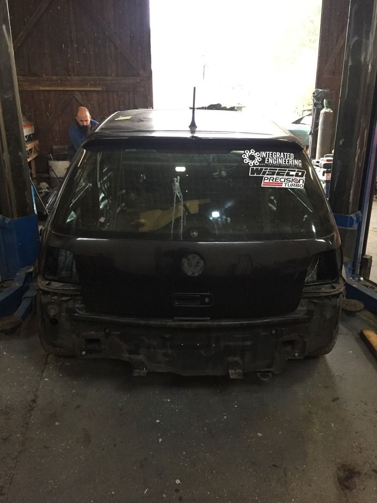

Also, did not manage to get any pics of the process, but end result of rear wheel well delete & fuel tank removal:

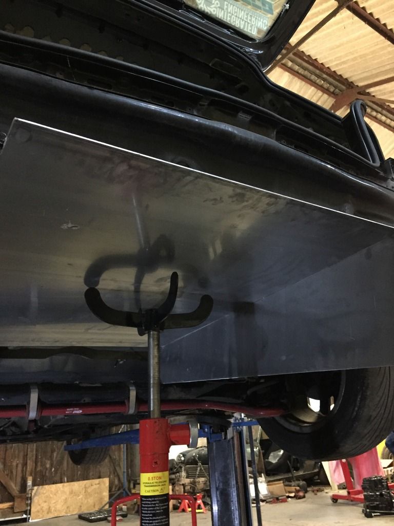

But whats all this effort for... Teaser of half the item fabricated:
Back to the grind again. Needed some more strength in the chassis, so decided to swage. After all, everyone needs a good gusset in their life.... :eyebrows
End result? 2 gussets per side, A pillar downstays and main hoop to chassis:

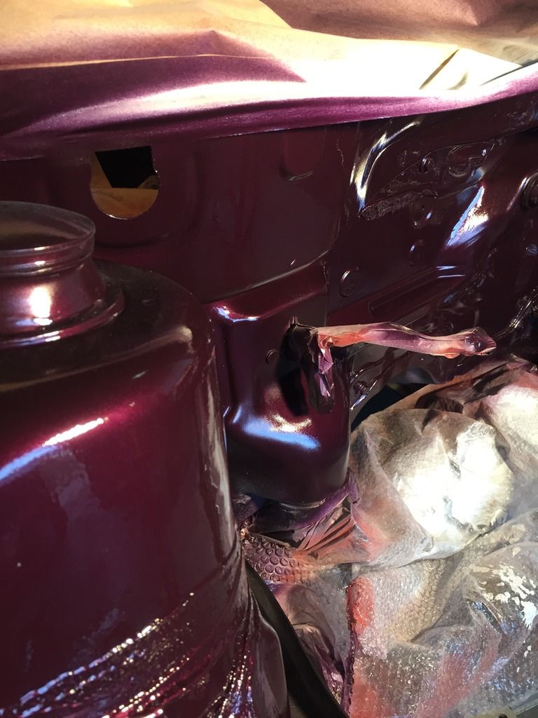

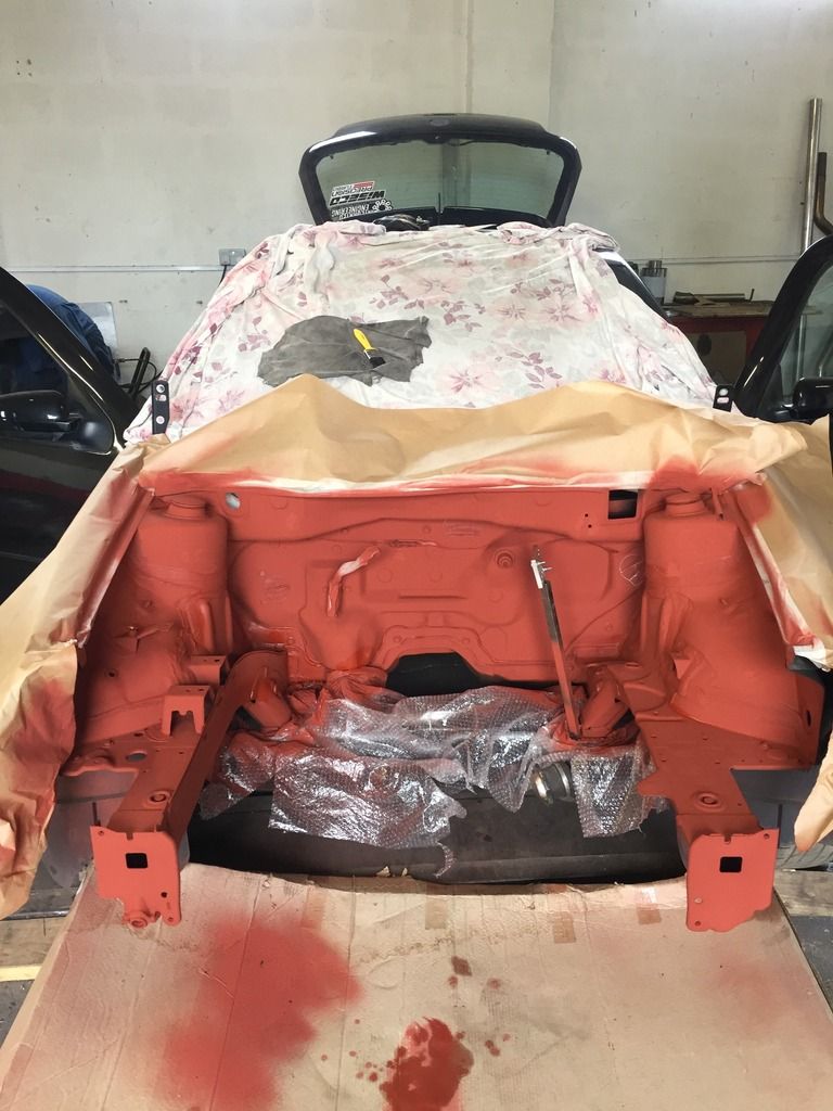

Got started on the Fugly engine bay, cut all tangs and unnecessary parts out the way, fillered and flatted back:
Cleaned down and tack ragged. Spot the wizard...
Smashed on the red oxide thick (1.6 tip HVLP)
Stuck on a white base ( In the all ideal world I would have laid a silver basecoat, but didnt have any to hand so stuck with what we had )

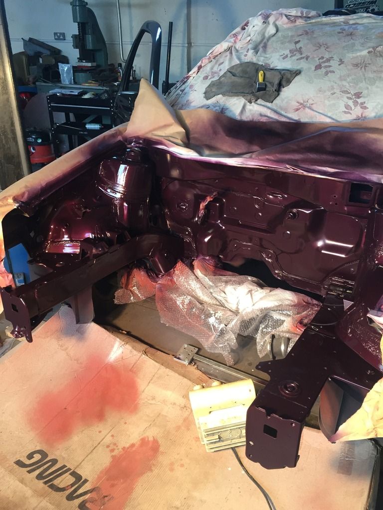

Mixing up some colour, wanted something different for this, So used some left over from a few years back. Just hanging around for this very occasion...
Then laid the laquer on WET, wet wet wet... End result?
Pictures are shockingly bad quality as per, Iphone is almost dead due to going through 7 screens and constant dropping, until the DSLR is repaired, I cant get any decent pics...
