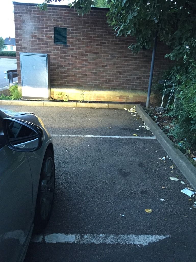

STEP 1: Find a flat car park with a wall. With bricks is best and road lines to gauge.
STEP 2: Place the car a couple of car lengths away and rest the back rear wheel centre on the line.
STEP 4: Turn your headlights on, pop the bonnet up and grab your allen key, think it was a 6mm and camera
STEP 5: Take a photo of the back of your car & one of the light beamed against the wall

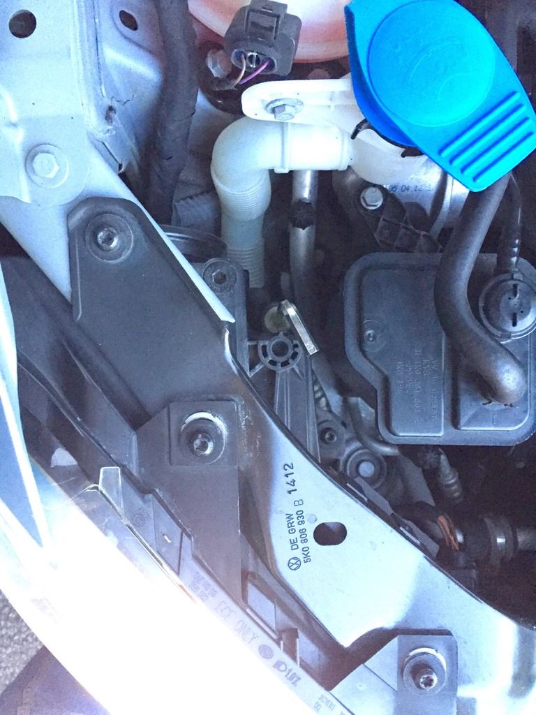

Under the hood, got to your headlamp, you will see to allen key type plastic bolt heads as adjustment points.
The white one is the up and down, the other is left and right so avoid.
Put your alley in the hole, at a time give. (mine is 17.00 hours). Take a photo for future ref.
STEP 7: Turn the key anti clockwise to raise the beam. Count the exact number of rotations and stop at the same time. I did 3. It's more than you expect. (Clockwise drops the beam).
